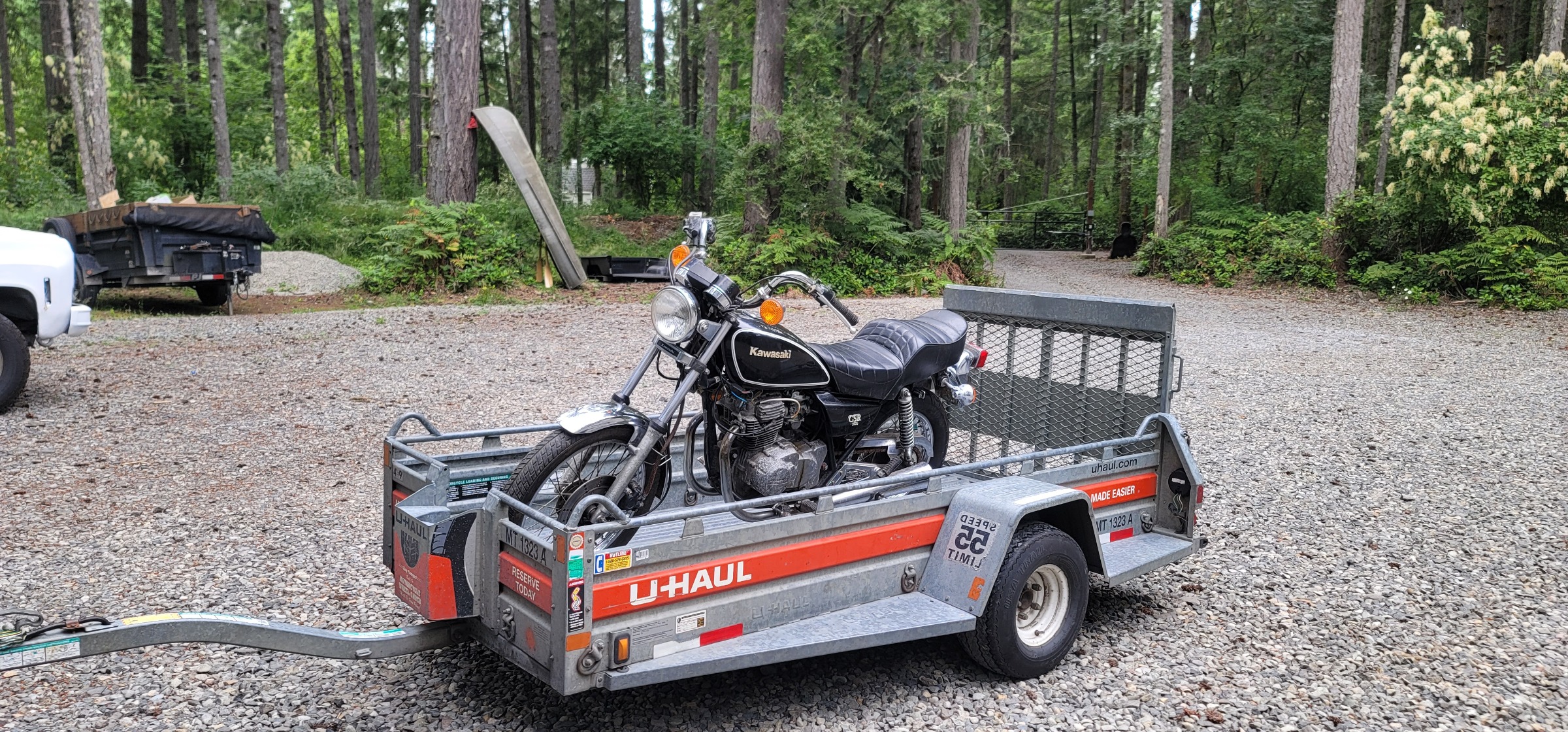

Hello! Looking for some advise, I picked up this 81 kz305 csr a couple weeks ago. It's my first bike and I don't know much about motorcycles. I do have experience with wrenching on cars though. Anyway I can get the bike to crank but it won't start. Tried grounding the plugs to see if they were getting spark and nothing. Looks like the coils had been replaced at some point also. So I'm looking to see if anyone can point me in the right direction. Also anyone know of a good master cylinder replacement mine is toast. Pic for attention
