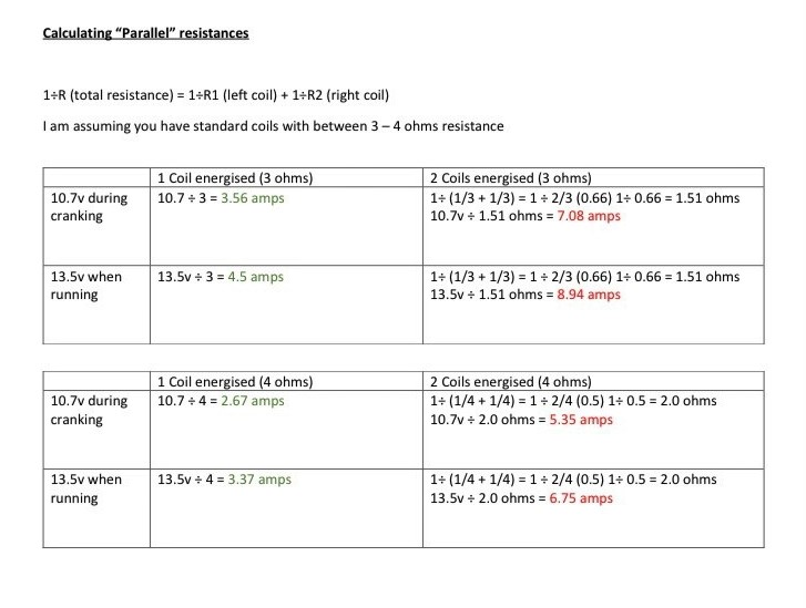

Hi 577, the below calculation formula should help you get your numbers (between 10 & 13 amps dependent on voltage for the coils) If you are exceeding the circuit capacity why not add a stand alone 20amp supply to the coils and dyna through a by-pass relay ? Just out of interest what is the output of the stock charging system ( if you are running in excess of. 20 amps you must be getting close to it's output max

Yup...did the math with 2.2ohm coils at 13.5volts is 12.26amps for just the coils, with the lights and computer....yup...too much.

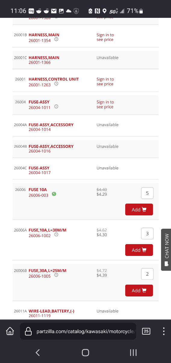

You're probably fine but check the insulation along the main fuse wire(white wire) to make sure it didn't melt.
And I'm not sure of your exact model of bike, as it's not in your signature, but some of those 1100's came with 30amp main fuses instead of 20 amp. Double check your owner's manual.
I looked back in your posts and found that you have an 81 GPz. Partzilla list the main fuse as a 30amp for a 81 GPz1100 B1.

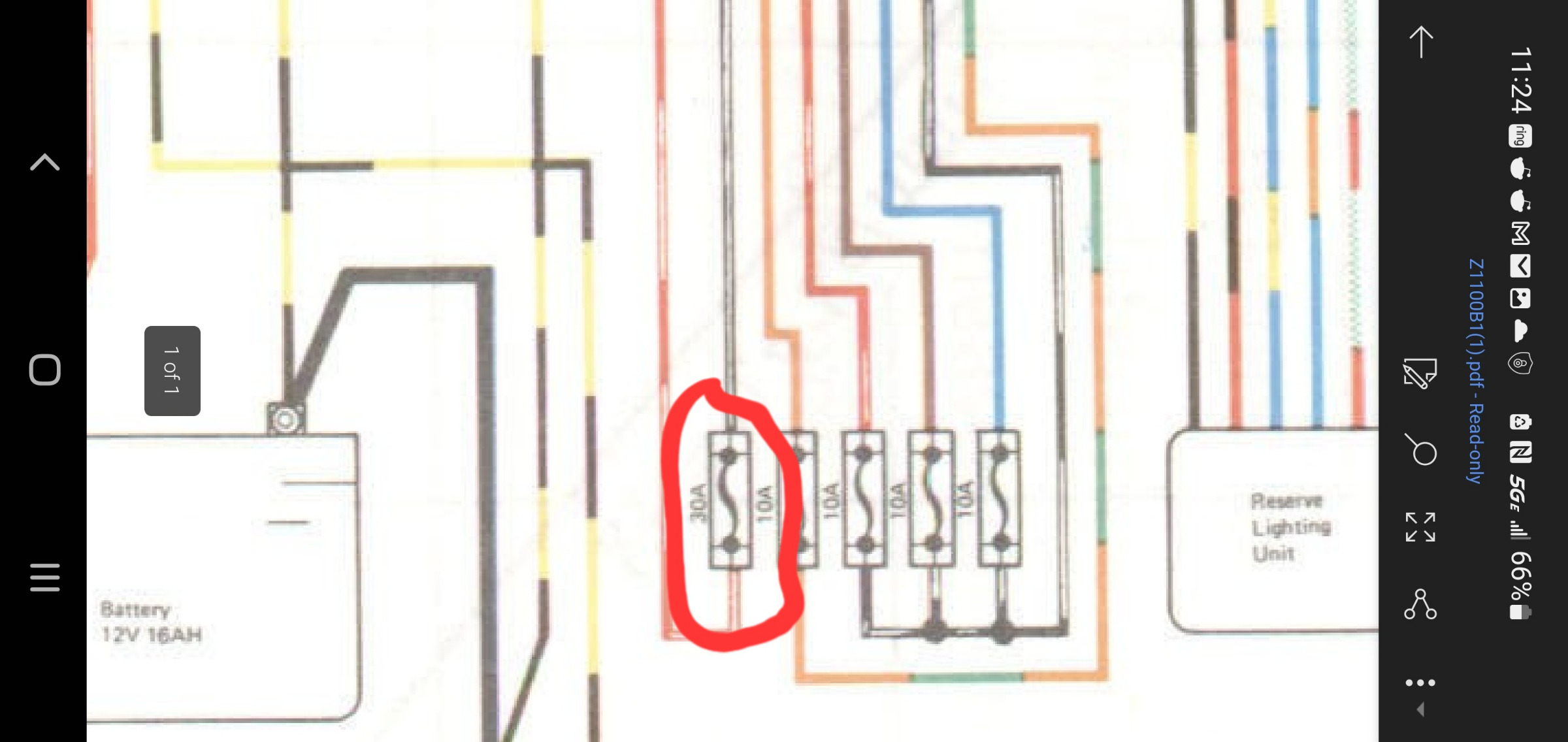

Ok. Hold on here. What GPz1100 do you have? It is the 81, 82, or 83-85?
In any case, all of the 81-85 GPz1100 wiring diagrams do show a 30A main fuse. But the manuals also show that the OE coils have a primary resistance of 1.8 to 2.8 ohms, which is pretty much what I'd expect the Dyna 2.2 ohm coils to measure. These coils do not use any ballast resistors. Also, the 1981 model has a secondary fuse that feeds these two ~2.2 ohm coils using a 10A fuse. This 10A fuse is shared with both the coils and tail light circuit.

If you can confirm that your bike was original equipped with a 30A main fuse, I would put the 30A in. But I would also look very hard for any wiring faults or faulty devices that could be drawing excessive current.
