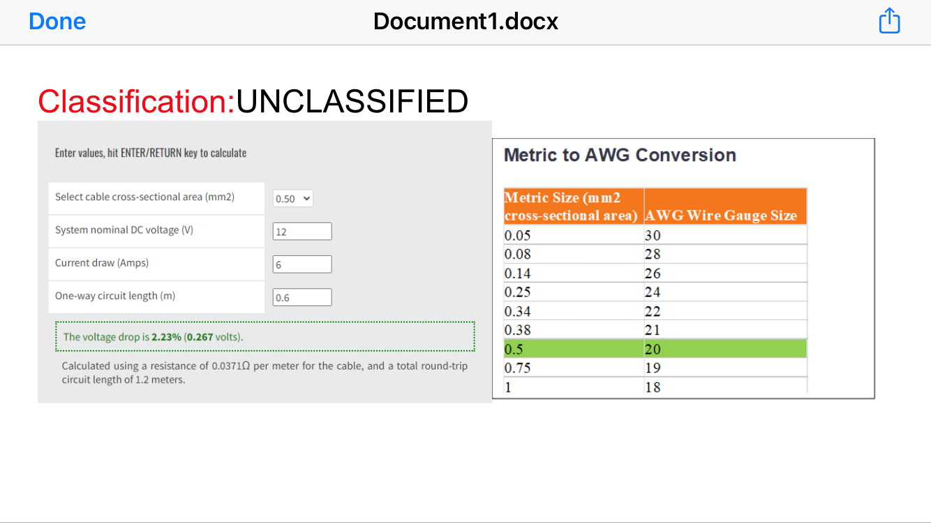

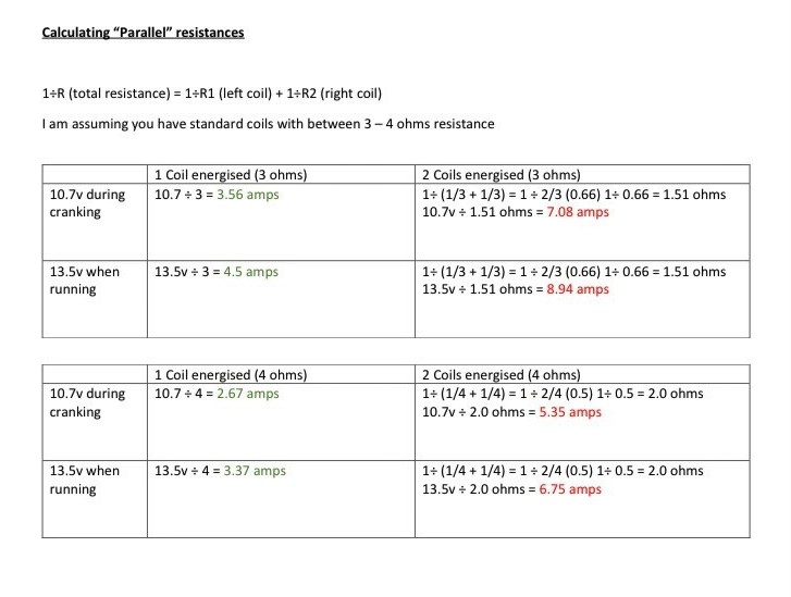

Ok so you have fallen in a classic trap and sent yourself down a rabbit hole
the way a fuse works is that when a current greater than it's rating is passed through it starts to heat up then blows (during the heating process the resistance increases) by using a 5 amp fuse you have built your own fault into the equation. Calculating parallel resistances involves a formula so I have put the calculations below, as you can see at any point when both coils are energised you are exceeding the current rating of the fuse (significantly when the voltage is higher with the engine running which is why you have a greater volt drop with the engine running due to the higher current draw and heat build up)
As a rule of thumb to calculate a fuse rating you should take the maximum current flow, add 10% then select the first available fuse greater than that value. In this case
8.94 amps + 10% = 9.83 amps so you would select a 10 amp fuse as a minimum (I would recommend a 15 amp fuse in this case to allow for spikes if this wasn't a temp set up)
