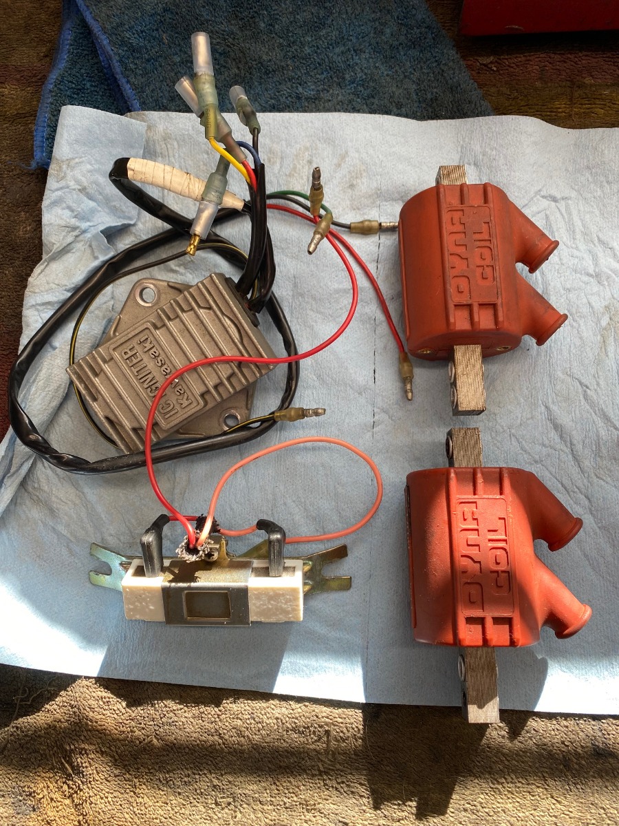

It's been a couple of years since I changed my coils, so I'd forgotten that I changed out the originals at some point earlier and installed a set of Dyna coils. They are the brown ones...measure 1.7 ohm on the primary and 12.65 k ohm on the secondary. You will need to attach your wiring to these coils, as I used the wiring for my new ones.
I also have the bridging resister and the igniter but I'm not sure how reliable the igniter might be. My decision to switch was because I had an intermittent connection in either the igniter or the pickup. But I'll send it to you and let you decide if you want it. I'll also send a set of silicon plug wires that you can plug into the coils for your sparkplugs. One end on one of the wires is off, so you will have to cut it to the correct length and attach the coil plug with a set of pliers. I went to the PO today and bought a small prepaid box. It cost me $20. What I would like is for you to donate $40 to KZRiders and don't worry about my cost. I'll treat it like I donated $20 and you donated $20 so KZRiders comes out the winner in all this. I have no further need for the coils so I'm glad someone will get some use out of them. PM me with your address and I'll mail the box on Monday. Photo of the stuff is below.
