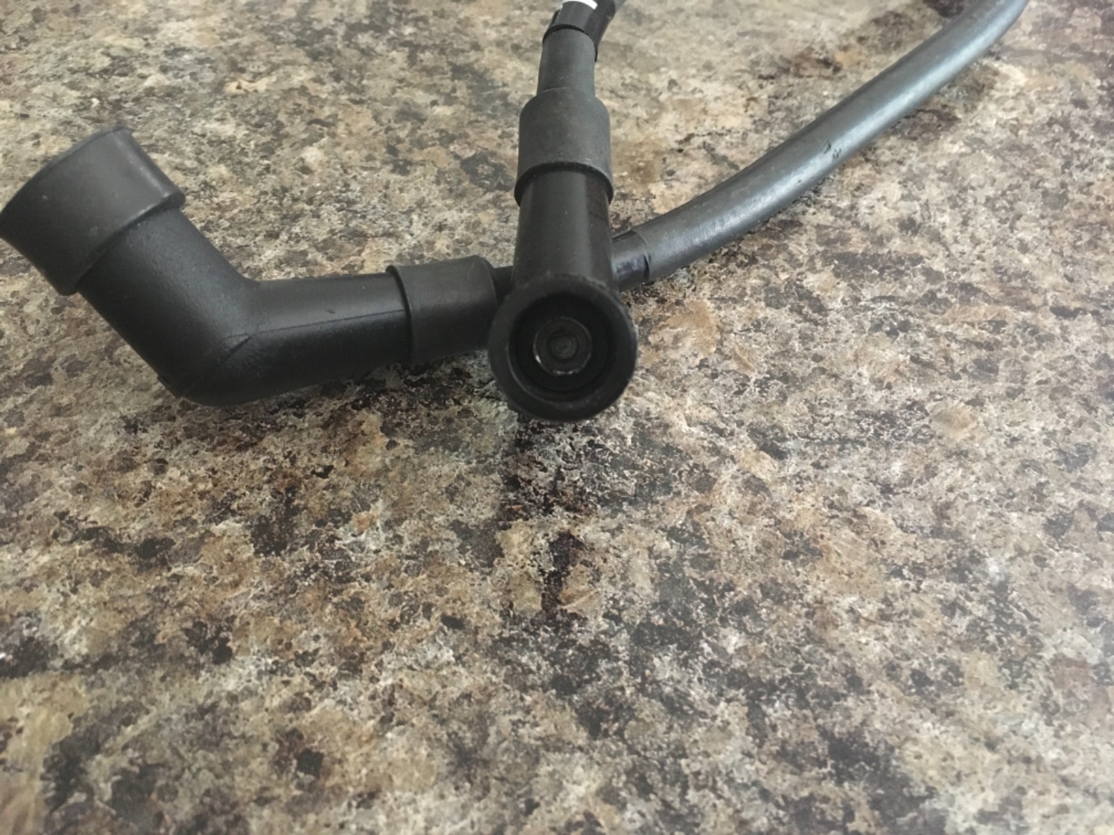

Check the fit of the boots to the plugs. NGK plugs have a removable top terminals. Not all boots require that top nut to be removed. Look inside the boot. If you see a thin ring of metal then you need the top terminal nut. If you see what looks like a disc with a small hole in the center you need to remove the top terminal nut.
You can test the resistance of the cap by removing it from the plug wire and placing one probe of you meter on the spike and the other up into the boot were the plug goes. I think they should be around 5000 ohms.

You're right. They have a small conical disc with a hole in it. Guessing it needs the cap. I'll see if I can find it somewhere in the shed.
Also they are resistor caps. They all check out between 4400 and 4800 ohm resistance. I also have resistor spark plugs in it. NGK br8es spark plugs. Maybe non resistor spark plugs would be better.

Yes replace the plugs with non resistor B8eS
You might be ok with the cap and removing the terminal nut. See photo this type needs the top terminal removed. If you put the top terminal back on and the plug cap will not go on then you know. But a cap that need the top terminal nut will go on a plug with or without. The extra gap between a plug with the nut removed and a cap that requires the nut might add to your spark issue. Hope I’m explaining it correctly.

Yup got it, thanks. It makes sense and honestly I have never used the caps on any plug and they fitted so that means I always needed them on. Will go buy today or tomorrow !

Definitely try new plugs and make sure they fit into the plug-wire caps properly. That is, make sure the plugs are with or without the screw-on terminal top depending on what your wire caps require (as Mikaw explained). If everything is not secure and clean, the spark can sometimes travel along the outside of the spark plug to get to the engine. When this happens the cylinder won't fire, but when you check for spark you will get it on all 4.
