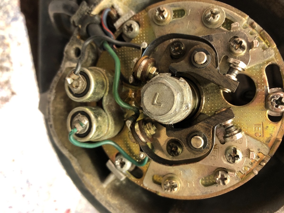

Today I decided to check points gap in my 650.
Per manual it should be 0.3-0.4mm
Ok, cover off. Ripped gasket, all bolts in poor shape, see pics. Felt does not touch shaft, no lube. Manual calls for points lube, what is it??
Checked gap and it’s very small, about 0.12mm on both according to my feeler gauges.

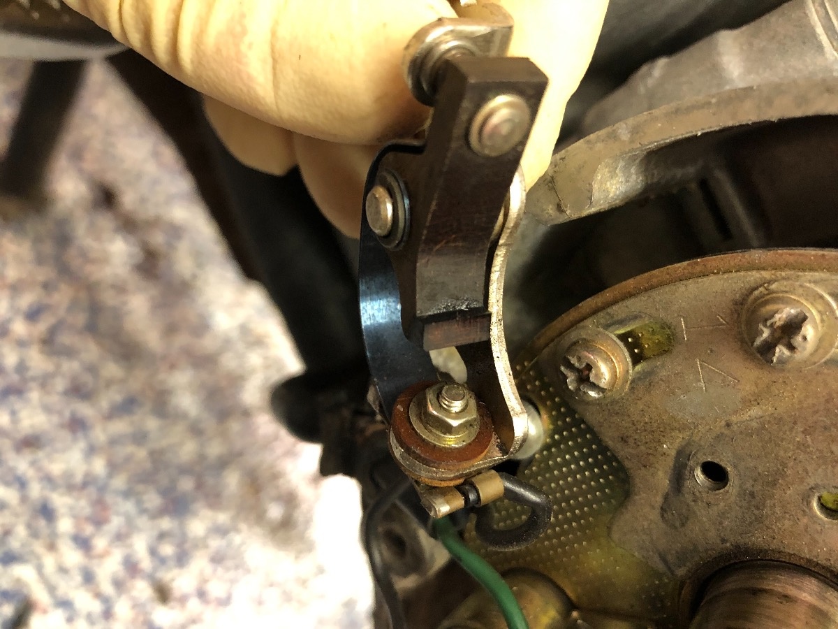

Left side 1-4 wouldn’t adjust, at the end of adjustment holes. Does it mean that plastic wore out too much?
3-4 better. Was able to adjust it - see pic. Little too wide, maybe 0.4
Seems like some new parts needed. Is converting to pointless good idea at this point?
What parts and brand do you suggest?

I would just put some new points and condensers in there, adjust the points and ride the snot out of it.
- Posts: 15337
- Thanks: 2833
Re: Points adjustment. Replacement needed?
16 Dec 2020 21:13 - 16 Dec 2020 21:14TexasKZ wrote: I would just put some new points and condensers in there, adjust the points and ride the snot out of it.
Exactly! ..... and use a JIS (Japanese Industrial Standard) screwdriver NOT phillips! Someone used a phillips driver on those screws and that's why they are damaged. I would replace them with new Kawasaki screws and use the correct screwdriver from now on. Ed
