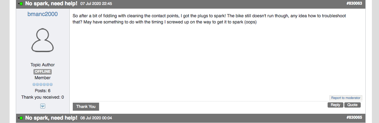

Yeah, it sat up to 4 months before I got my hands on it and I don't know how long before that. I'm planning on getting new gas later today. When I do that, should I take off and drain the carbs so they don't supply old gas?

Yeah, old gas is never good.
There is a possibility you may be cleaning the carbs out.
Old gas tends to clog passages.
But go get some new gas and try that.

You should clean the contact surfaces of the points with a small jewelers file or sandpaper.

Hello again!
Been real busy for a few days so I haven't been able to work of the bike, but I did get the bike running, but only if a continuous stream of starter fluid is sprayed down the throttle body. Looks like I'm going to be researching how to clean the carbs, or if not how to fully disassemble them, then how to clean the jets.
