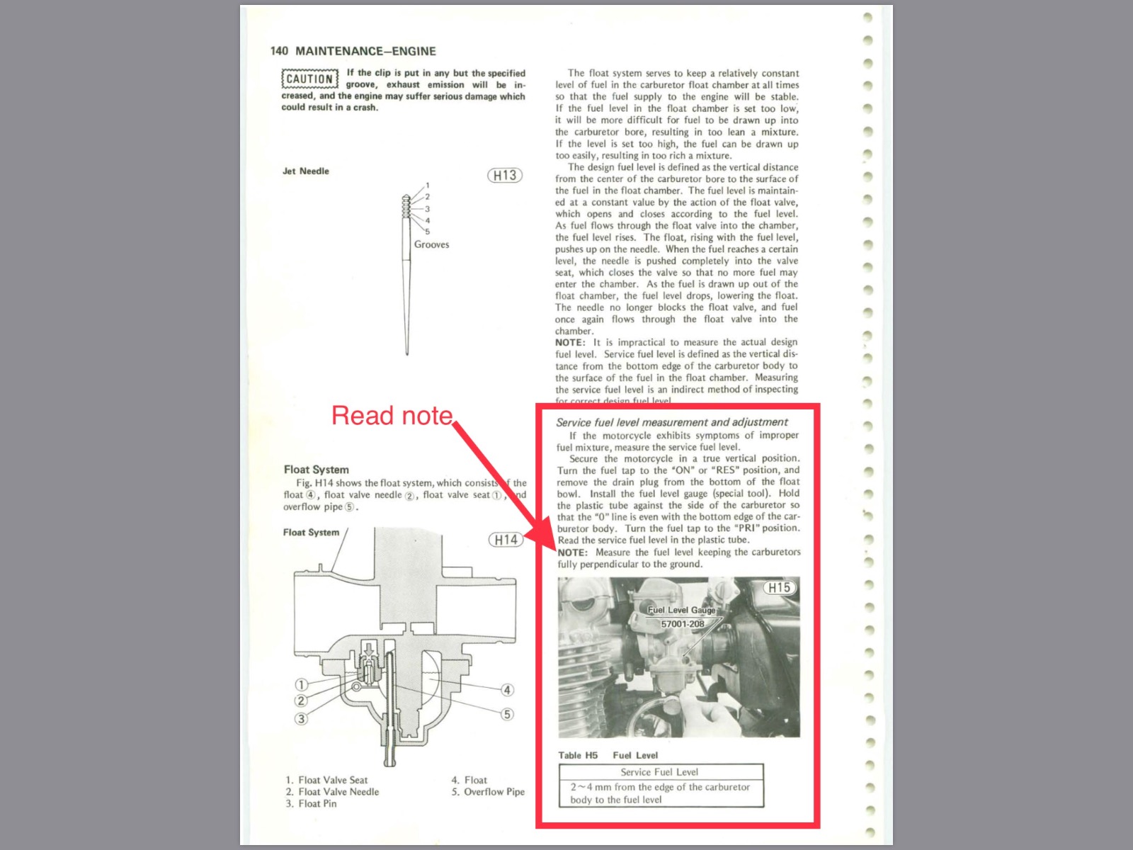

I have never heard of matching the angle of the carb on the bike when in the test stand. Everything I have heard and done is to level and plumb them to set floats, your long arm to increase adjustment angle on the tab is good but I think your way over thinking it.. it’s not that hard to test bend a bit, retest and evaluate. Are you using the clear tube method?

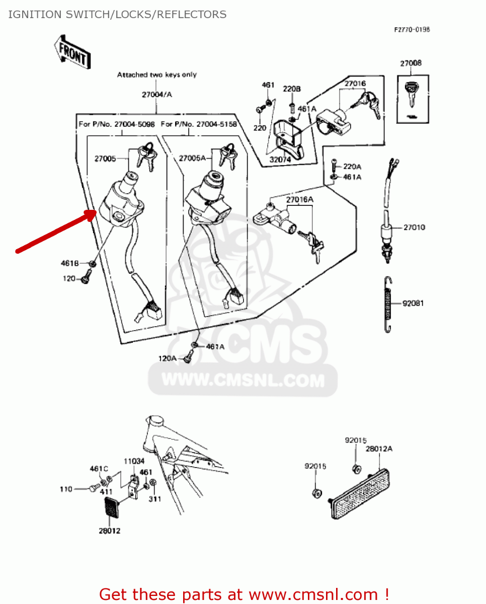

Bob if you part number is correct your ignition is used on several bike. see list below.
his Kawasaki 27005-5019 SWITCH-ASSY-IGNITION Not Available fits the following models and components:
Kawasaki Motorcycle 1983 Shaft - KZ1100-A3 Ignition Switch/Locks/Reflectors
Kawasaki Motorcycle 1982 Eddie Lawson Replica - KZ1000-R1 Ignition Switch/Locks/Reflectors
Kawasaki Motorcycle 1981 Shaft - KZ1100-A1 Ignition Switch/Locks/Reflectors
Kawasaki Motorcycle 1982 KZ1000-J2 Ignition Switch/Locks/Reflectors
Kawasaki Motorcycle 1982 GPz - KZ1100-B2 Ignition Switch/Locks/Reflectors
Kawasaki Motorcycle 1983 Spectre - KZ1100-D2 Ignition Switch/Locks/Reflectors
Kawasaki Motorcycle 1983 KZ1000-J3 Ignition Switch/Locks/Reflectors
Kawasaki Motorcycle 1982 Spectre - KZ1100-D1 Ignition Switch/Locks/Reflectors
Kawasaki Motorcycle 1983 Eddie Lawson Replica - KZ1000-R2 Ignition Switch/Locks/Reflectors
Kawasaki Motorcycle 1982 Shaft - KZ1100-A2 Ignition Switch/Locks/Reflectors
Kawasaki Motorcycle 1982 LTD - KZ1000-K2 Ignition Switch/Locks/Reflectors
Kawasaki Motorcycle 1981 GPz - KZ1100-B1 Ignition Switch/Locks/Reflectors
Kawasaki Motorcycle 1981 KZ1000-J1 Ignition Switch/Locks/Reflectors
Kawasaki Motorcycle 1981 LTD - KZ1000-K1 Ignition Switch/Locks/Reflectors

He need the ignition key lock unit with the smaller Diameter key cylinder shaft without anti theft steering stem lock!!!

No eBay APP ID and/or Cert ID defined in Kunena configurationWell, what I've got is the KZ1000-P which uses the same engine... And they were still being made till 2005. So you might be able to find a KZ1000-P version on ebay. Though looking at the rest of the post, it looks like what you're needing is the ignition cylinder. Here I was thinking you were talking about the button to start once the key is turned.
It doesn't say KZ1000-J1, but it does say it fits KZ1000-P, which is the same engine at the very least. Also, I know for a fact that the ignition cylinder in my bike did NOT come from the bike because it uses a different key from the gas cap and seat lock. The guy I bought it from fixes up KZ1000s and he stupidly put a different bike's petcock in the tank, causing the vacuum line to point forward into the engine, pinching it. I had to replace it with a NOS one for a P.
Point is, you can probably use a KZ1000-P's ignition cylinder just fine.
Partzilla is telling me that part number 27005-5035 both fits the J1 and is still available directly from Kawasaki, and there are two other compatible switches which were depreciated for 27005-5035. Also, this same part again fits the KZ1000-P.
This should make it a LOT easier for you to find the part you need.
