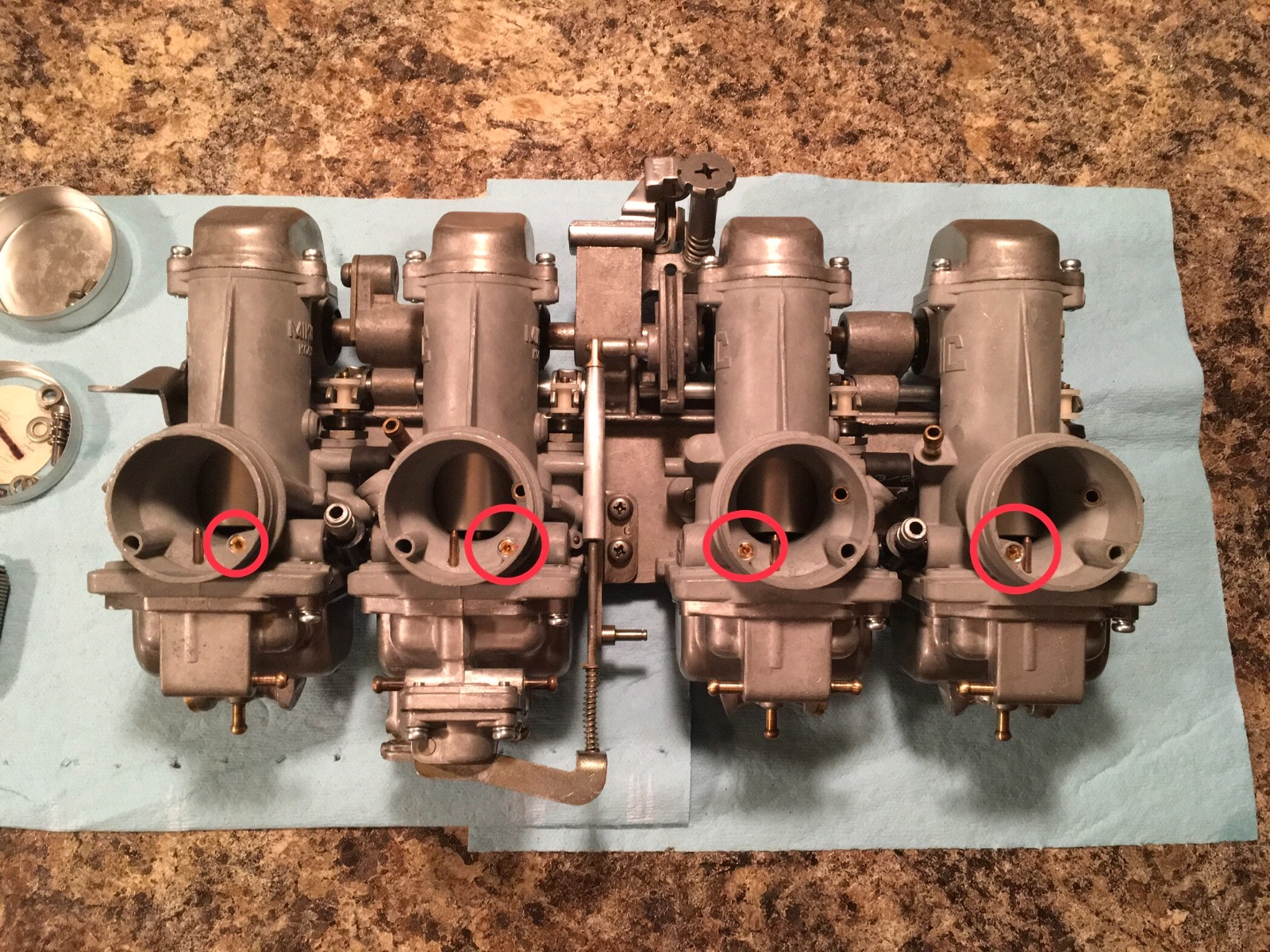

Here is my header, untouched as in factory un modified
The air correctors go in the pilot air passage and restrict air flow back to a volume created by a factory air box. When pods are installed air volume into the pilot air passage drastically increases. Thus people increase pilot jet size to correct a lean condition. With correctors the pilot jet can go back to stock size and really helps with low rpm acceleration and mpg.
Zed1015 is the man, pm him about the air correctors.

24 Jun 2020 13:53 - 24 Jun 2020 15:47Flatblackobsession wrote: Zed, thanks for these thoughts.
I'm running 120 main jets. 22.5 pilots.
What are air corrector jets for the pods?
When you did the Dyna S, did you have to replace the coils, or run stock?
Also, why wouldn't you run the hotter plugs? Seems like they'd burn more fuel and it would be the cheapest fix-- right?
Hi, Flatblackobsession.
Here's a link to the air corrector thread.,,
www.kzrider.com/forum/23-for-sale/611992...-round-slide-mikunis
You should read it to the end for all the details and comments of their effectiveness.
With them installed you would put all settings back to stock including needle position etc and go around two sizes up on the stock main.
No need to mess about with larger pilots and lifting needles that don't fully cure the low end hesitation and also over richens the mid and top end..
With the Dyna you can run stock coils or performance coils as long as they are 3 to 5 ohms resistance.
As for the plugs. Hotter plugs run hotter.
They won't burn more fuel and will only delay the fouling but you do risk overheating and damaging the engine as a result.
Rob.
