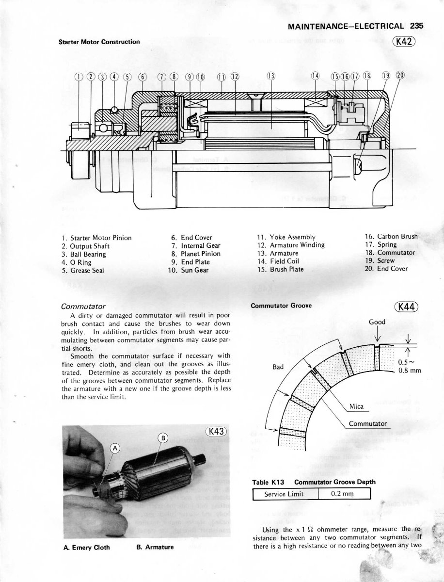

Sounds good thanks! Now to just find someone with a lathe lol. I am guessing the uneven surface causes excessive wear on the brushes?

02 Jun 2020 17:01

I did the resistance test and all commutater segments check out. Out of curiosity though, what is the mica?

Mica is used as electrical insulator in motors because is hard and very resistant to high temperature. In this case is insulating the commutators bars.
This is a DC motor, not AC, thus the brushes and commutators......there is also a mica like material between the positive connector and the motor's body which is negative (to ground).
