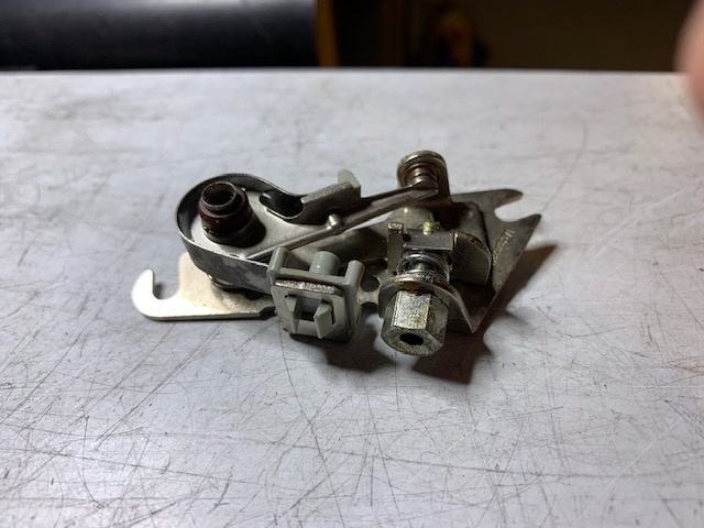

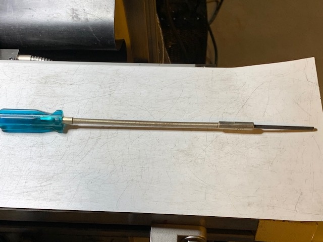

03 Apr 2020 06:55 - 04 Apr 2020 05:51This is slmjim.Rockranch wrote: Next question...what automotive points were sometimes used back in the day in place of stock 900/1000 points?
I'm dating myself by admitting to familiarity with this but, here goes.
There was an aluminum points plate in the Z1/KZ1000 day that used GM points that were riveted to the plate. I don't remember who made/marketed it. Only adjustments were for points gap and overall timing by rotating the entire plate. These were the GM points that had a hex socket screw for adjusting dwell. When these points were installed in a GM distributor, the dwell was adjusted through a little window on the distributor cap that had a cover that slid open vertically, so a hex wrench could be inserted into the dwell adjusting screw on the points. Dwell was adjusted with the motor running while observing a dwell meter. We still have an 18" Blue Point flexible hex tool in the ignition tool drawer purpose made for the task. Overall spark timing was done by rotating the entire distributor.
Interesting concept, but I never bought into that device. Not enough flexibility. Looked like a gimmick.

Slinjim: I have the same tool for adjusting points that you must have. Lots and lots of points were adjusted with that tool. Worked way better than a stupid old allen wrench. I always thought the way GM did their early points with the window in the distributor cap was far easier than Ford or Mopar. Took longer to hook up the tach and dwell meter than to adjust the points in a GM car with the distributor window. Great feature when one worked on comission.
