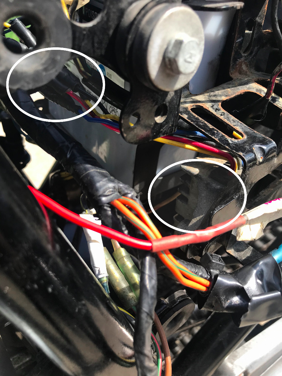

So....
I ended up stripping the entire harness to look at all the wires individually. While this was good it truly revealed the extent to which the harness has been modified and the need for a full re-wiring.
There was a couple of damaged wires within the harness which I have taped. I also found a loose connection going into the fuse box which might have been a likely culprit.
Following one of the recommendation here, I ran the bike and wiggled some of the wire to try to identify the short, while I was never able to pop the fuse while on the stand, I did find a set of connections where wiggling the wires had an impact on the running of the engine (see attached picture). These wires seem to connect the stator to what is either the rectifier or regulator (see picture - a slighly bigger unit similar in design in under the battery box )? I haven't got to testing the electrical component individually yet. Will report today when I do.

The circled component appears to have a blue wire, so it's probably the Igniter. The wiring diagram has the wire colors:
From the 750-H2 diagram: red, yellow, black, blue to the pulsing coil; and red, black, green, black/yellow to the ignition coils.
note: the wiring diagram is showing a red wire from the igniter to the ign coils, but it might be red/yellow.
The unit under the battery box is probably the voltage regulator (reg-rec). 3 yellow wires plus black, red, brown. The 3 yellow wires go to the stator.
Last edit: 03 Apr 2020 08:44 by martin_csr.

Thanks - that's really helpful! I took a short ride on the bike yesterday and it was running fine (no fuse were popped) - so I imagine the issue might have came from the poor connection close to the fuse box.
In the process of cleaning the wire and inspecting connection I also checked the spark plugs and realised one was damaged (plug and cap). I bought 4 new spark plugs yesterday (NGK B8ES) - but not sure how about changing the damage cap, and how to get the appropriate one. Any advice>?
