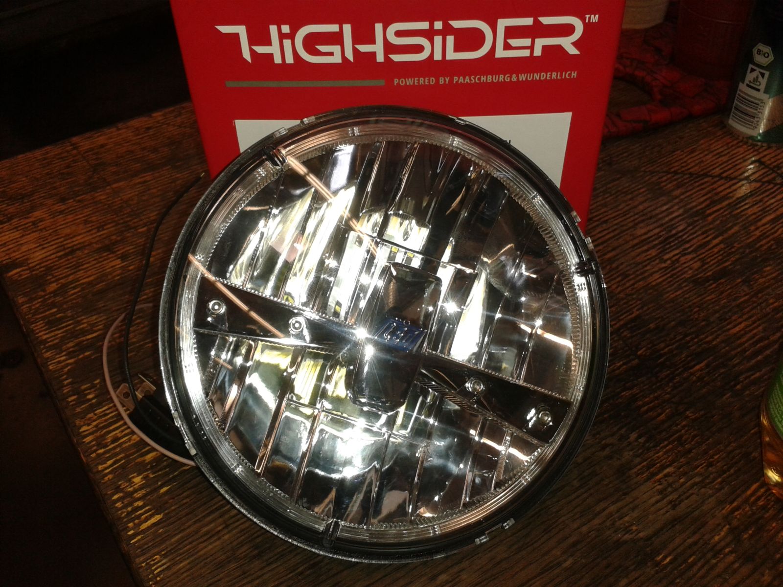

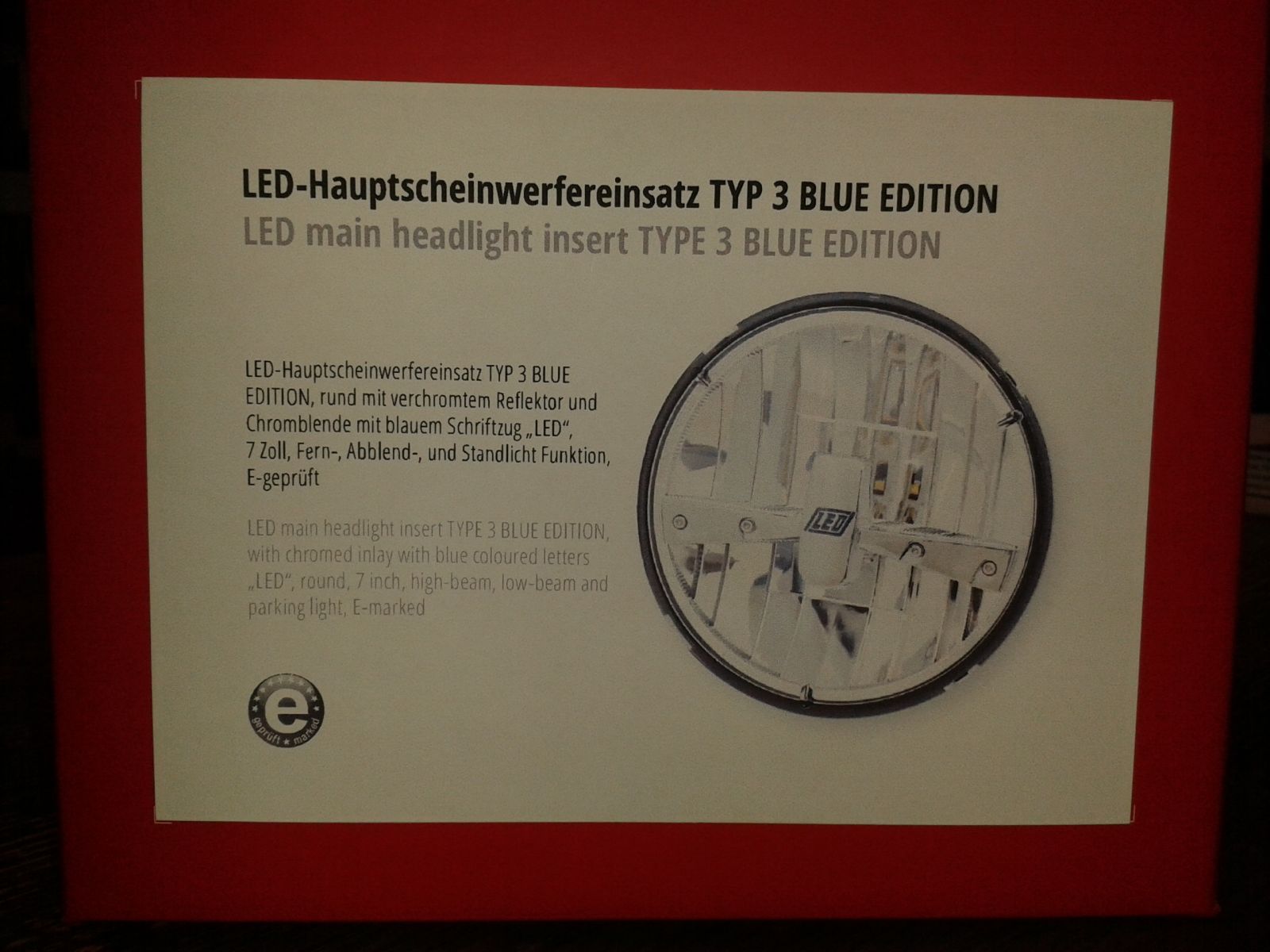

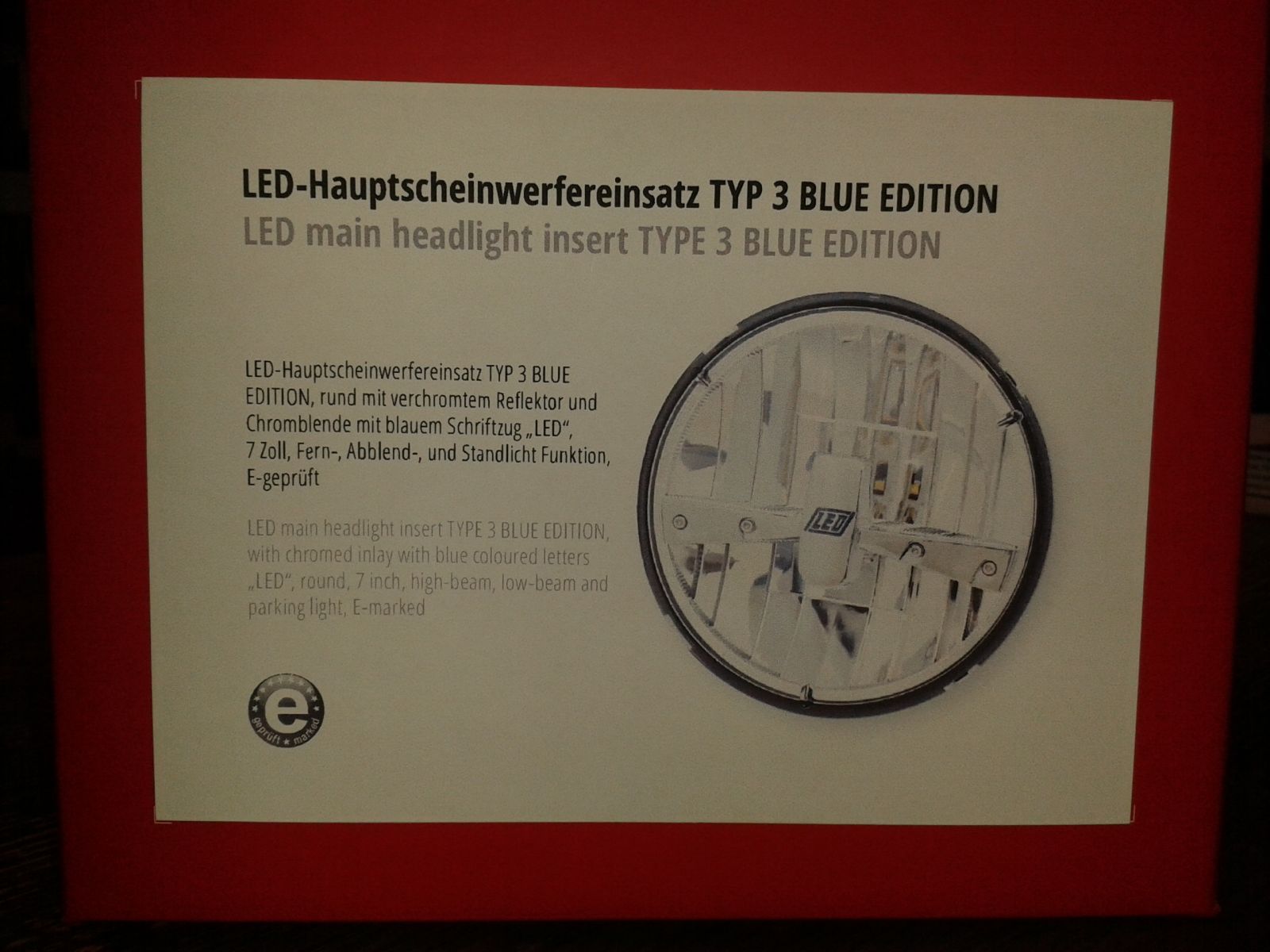

I have replace my head light with an Highsider Type 3 LED main head light insert. It´s plug and play, no mods needed to fit into the Z1 head light frame.

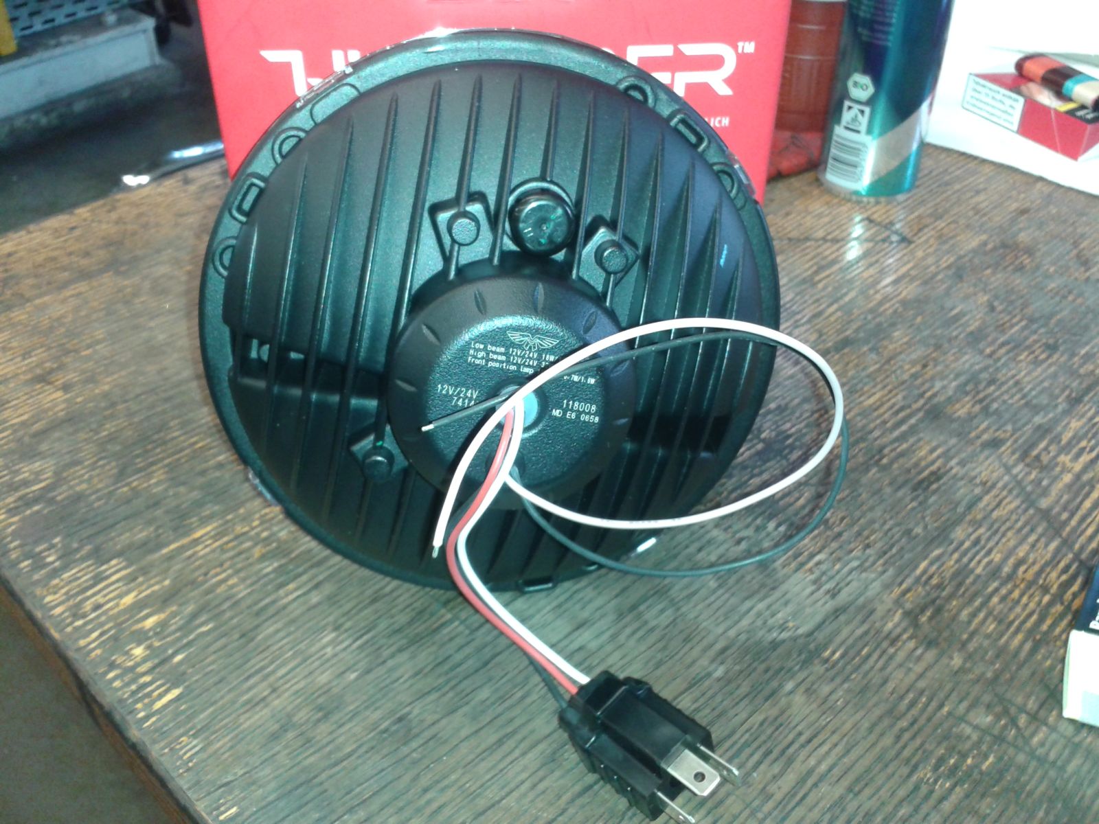

No eBay APP ID and/or Cert ID defined in Kunena configurationThis is what I run in my Z1.

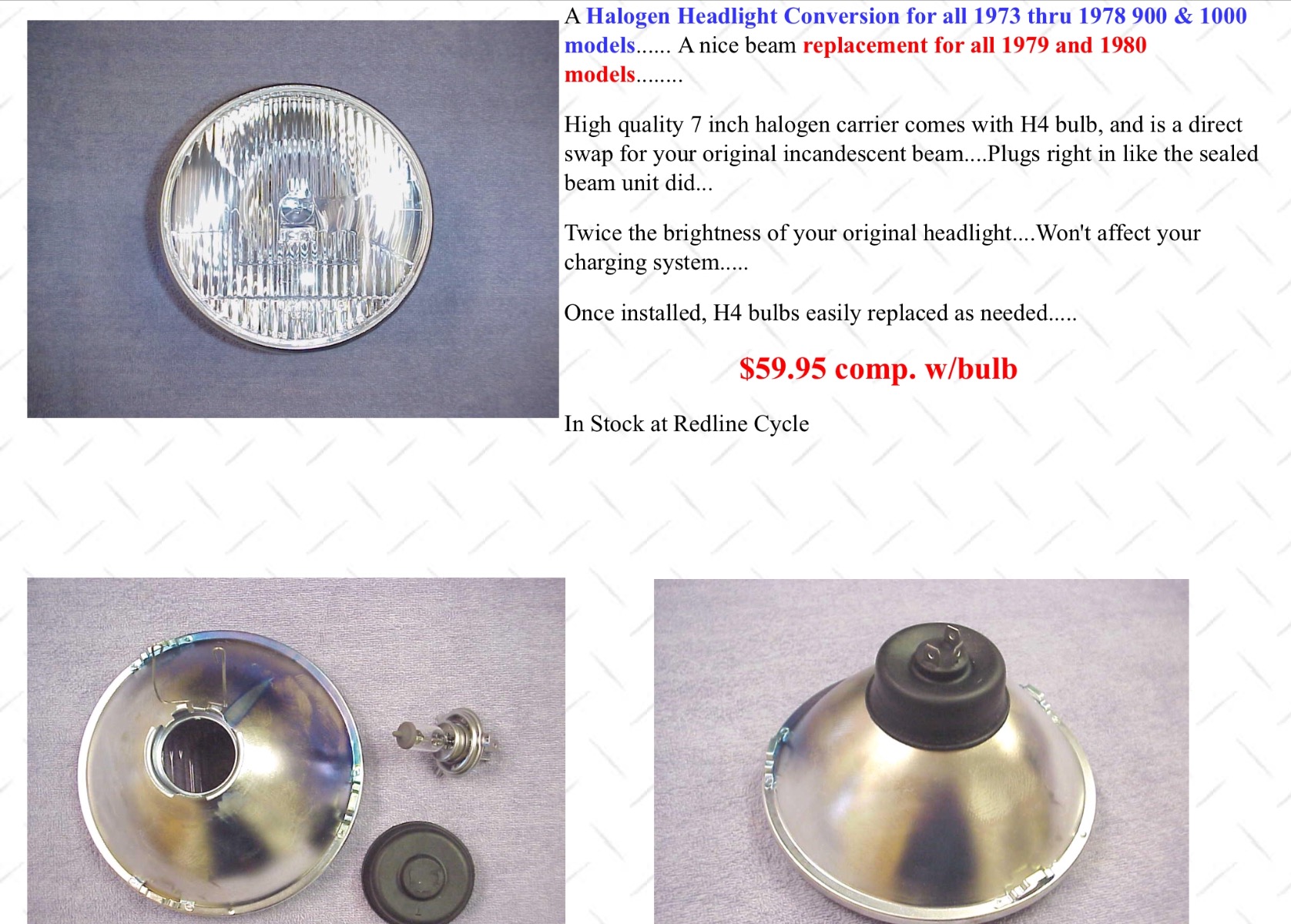

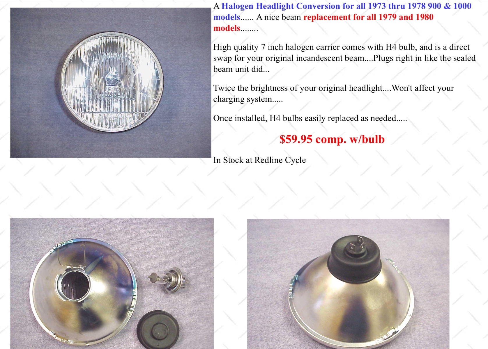

I used this carrier from Redline cycle.it reflects a really nice pattern with the bulb Swest recommends

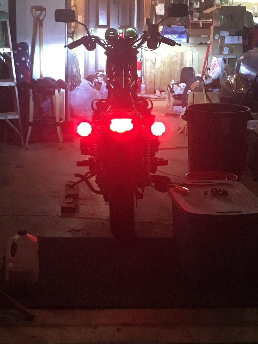

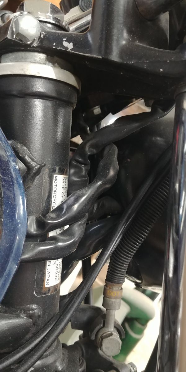

Also adding more running lighting to the rear. I upgrade to all led red bulbs. Found red lenses that fit LTD front dual element housings. Reworked the wiring harness to add running light from the rear light. I wish it could’ve been red running and Amber turn but I’ll take anything over just the center rear tail light. I’m really worried with today’s drivers about getting rear ended

Did you have to modify anything to fit this light ? I went on the Adjure web site and it says it doesnt fit most metric bikes .
I have had my eye on one of these for quite a while

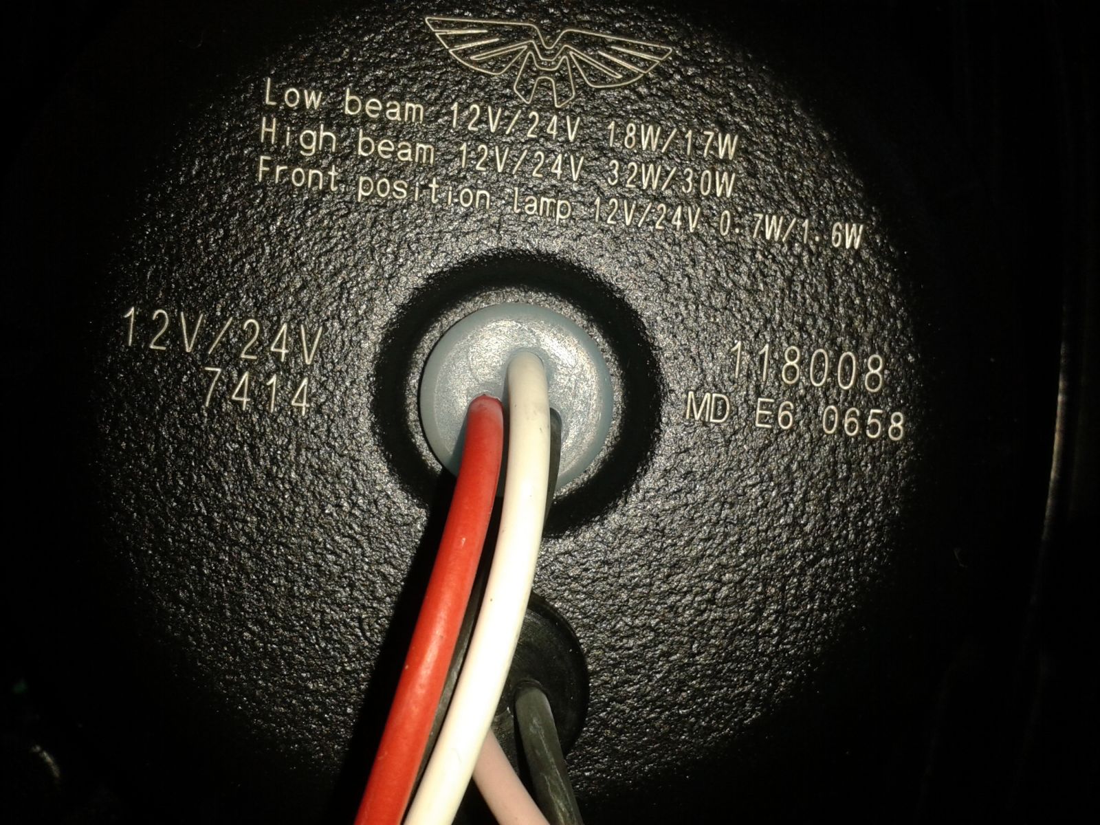

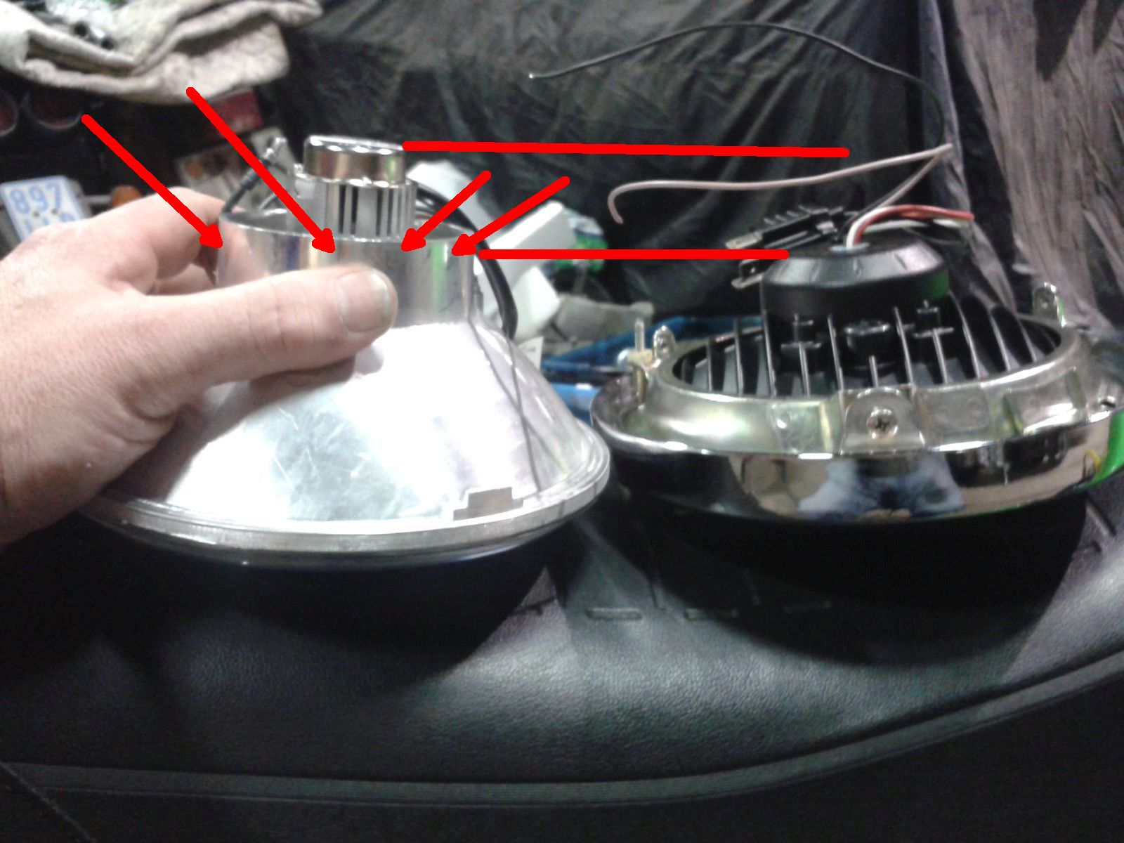

The reflector will fit the head light Frame but will give you a big Problem with the head light housing depth, no space left over for the wiring loom and connectors !!!

No modifications that I can remember.

12 Feb 2020 12:49You might want to look for a different bulb, all my wires fit just like stock.
