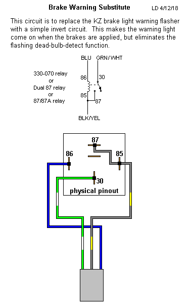

Are you talking about the dashboard indicator for the brake light ? (not the turn signals)
If so, that is a bit tricky. The flashing circuit needs to see something like a regular light bulb to work properly.
(To those who don't have the brake warning unit) It has two functions. One is to indicate when the brake light is on, and the other is to flash when the brake light bulb is burnt out.
Your options are to unplug the brake flasher unit which will also render the dash light inoperative, or live with it flashing forever, or build a little inverter circuit to put in it's place which will turn on the dash indicator when the brake lights are on, but won't flash.

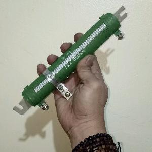

That opposite reaction means it will take a drastic amount of compensation with a resistor. The resistor will have to be big in order to dissipate the type of energy that will be required. A bulb dissipates energy as light and heat, but a resistor dissipates only heat, so it will be hot and will need to be big to not burn up.
The requirement of the filament to act as a short means that in order to replicate that with a resistor, you will have to use a very low resistance resistor. But, when 12v gets applied while hitting the brakes, a very large amount of power will need to be dissipated. A bulb would increase its resistance to reduce the power requirement, but a resistor does not change. This makes the resistor's size (wattage) requirement impractically large physically.
Here is an initial rough estimate.
When off, an 1157 bulb's filament acts something like a 1 ohm resistor. With little voltage applied, the wattage is very tiny.
When on, an 1157 bulb's filament acts something like a 6 ohm resistor. Dissipating somewhere around 25 watts. (12.8v @ 2.1 amps).
In order to replicate the filament for the brake flasher, when the brakes are not applied, you might need a resistor that is around 1 ohm. Resistance of a resistor does not change much under normal conditions, so that same resistor will have to dissipate a lot of power when the brakes get applied. Let's see how much.
Let's assume the system is running at 12.8 volts. The resistor is 1 ohm. That means there will be 12.8 amps flowing. First of all notice that the 10 amps of the lighting fuse will blow. But then also notice if we multiply volts times amps to get the wattage, we need a 163 watt resistor. To be safe, you will want to upgrade that to a 200 watt resistor.
Now take a look on the internet to see how big a 200 watt resistor is. You can use that to cook hot dogs on.
But this is to replicate the resistance of an 1157 bulb. Perhaps making the flasher work won't take such drastic measures, but an 1157 bulb is what it was intended to detect, so that is the starting point.

By the way, the most complicated suggestion I gave earlier is about the same difficulty as adding a resistor or diode, but is easier to get, and only a bit bigger than the original brake flasher unit. You can get this relay at any autoparts store.

Well , I just couldn't let the brake light go and now I owe you a beer. I bought the relay you suggested and wired it like your picture shows. It works perfect. And with a small bolt, to hold it in place; it fits perfectly as well. Really easy fix. Thanks.

Nice job! I think you're the first person to confirm that works, so thank you!
