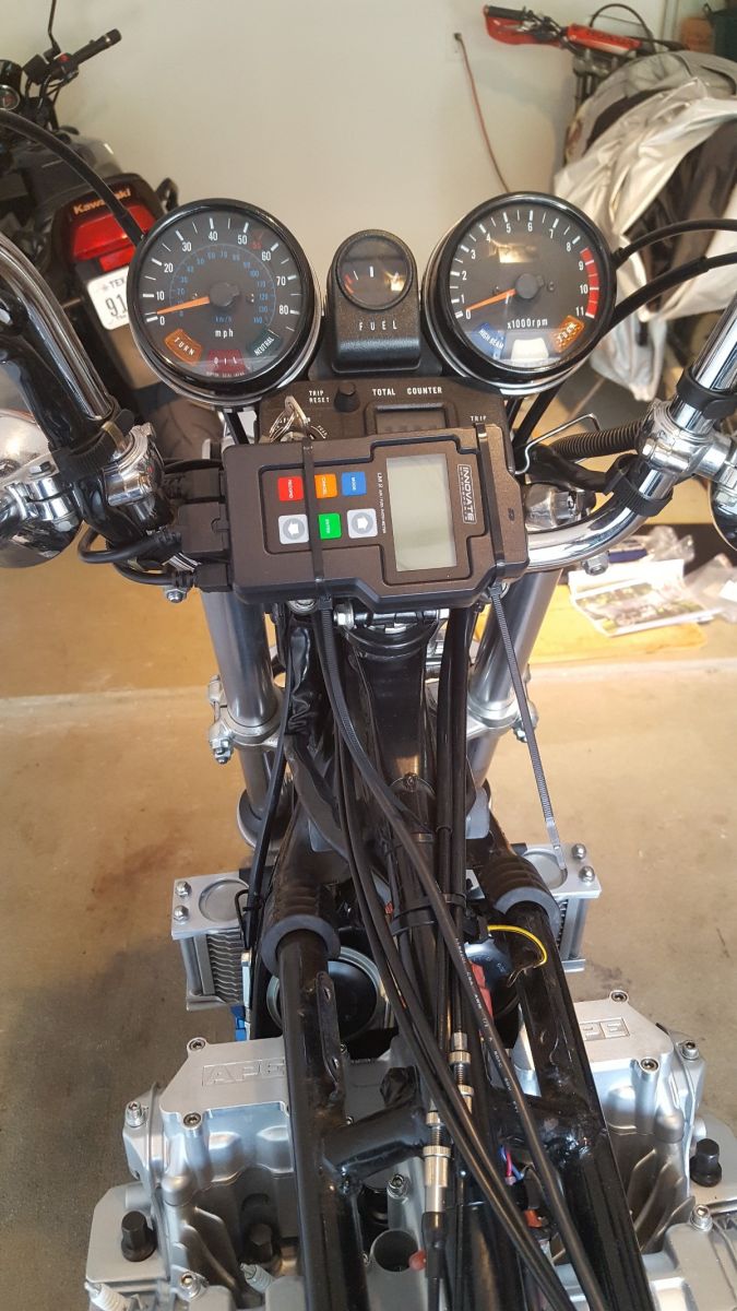

Anybody used an Innovate LM-1 or 2 on a KZ? Found a voltage problem after installation. I have it wired to the coil feed circuit. Coils are now powered by a relay. Fully charged battery voltage at 12.4 volts. Dips down to almost 12v with the ignition on (most of it from the headlight). Then you add the voltage drop from the battery, through the ignition switch (about .3v drop), kill switch, and you wind up with about 11.5v with the key on at the LM-2 unit.
I either get an E9 trouble code due to low voltage, or the O2 sensor heater times out. Never getting an air/fuel reading. Can correct by hooking up a charger to boost voltage, or disconnect headlight bulb to eliminate that lost voltage.

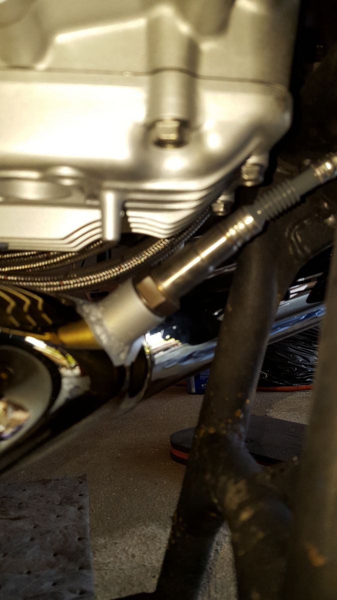

Need to ride and tune by air/fuel under load, so a stationary battery won't work. A kill switch for the headlight is a thought. But I think I'm gonna end up adding another relay and hooking the LM-2 directly to the battery. The LM-2 is a temporary device for tuning, but I plan on installing an air/fuel gauge when done. So I figure I might as well get the wiring correct now.
Gonna call Innovate tech today. I'll let you know what they say.
I have the unit strapped at the handlebars, and a great location for the O2 just after the collector on my Kerker where no one can see it.
