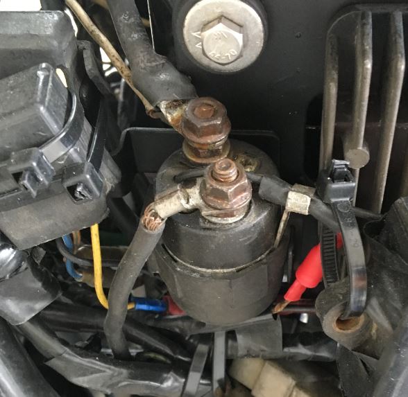

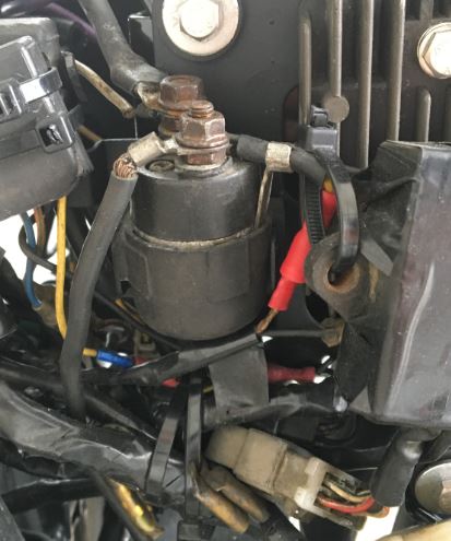

When I tried to start the bike today, nothing happened..
I started to troubleshoot, and there was no voltage over the start relay out to the start motor..
So I took a hammer and knocked on it and then it start working...
Please see attached picture, is it possible to purchase identical on new on ebay or something ?

A starter solenoid is pretty universal. Wire goes to lug on solenoid from battery and wire from other lug is connected to your starter. Starter is grounded by the bolts that hold it to the engine case. On your solenoid there is a ground wire and some have this wire and some don't. Your issue could be the poor wire of the wire going to your starter. You might want to take that wire off the lug, cut about an inch off and install a new connector or open up the old eye connector and clamp it good over some clean wire that isn't cut/frayed as the current connection appears to be.

I’ quite sure its the solenoid it self. So i can just by these?
wiredgeorge wrote: A starter solenoid is pretty universal. Wire goes to lug on solenoid from battery and wire from other lug is connected to your starter. Starter is grounded by the bolts that hold it to the engine case. On your solenoid there is a ground wire and some have this wire and some don't. Your issue could be the poor wire of the wire going to your starter. You might want to take that wire off the lug, cut about an inch off and install a new connector or open up the old eye connector and clamp it good over some clean wire that isn't cut/frayed as the current connection appears to be.

It should work. Yellow/red is likely trigger from your start button on right handlebar switch and green/black is likely a ground.

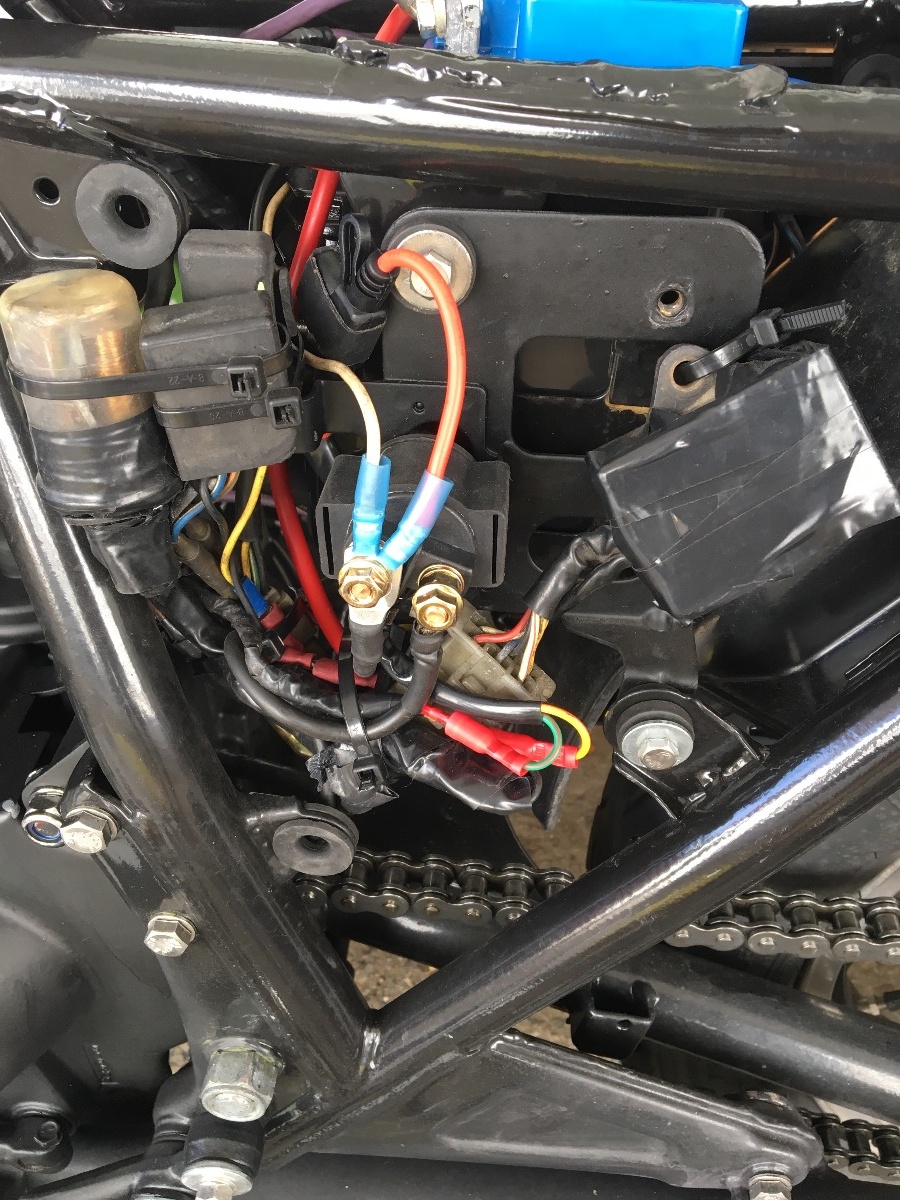

Today have I installed new relay
it’s working great. Cleaned up some wiring at same time. One problem less

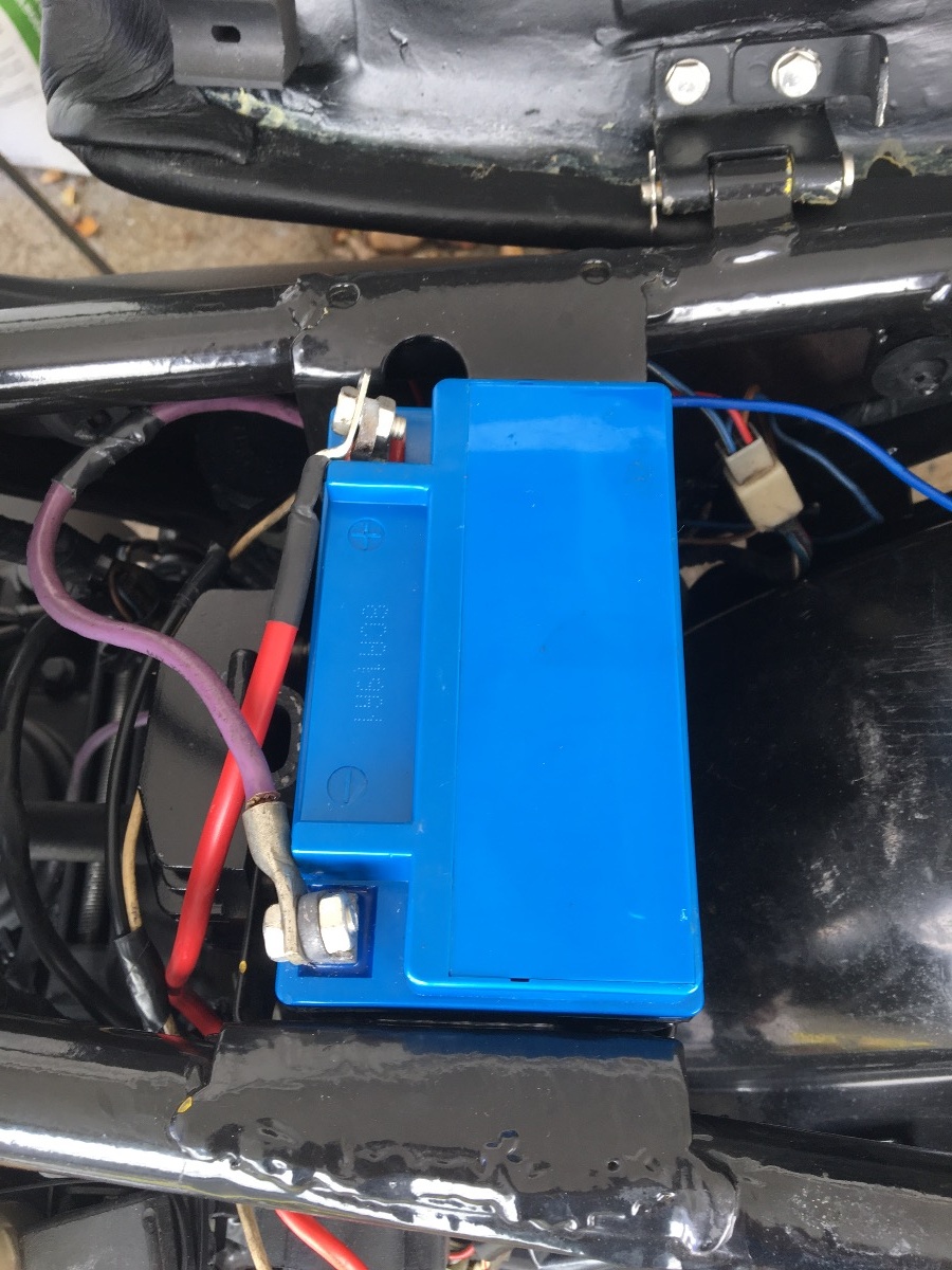

Keep an eye on those battery terminals. They don't look good. Too much stress there can cause acid leaks or a terminal failure.

gordone, you have to put a rubber cap over the positive battery terminal to prevent a shortcut, it´s a must have!!!

I need a new battery and smaller shoes for the cabels, and then will it be good

08 Jul 2018 13:30 - 08 Jul 2018 14:04I don't understand why you found it necessary to relocate the solenoid from the original location (sticking out from the bike ) to a location with a SOLID ground right next to the B+ battery cable? This is a dead short looking for a good bump in the road to weld it's self to an un-fused B+ cable and burn up a few things.. like the cable and possibly the bike? There is no sense in building in your own disasters while attempting to "fix" something. Just sayin.
This is aside from the battery terminal that Scirocco already pointed out to you that needs a rubber cap, and possibly a little rethinking.
Inquiring minds want to know.
EDIT: Ok, I think I got it now.. the sol sticking out is the NEW location, and the solid ground by the B+ terminal on the sol is the old location.. If this is the case, you done good. Keeping up is a challenge some days.

Yes, the top pic is what he started with, and the bottom pic is his solution.

I should have made som comment to the photos sorry.... the old start relay was sticking up and the new is sticking out
The pol on the batteyr is stupid... they should have sticked up so I could mount the cabel shoes on top and not the side....
I have now ordered some new cabel shoes with correct size... the old was was number to big.
