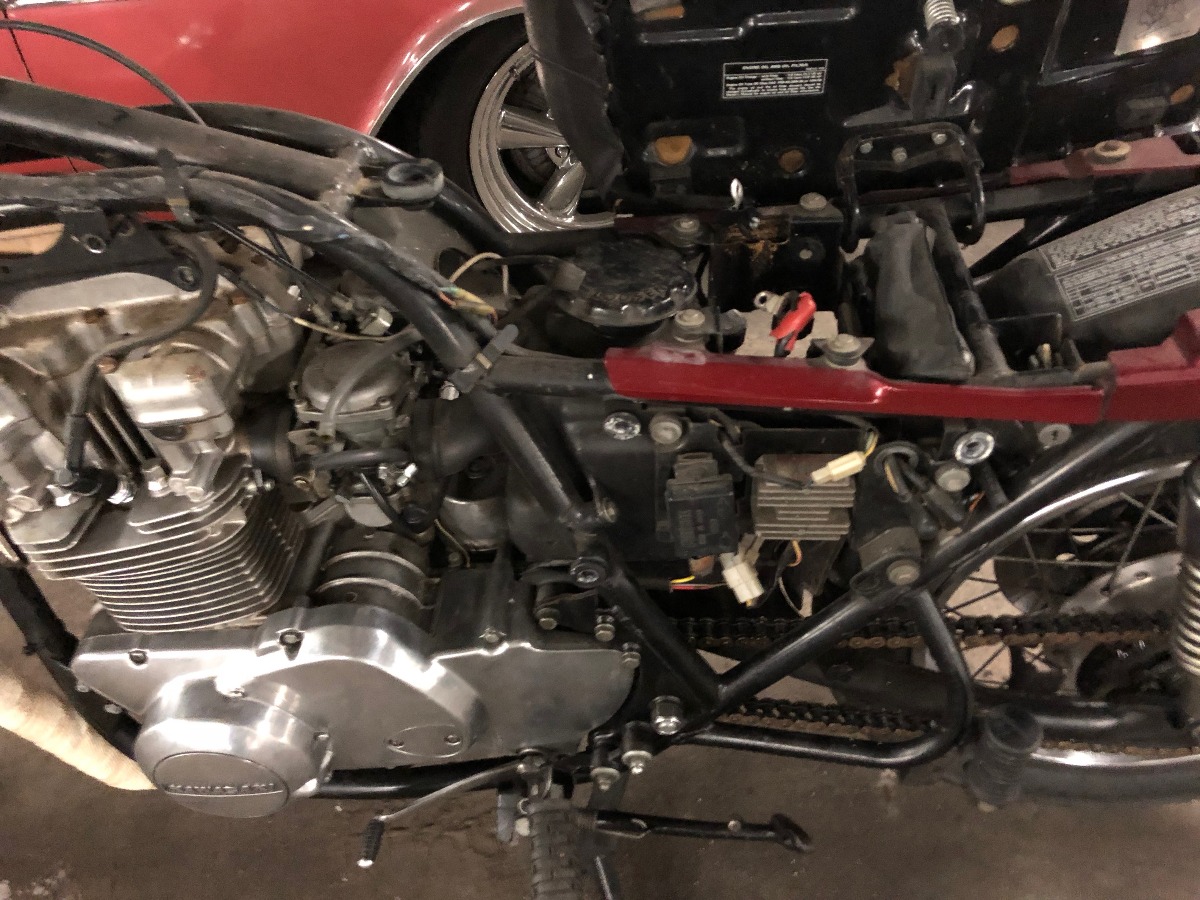

Sorry. I should have updated this. I hate it when ppl post an issue and never follow up. Seems like for a minute, I was one of those guys.
Two weeks ago I changed the battery and coil and voila, bike works great.
Only issue is, I was so tired from the workweek, I simply cable tied (or zip strap or whatever you call it) the coil to where it was on the frame
