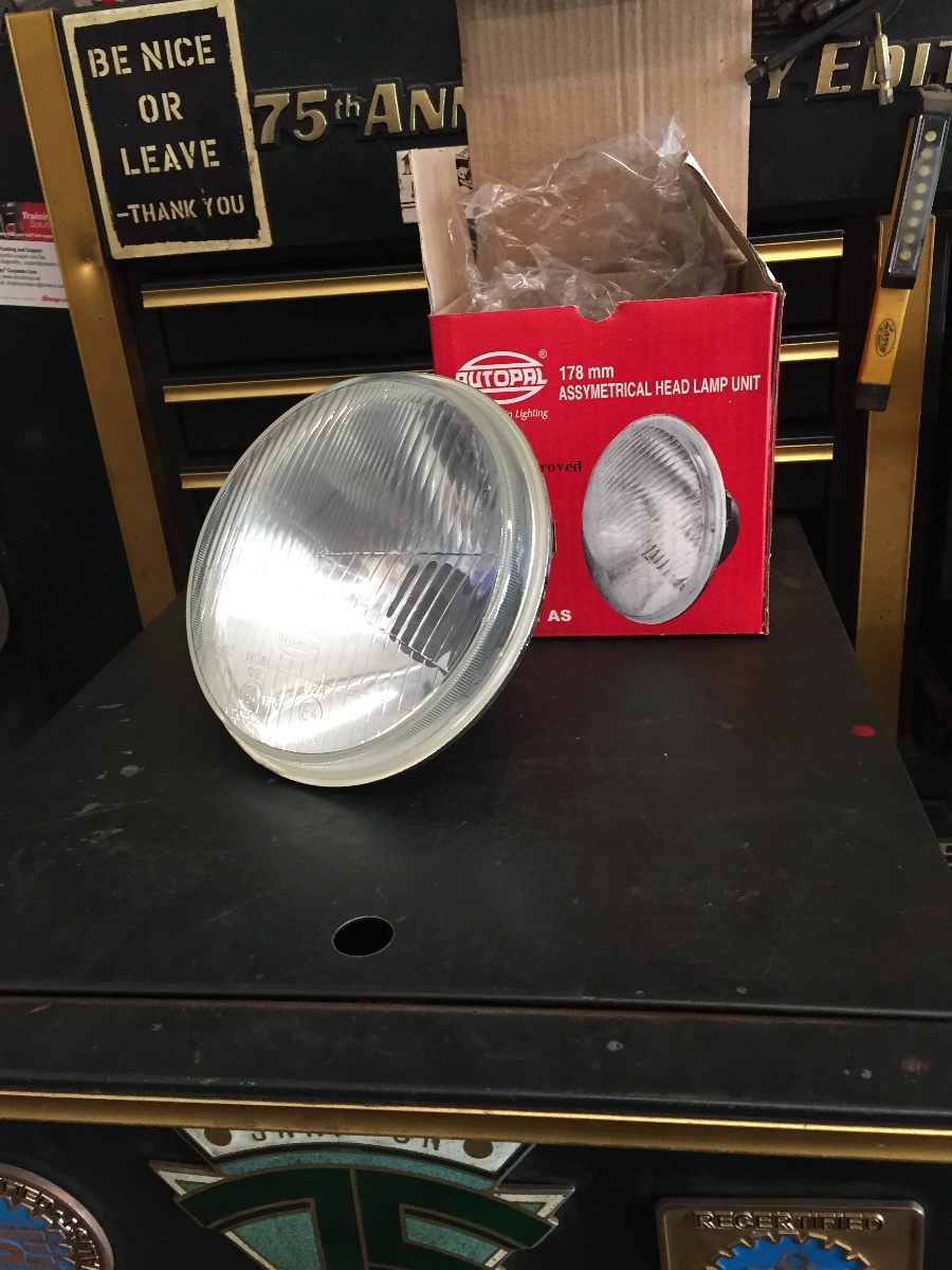

What is an asymmetrical head lamp? Is that a sealed beam or does it take an H4 bulb?

Z1Enterprises.com sells H4 bulbs. in case you need other maintenance type stuff.
I installed a halogen headlight from an 82 750H Ltd. it was a direct fit. all I needed were the lens unit, H4 bulb & dust cover. The lens was cloudy, so I cleaned it with denatured alcohol.

12 Jul 2017 15:41 - 12 Jul 2017 15:43What is an asymmetrical head lamp? Is that a sealed beam or does it take an H4 bulb?
The head light on the left side has a different lens geometry to prevent blinding the drivers of oncoming traffic.

H4 conversation headlamp. All glass lense and metal back with high quality reflector. It's a inexpensive version of the Bosch of Cebie light. Got 2 of them for 35 bucks!no bulb.... I have plenty at my shop.
