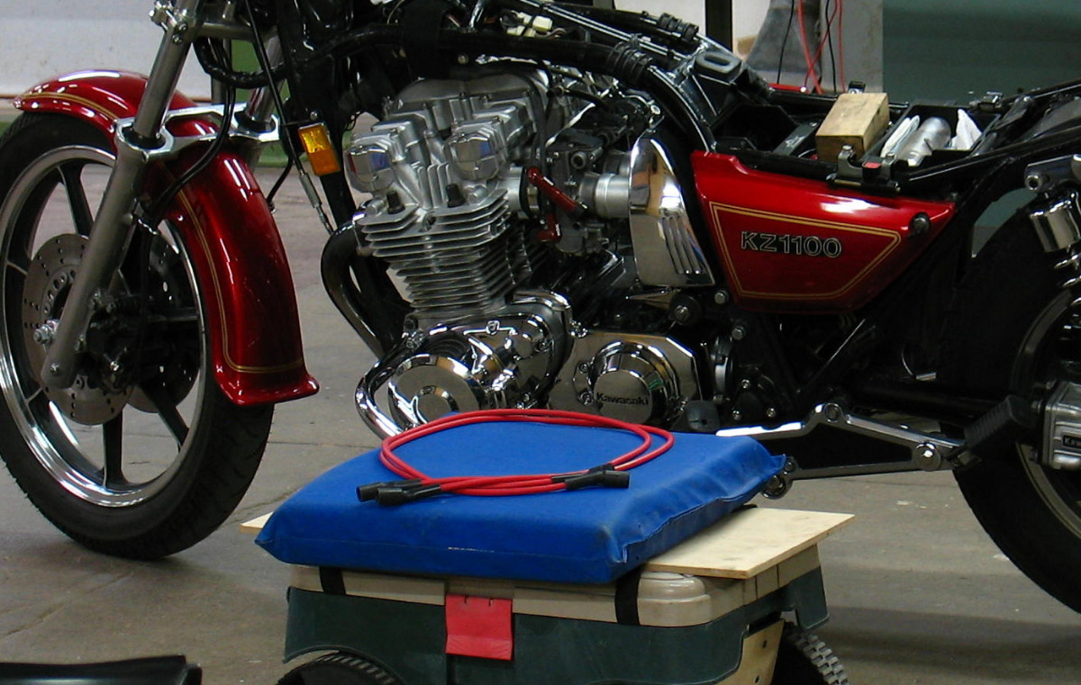

Just replaced my black solid copper core black wires with red ones shown sitting on the cushion in the photo foreground...
I attach the factory crimped end with rubber boot to the coil terminal, and screw the resistor (or non-resistor) caps on the cut-end depending on what spark plugs are being used. That is, resistor caps for non-resistor plugs, and non-resistor caps for resistor plugs.
I still have the black ones btw. :whistle:
