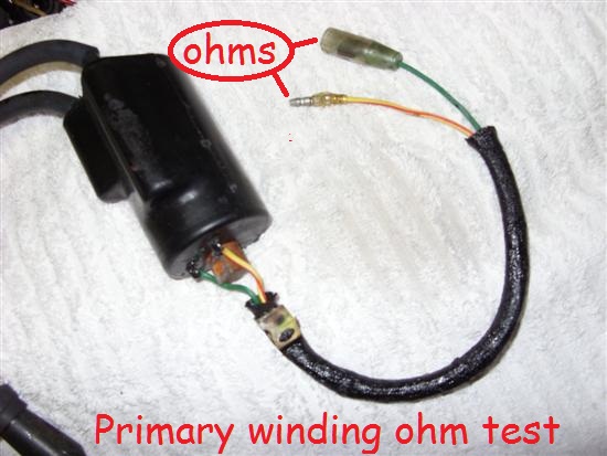

I suspect any 12 volt dual-output coil with the same resistance in the primary winding (ohms) would work just fine. Should of course be sure that the chassis will accommodate whatever mounting arrangement the coil requires (it would be preferable and easier to install when keeping the stock coil physical design and mounting configuration) .
Use an ohmmeter to measure the resistance of the coil's primary winding:
