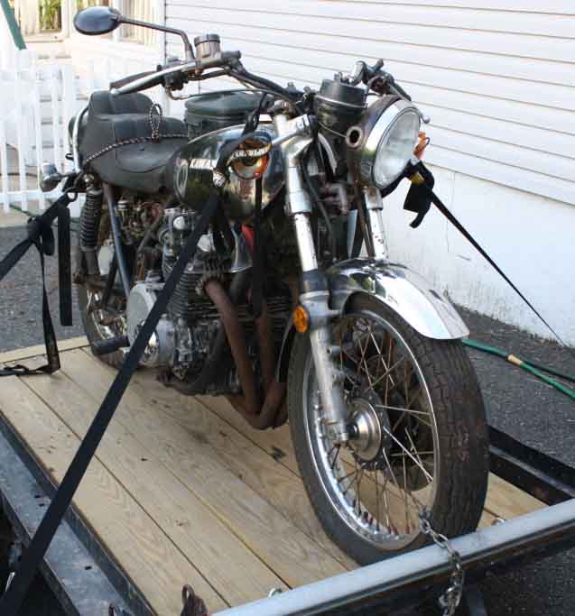

Forgetting to put the side stand up is the story I was told on this bike. The right side damage and bent side stand mount tab are consistent with the story. The PO stopped to check something and took off with the side stand down. He made it to the first left hand corner. He never rode it again. The bike was shoved in a shed where it sat for 30+ years.
The bike looks a little different now.
