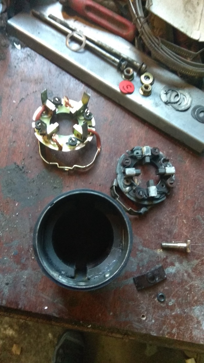

- nikevas
- Posts: 1
Re: KZ 440 1981 starter
28 Oct 2019 01:11
Hi, I had the same problem with the starter - a broken magnet. I glued it to the LOCTITE Power Fix Gel and it works perfectly now.
