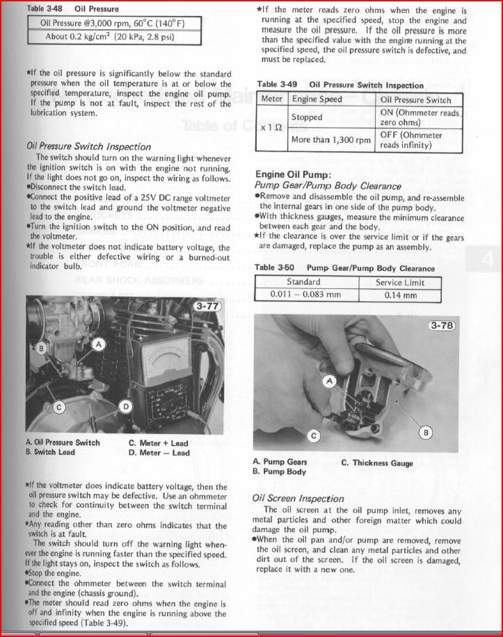

I know this is kinda low-res, but maybe it will help.
