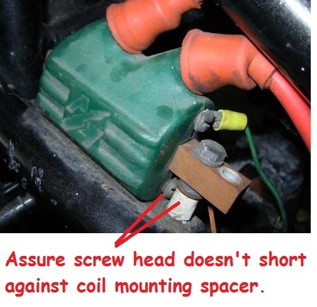

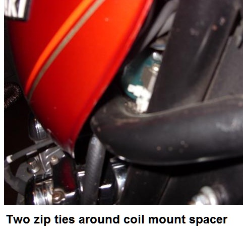

To clarify -- Is it still backfiring through the exhaust while under acceleration?
Would suspect an ignition problem being more likely than a carb problem.
The Dyna ignition coils have screws that attach the wires to the primary terminals.
Sometimes the screw heads are perilously close to grounding against the coil mounting spacers.
If not already done, would assure that the screw heads are insulated against shorting against the spacers.
Or could fit non-conductive spacers such as plastic or nylon.
I use a nylon tie-wrap as an insulator around the stock metal spacer.
And of course there are other ways to insulate the screw heads.
Attachment coilmountspacerdyna.jpg not found
