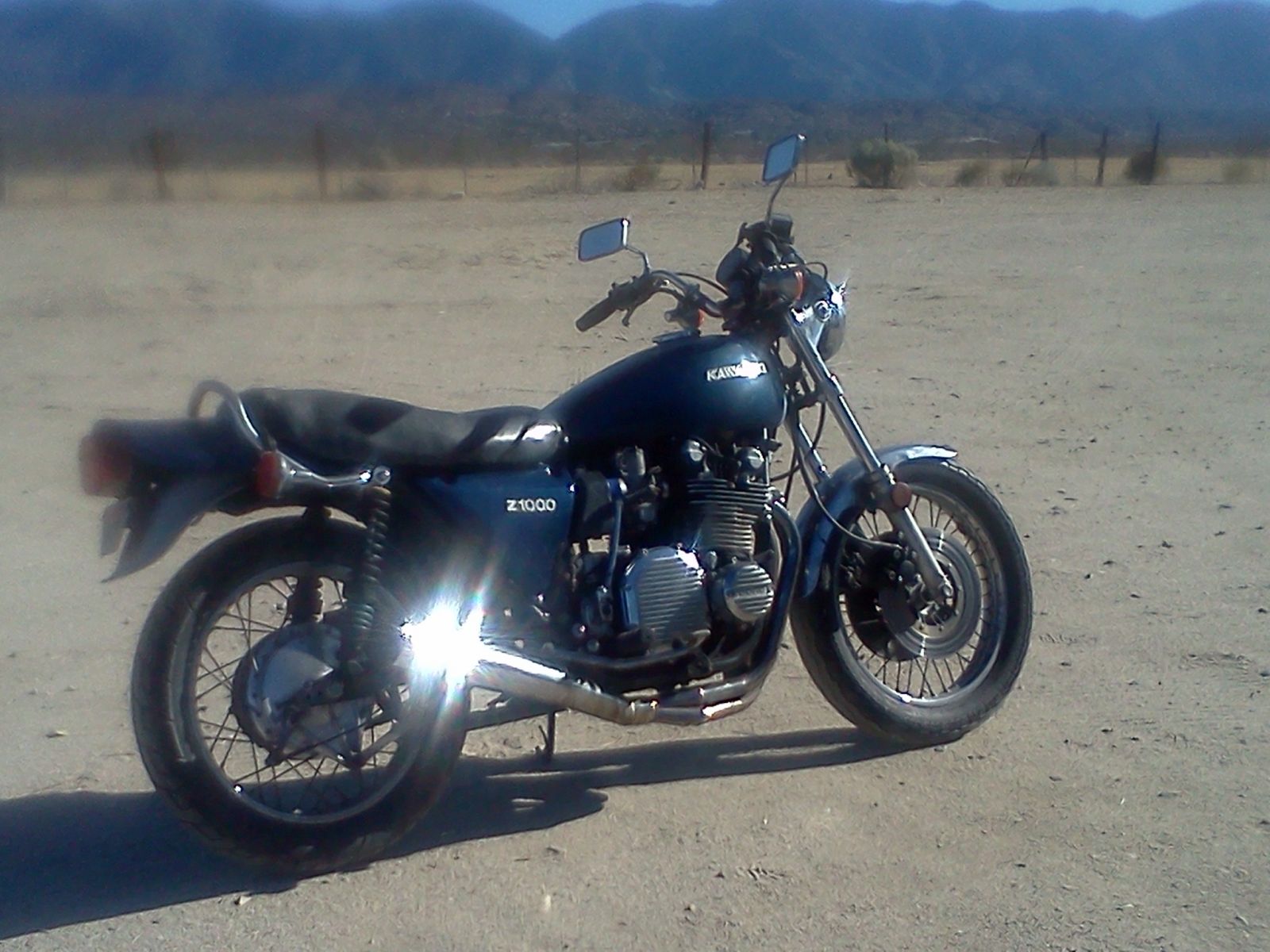

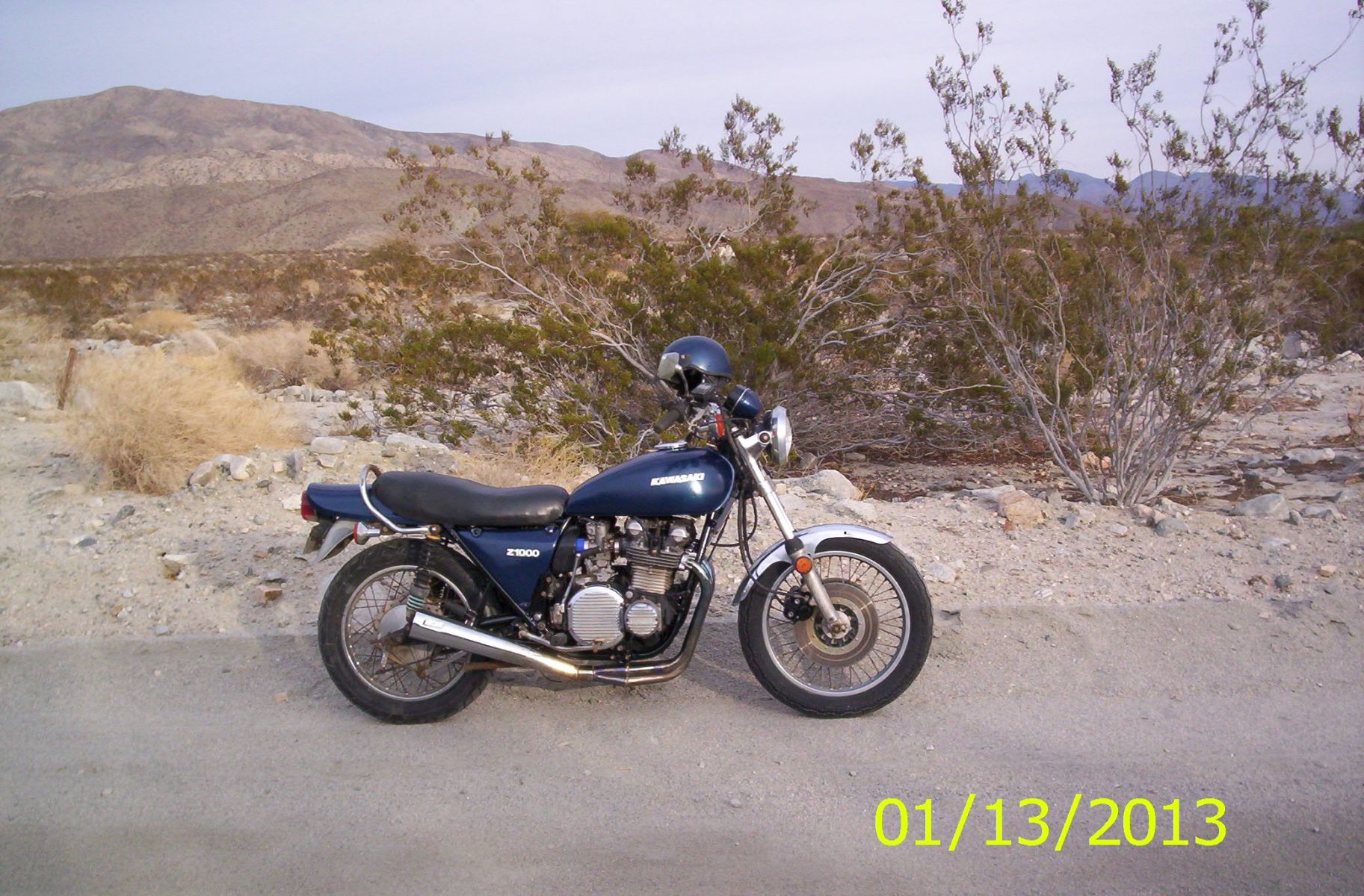

It's a 75 Z1. It sat under a tree for 15 years. Everything was tired. I'm in the desert so rust wasn't too bad. I'd start it up once in a while but no money. I painted the tank and side covers, then the tail. Started on polishing everything and painted the frame, calipers etc. Finally I had some money to spend on it. The DMV got $517. They wanted $666, I told them Fk no. I won't jinx this thing before I get it back on the road. I paid the new reg two months later. I bought all the cam componets, chain, bearings and tore into it. One piston was shot. Cast so no replacement was available. Another $500. I bought wheel bearings front and back, new signals(duel element), new front fender ($250), new seat, new grab bar, used rear fender from the old kaw man $45, transmission (eBay), All and all about $2500. I'm sure it's a lot more by now.
Attachment Bossieandthegirls.jpg not found
New parts from Z1E and z1partsinc. Used from eBay. On going project. When she was down all those years, I'd hear and see bikes going down Dillon road. MAN I've got to get my bike back on the road. Single parent, NO WAY. Now I'm a grandpa. Kayla says Bossie's awesome. They live 1.5 hours away in the high desert. I get to ride there once or twice a month. One day maybe soon, I can just point my head light and go. North or south, it doesn't matter. BTW, when I'm riding along in 5th and a crotch rocket comes along, blips his throttle, I drop down into 2nd and grab a hand full and bang back up through the gears. Now you have to catch me. One guy caught up to me and just shook his head. Didn't expect it from an old bike. It's all good.
