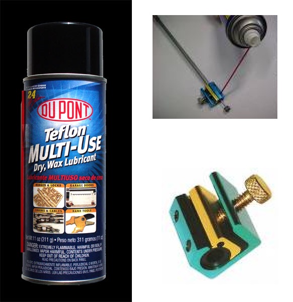

This method works for me. I've never had a broken cable on my KZ650. Ed

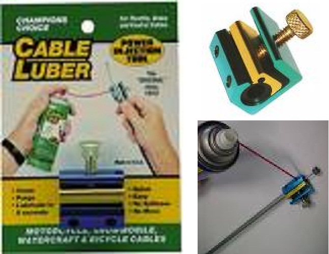

GOA forgot to mention every tool kit should have a cable luber. On my second one now.It could be an awful bloody mess otherwise. I do mine more often than you really need to though. Will have to look into that dry wax lube Ed.
."act in haste, repent in leisure" - very familiar ! Now it is slowly and carefully for me - dont like doing the same thing twice.
A year or 2 without lube is not bad - do you ride in all weather ?
