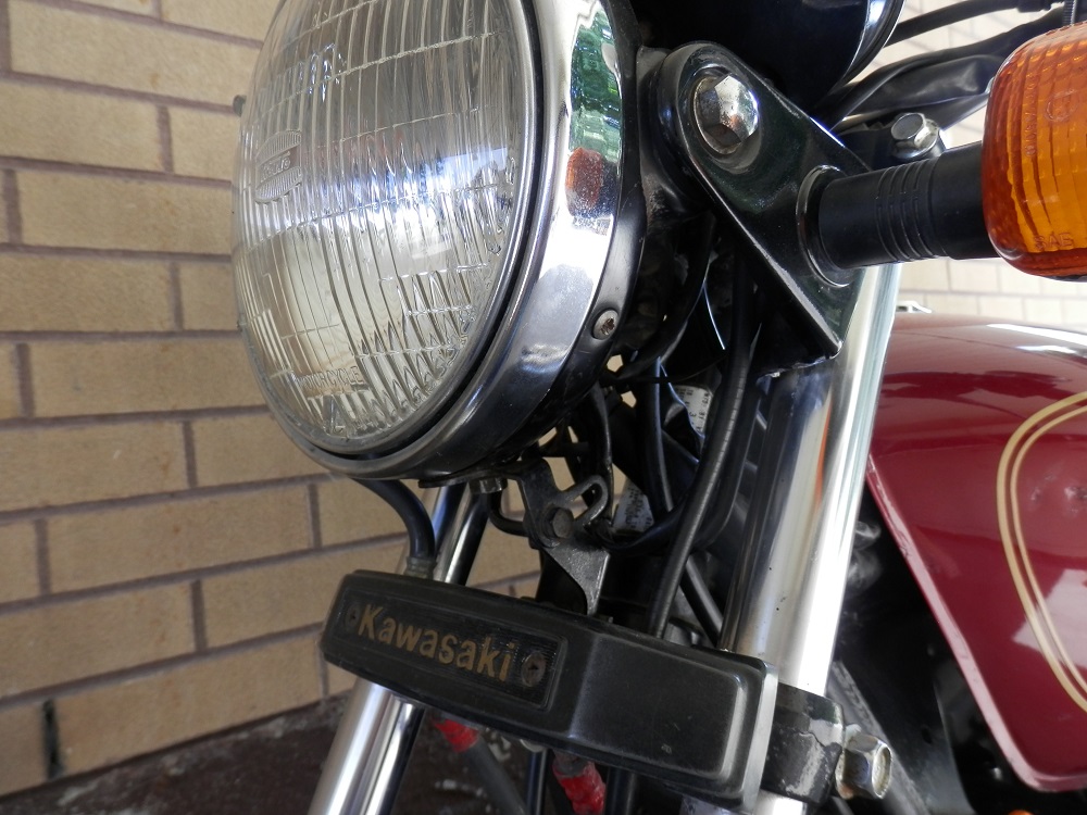

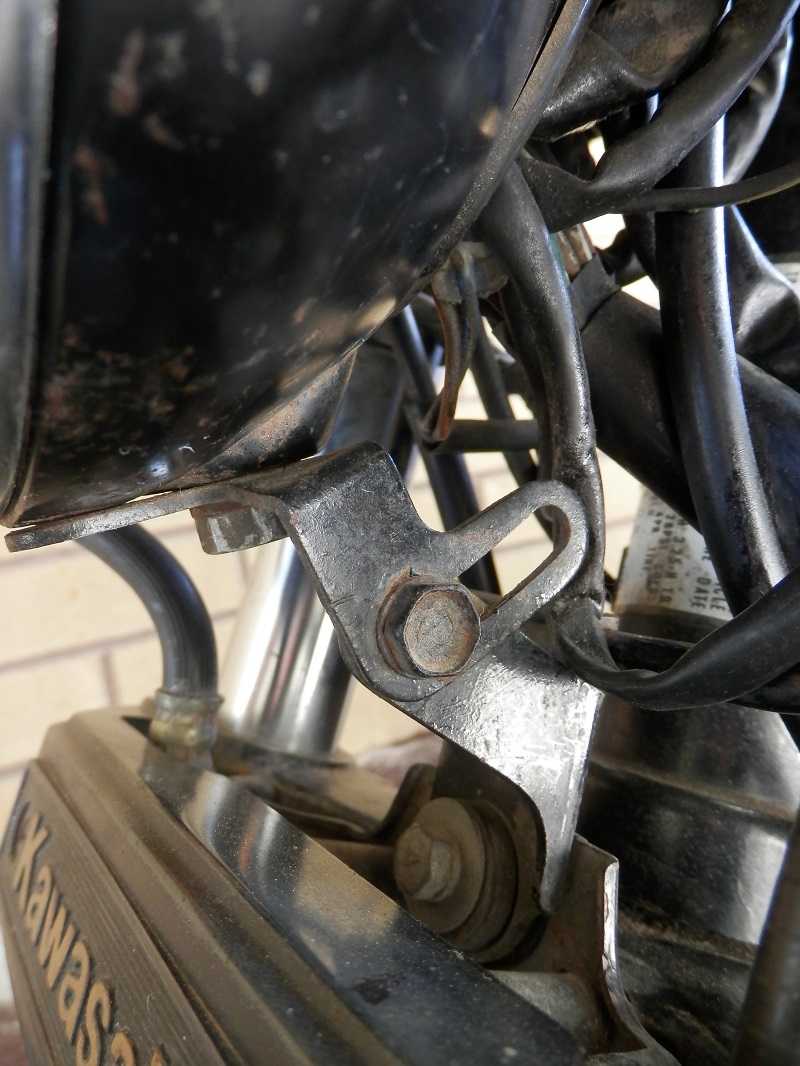

Here are some photos of my 1980 750E1.
In the first you can see the headlight bolted at 3 o clock (matching bolt at 9 o clock) with rubber dampers etc. Also bolted at the bottom to the mechanism that is used to set of=r adjust the angle of tilt.
The second photo shows a close up of the til mechanism and the attachment points. Hope this helps
In the first you can see the headlight bolted at 3 o clock (matching bolt at 9 o clock) with rubber dampers etc. Also bolted at the bottom to the mechanism that is used to set or adjust the angle of tilt.
The second photo shows a close up of the tilt mechanism and the attachment points. Hope this helps

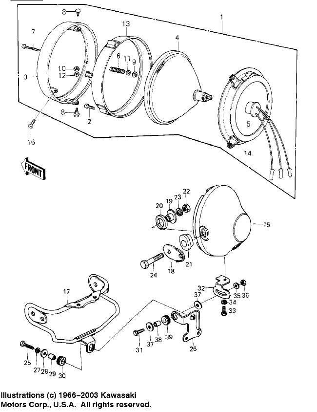

This was the only parts diagram I could find for you. I don't have a 750 so I don't know how different they are
kawasaki.com link
