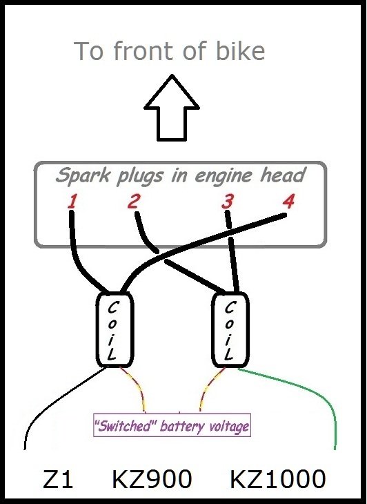

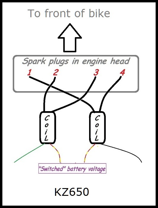

uglee wrote: Ok ebay is a hassle....are 1980 kz650 coils compatible? I kno i've read somewhere on here that the 650's fire differently....the other coils I was bidding on getting over my budget
Any dual output ignition coil with same resistance should be compatible.
The "fire differently" may refer to stock mounting of the 650 coils being reversed from stock mounting of large four coils.
Good Fortune! :)

Electrically the same, but may be physically different. The wires might be shorter on the 650, and the bolt spacing may be different. I know the 550 and 650 have different spacing, but not sure on the 900/1000.
