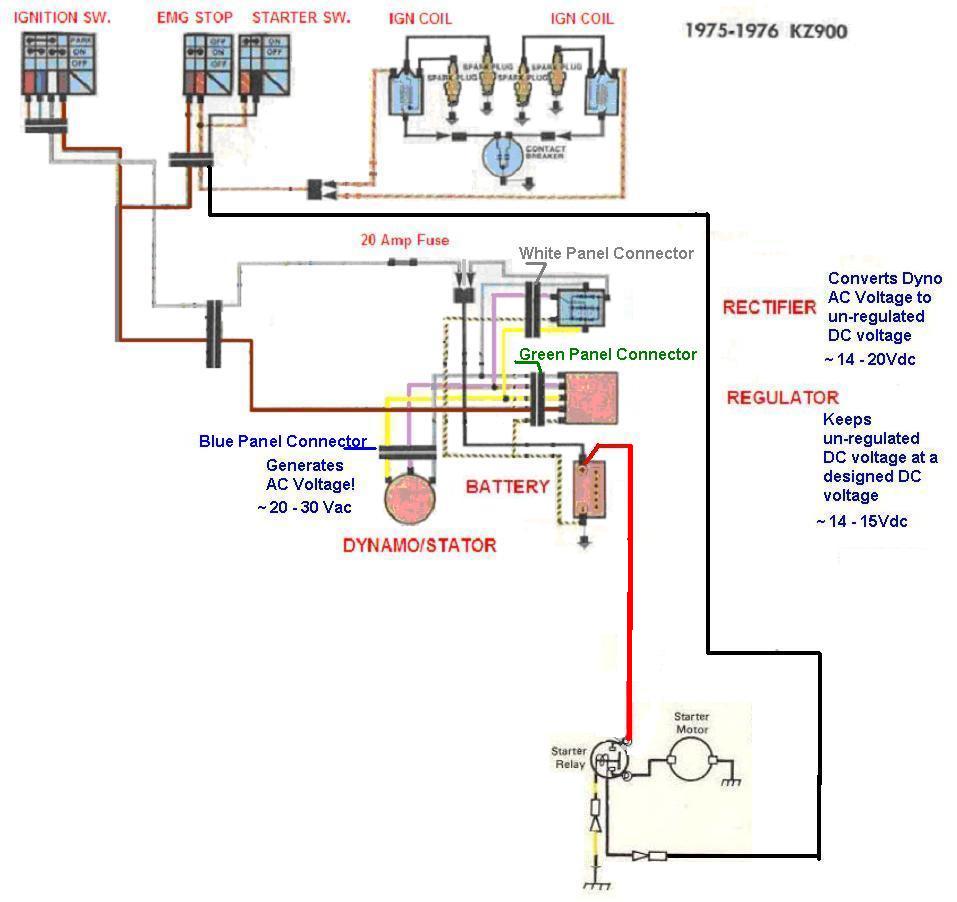

Hmmm, possibly both pickups are shorted (ground potential) thus both coils firing simultaneously equating to excessive current draws when +12Vdc is connected....
First insure engine case at same potential as battery ground (ideally grounded case).
Insure you have the Dyna/Coils wired correctly.
"red wire isnt hooked up from my magnet."... Not sure what this means "from Magnet"...?
'76 KZ900 pretty mcuh identical to the 78 1000...
In case you need for T-shooting...
Attachment DynaSBenchTest.JPG not found

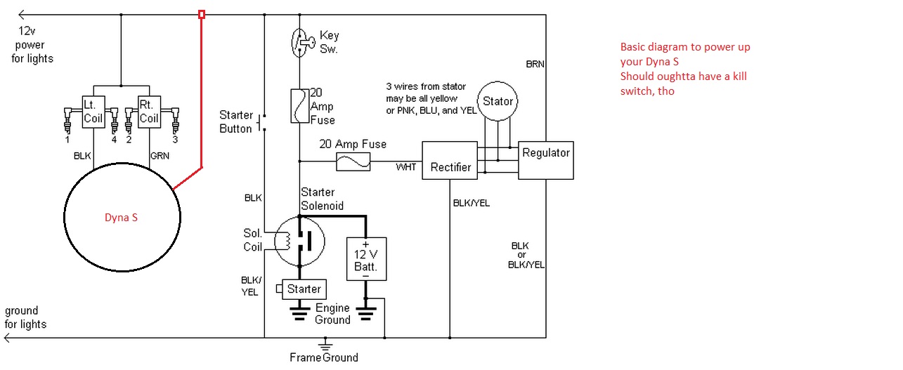

The "switched after your ignition switch" is referring to your KILL (or RUN/STOP) switch which is definitely a separate switch that you turn on to power your coils (and the DYNA S in this case).

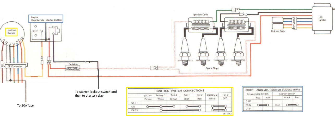

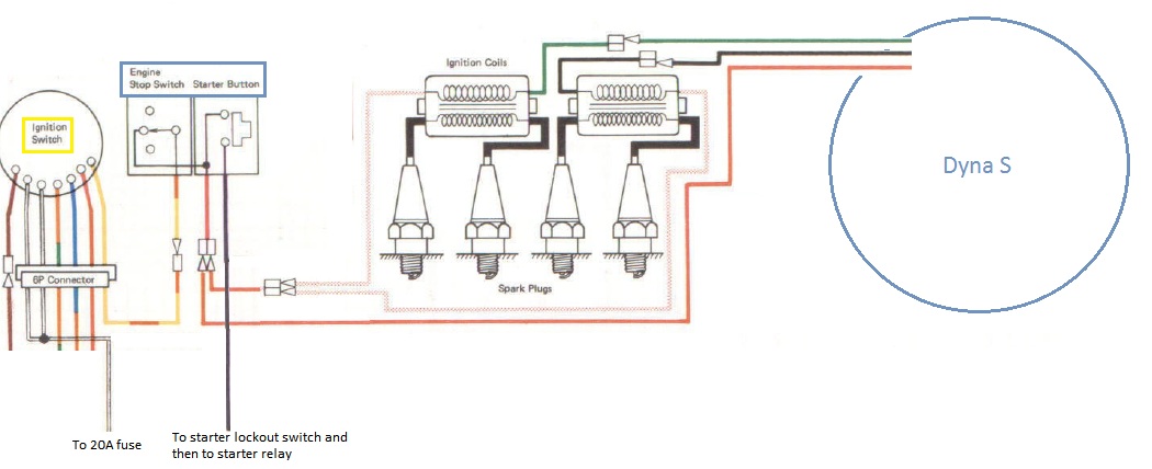

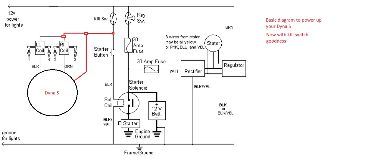

Let's stomp all over this!
Based on what you've written, I'm guessing you have the kill switch and starter button (the right handlebar control) so, here goes:
You rewired the bike per the barebones diagram but you still have some of the original wiring so let's see.
First, the stock setup for the control you have:
Now, that one with a Dyna S:
Now, the barebones modified to show the Dyna S (I'm guessing this is how it's sorta actually wired):
Now, the barebones with a kill switch included to show how using the kill switch should look:
