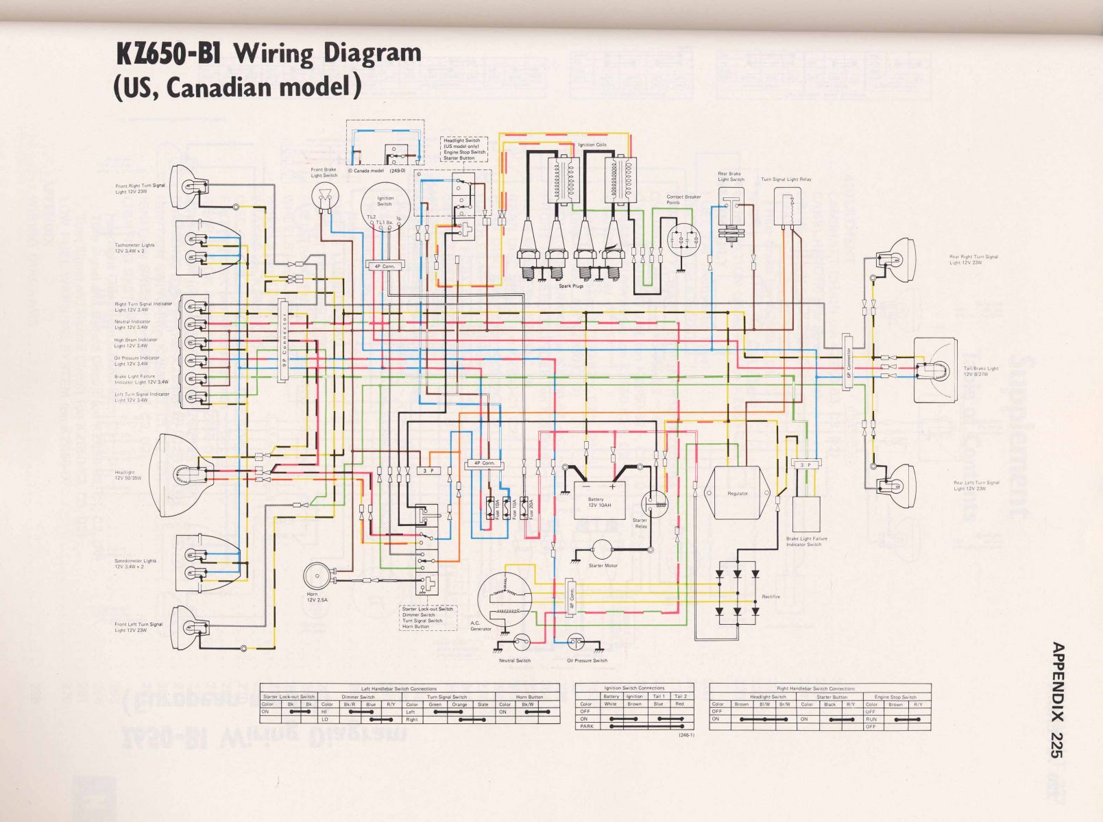

  • Old Man Rock
  • Old Man Rock's Avatar
  • Posts: 6071
  • Thanks: 225
Re: Blowing fuses
17 Jul 2011 21:50
#463403
Possibly these will help... FREE!!!
KZ 650 OEM Service manual:
KZ650 Manual

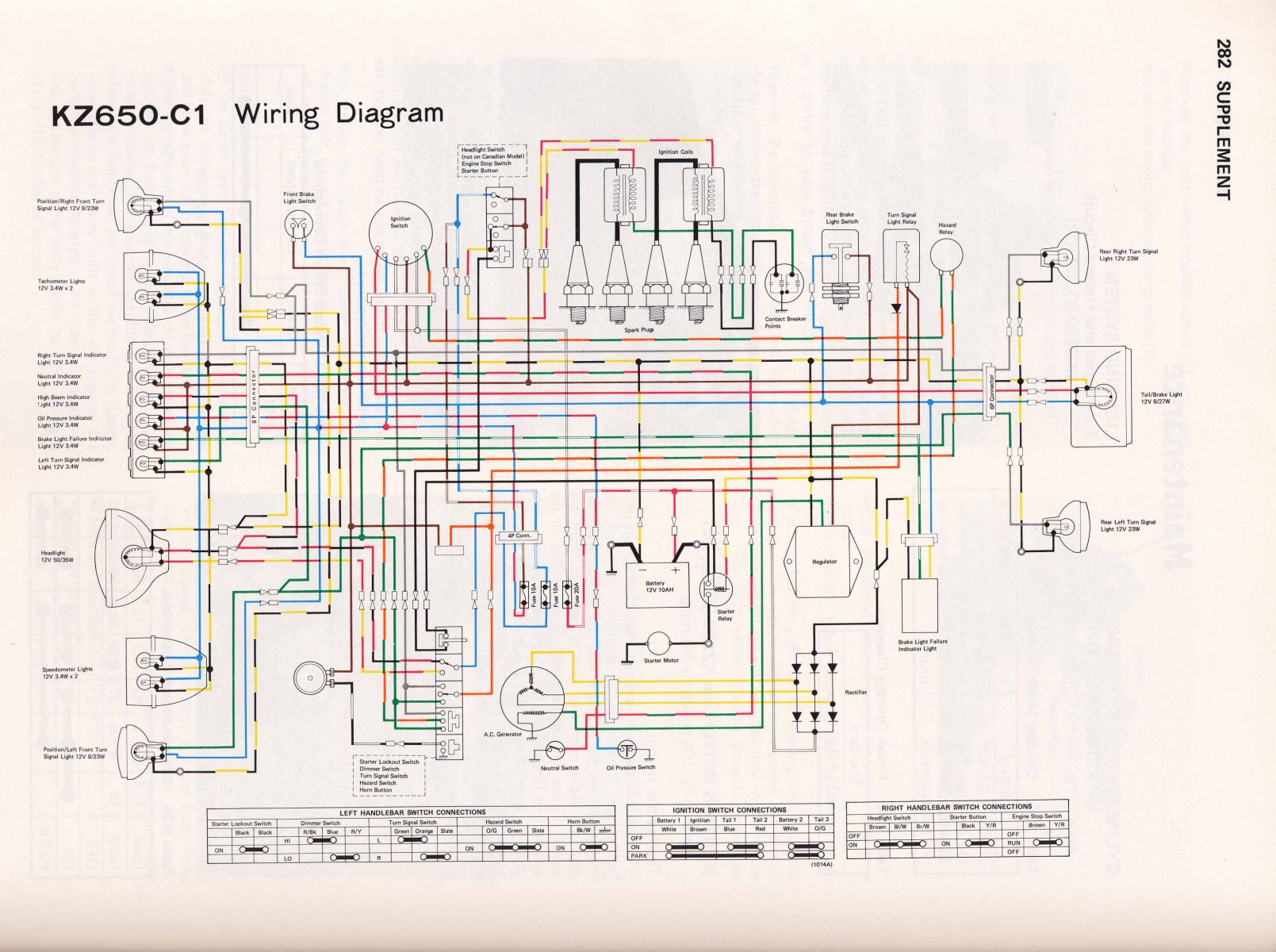

  • uncledirt
  • uncledirt's Avatar
  • Posts: 54
  • Thanks: 0
Re: Blowing fuses
17 Jul 2011 23:28
#463424
Rock, I went everywhere on that site (cool site) and I can't find that c1 wiring diagram. I can't save picture so I went there to get it myself and for the life of me, C1 model seems to be the only one not listed?
77 KZ650 'C'
Bachelors know more about women than married men; if they didn't they'd be married too.
  • 650ed
  • 650ed's Avatar
  • Posts: 15334
  • Thanks: 2832
Re: Blowing fuses
17 Jul 2011 23:33
#463425
uncledirt wrote: Rock, I went everywhere on that site (cool site) and I can't find that c1 wiring diagram. I can't save picture so I went there to get it myself and for the life of me, C1 model seems to be the only one not listed?
Here's the KZ650-C1 wiring diagram:
diagrams.kz650.info/wiring/images/KZ650-C1.jpg
