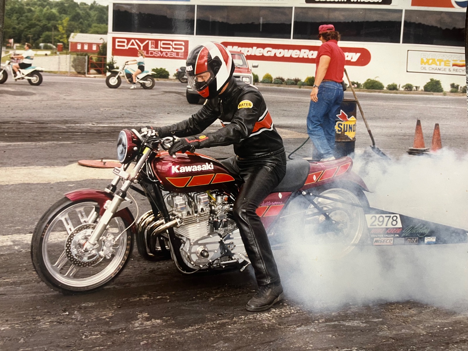

As a point of reference, I've included a pic of the small tire bike that I ran before the turbo bike in my avatar. 1327cc, 10.25 to 1 pistons, stock-size stainless valves, MkII head with mild porting to match the .380 lift Megacycle cams, and 33mm Mikuni smoothbores. The bike would reliably run mid-9's all day long (my race weight was approx 185lb back then). I'd also run it in Super Gas (9.90 index) at the Prostar races with a little detuning.
So, to answer your original question, Southpaw, I'd say that your J-head with mild porting would suit your needs. And, I'd have no problem running those "mild" .395" lift cams. Use some of the $$$$ saved and buy some shim under buckets for those cams, if you don't have them already, for added reliability. Again, just my opinion. Take it for what it's worth.
