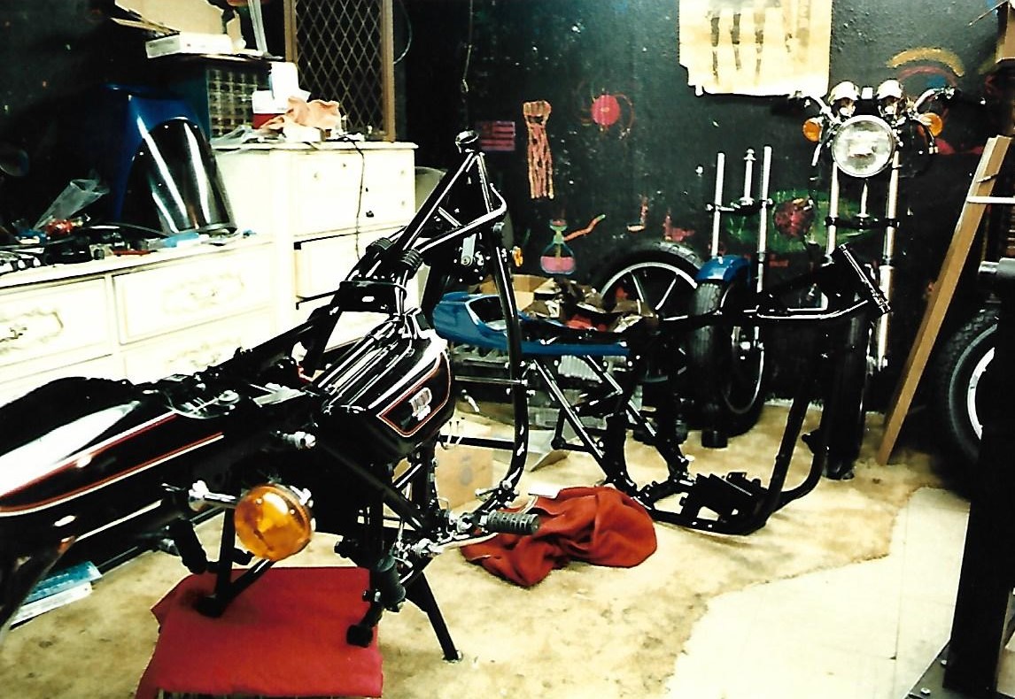

I dont know how close you look at these pictures , but in my workshop are 2 bikes , not one .
My LTD becoming a Turbo and my friend Teds 78 Z1R on its first complete rebuild .
It has a ATP Turbo on his and a Mr Turbo on mine .
It was a great winter that year working on our two projects together

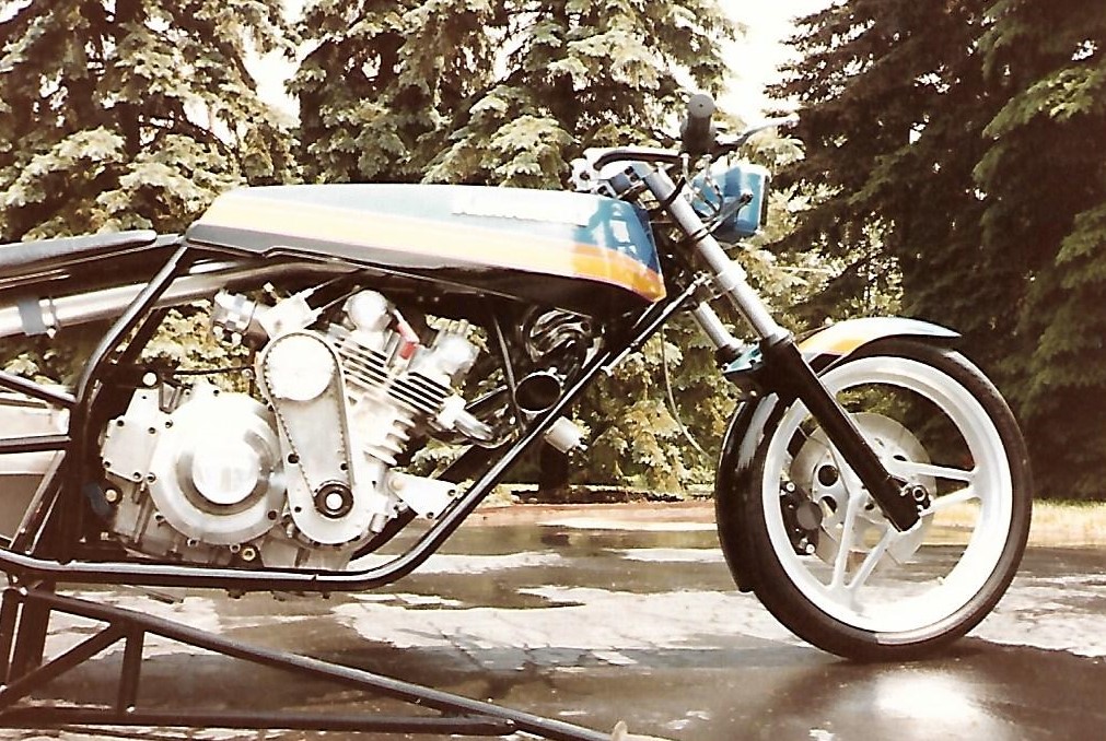

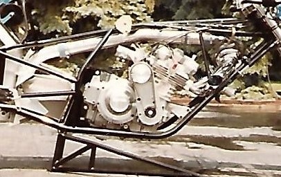

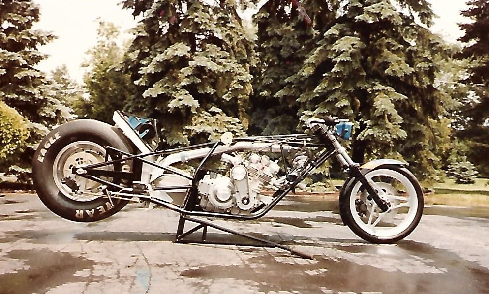

When the Big Digger first appeared at Kevins House He played around with a centrifical supercharger mounted up front where you now see the turbo.
Then we went twith the turbo setup like Bill Hahn was running with great success. Kevin also played around with the large intercooler just
in front of the rear slick ( Look closely ). We also ran a KMS ( Jerry Korman ) 3 and 4 speed drag only transmission . No down shifting possible
with this set up.

Hey Dave - great pics! Was Big Digger fuel injected on alcohol? Injected turbo/alky is the classic F/B combo but I don't want to assume anything.... Thanks again.

Hey Mike
Yes the Big Digger has Hilborn mechanical Injectors. Running Alky and Tip the can with Nitro
Kinsler set up the injection for the bike.

Good stuff - thanks Dave! You wonder how many sprint cars that are out there running Kinsler/Hilborn setups? The gold standard of the day, for sure.

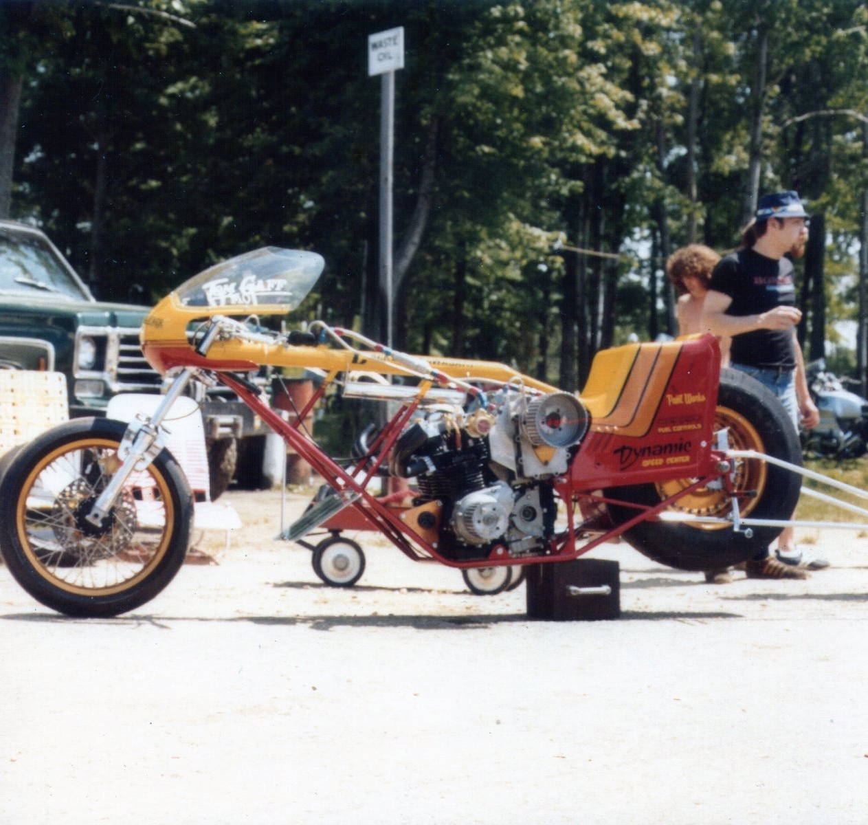

Kevin " the Taxi Driver" and his dad were cool people for sure.
Another Detroit area Digger that never lived up to it's potential was out there a little before Kevin.
