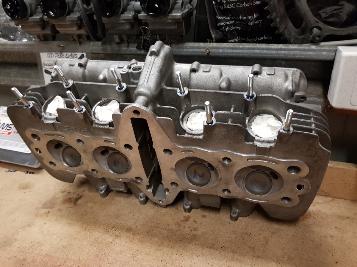

Z750 head all done...
Thanks for the reference to the article, I'll check it out. Curious about milling the head, especially as its on the bench now, but I'm not an engine builder or mechanic, I just work this stuff out as I go along. I'm nearly 60 and am still working it out
My dyno guys machine reads fuel/air mixtures, probably the most useful feature.

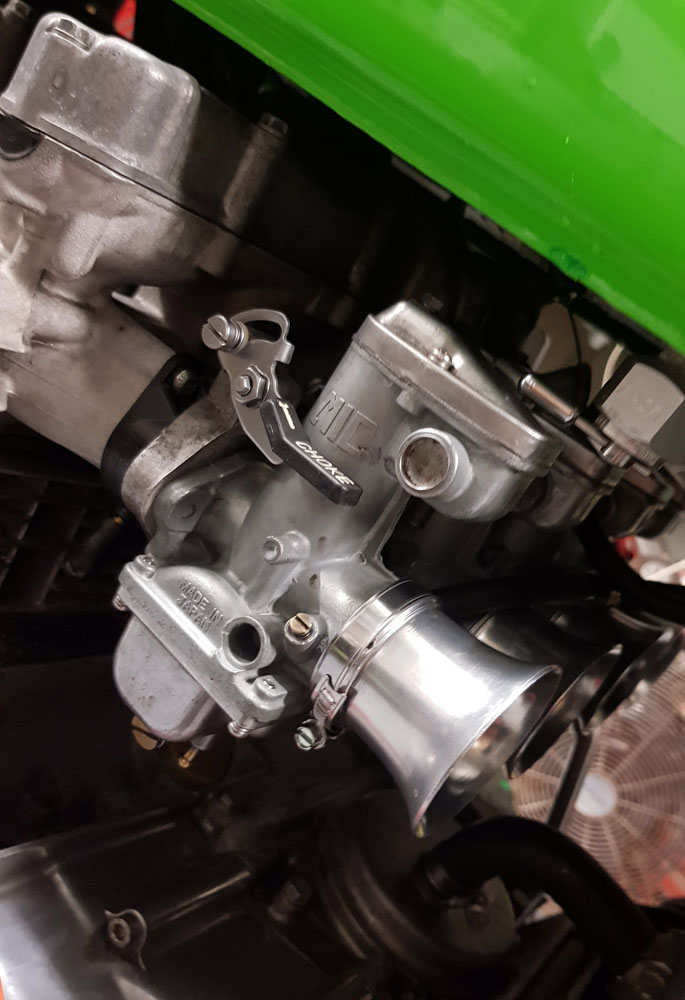

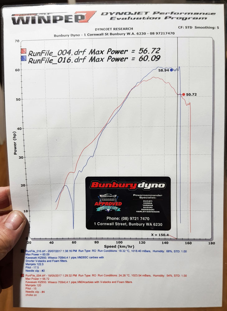

So the Z1 VM28SC carbs are on, with short stacks and foam RamAir filters over. I had a dyno run to check the jetting and all is well.
I guessed a 122.5 main which turned out to be spot on.
With a 17.5 pilot and needles on 2nd it is lean in the first 50% of throttle which I'll have a look into.
Dyno shows only a few more horsepower, but it seems to be a lot more useable. The power would peak and then drop off quickly with the VM24SS carbs, now it peaks and holds until who know what revs. This means I may save a gear change, or win a drag race to the finish line
Next are the cams which when they come I hope will make a noticeable difference.

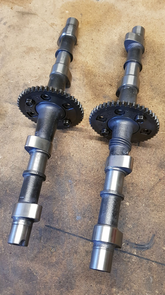

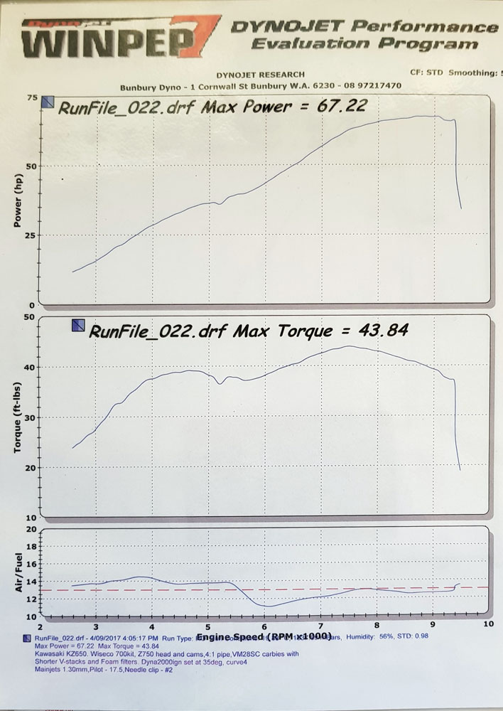

04 Sep 2017 02:23 - 04 Sep 2017 18:43I have a set of reground cams on the bench which are the next thing, but as I'll have to check the valve/piston clearances I will try and wait until the end of the season. The quest continues ....
Z650B
Wiseco 700 kit
KZ750 Head and cams
Home made 4 into 1
Dyna 2000 ignition; curve 4, 9500 rpm limiter, 35 degrees advance, B7ES plugs
Z1 carbs, VM28SC with short stacks and foam overs. 1.30mm mains, 17.5 pilot, 1.0 slides, needle 2nd clip
(Sitting on the bench) Custom grind cams, “#253B that is 282 adv, 251@0.50” and .375” cam lift”
