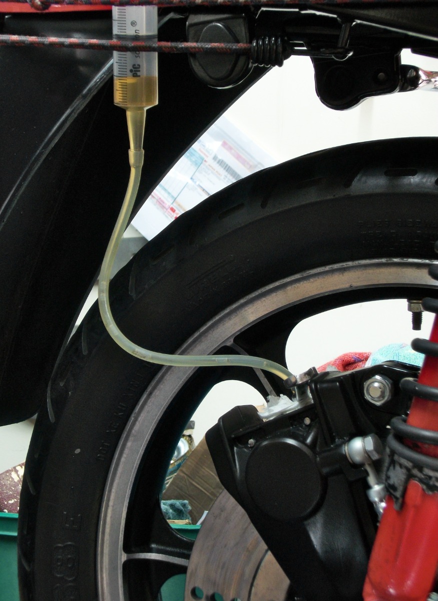

24 Jun 2022 16:08 - 24 Jun 2022 16:14Good point ckahleer, a three Dollar 100 ccm syringe i use to bleeding the break system can vaccumise and pressurise the bleeding process of the brake system. No need to buy expecive special tools. You only have to to remove/clean the break fluid from the piston or the rubber part will swell up and sized in the syringe cylinder!I some times reverse fill the brake system using a 60cc syringe filled with brake fluid. Start with little or no fluid in the mc resiver and push the 60cc of fluid through the slave bleed port.

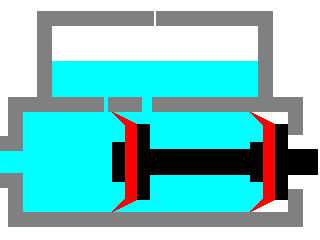

A common problem when bleeding is getting the caliper pistons in the proper position, close to the disc. Unless the caliper piston moves close, into its proper position, the hand lever will feel spongy. Also, you need to prime the master before it will build pressure. And, as mentioned by others, if the small return port is plugged, you will never have properly working brakes.

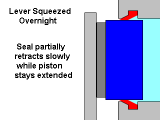

If all this is done and the system still won't build pressure like it should, then pump the lever and tie it back overnight. This will force the piston to creep forward, toward the disc, and then the lever will firm up.

DoctoRod made a genius animated GIF to explain the MC operation, bleeding, relief port and piston seal ring reset over night.
Normal operation MC
Bleeding operation MC
Normal operation MC
