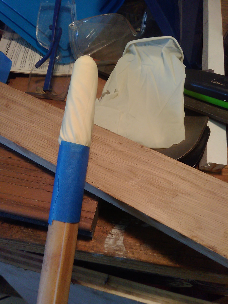

I've done a few fork seal jobs and never needed to make a broom stick style tool but I finally had trouble with one spinning on my wife's Yamaha and needed one
So here is my version using latex glove fingers to help grab metal and it worked well.

14 Feb 2020 18:34Ouch, that's hard rockminer, and on Valentines Day no less, but funny none the less.hardrockminer wrote: I gave the broomstick back to my wife. She's flying in a couple of days.

If I ever find a fork with a condom in it I'll know who rebuilt it!
