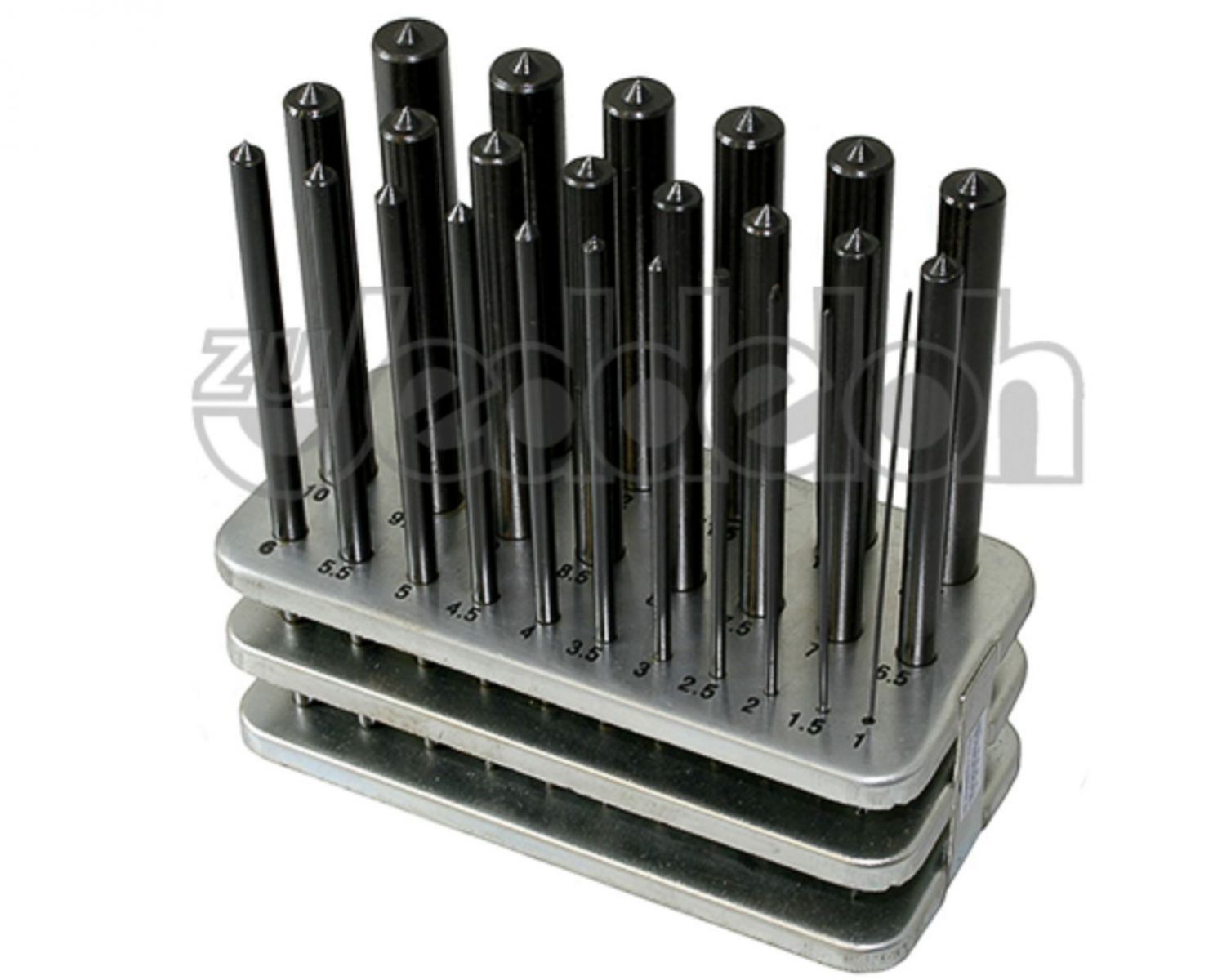

For a good centered bore i use special center punches (a broken cam cap bolt).
Static or adjustable center punches dependent of the bore diameter.
and than a counter clockwise drill bit, mostly the broken part of the threat came out easily during this process!!!
