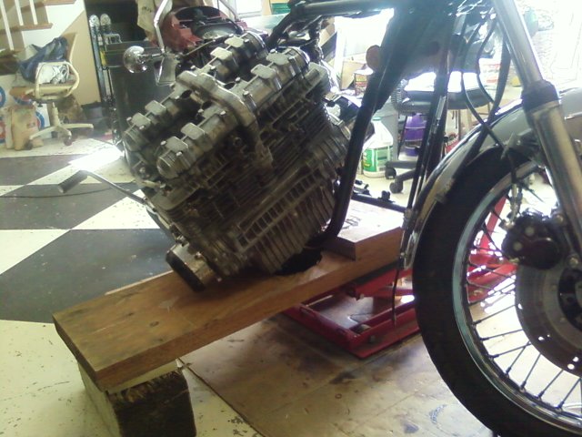

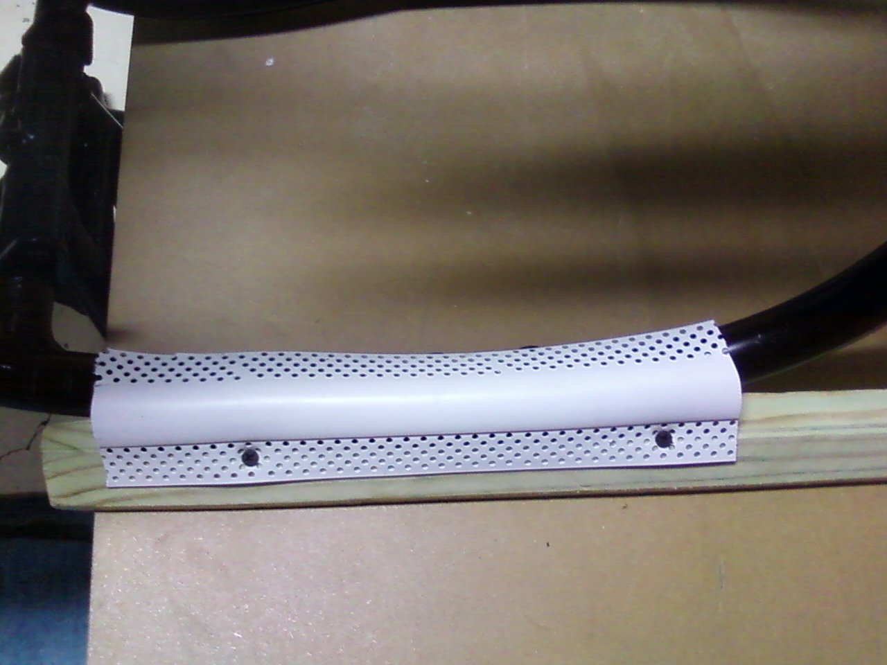

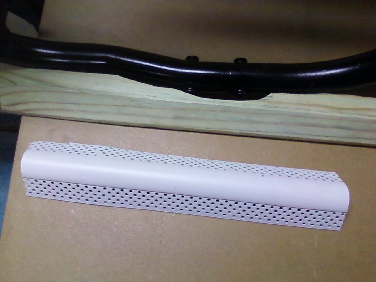

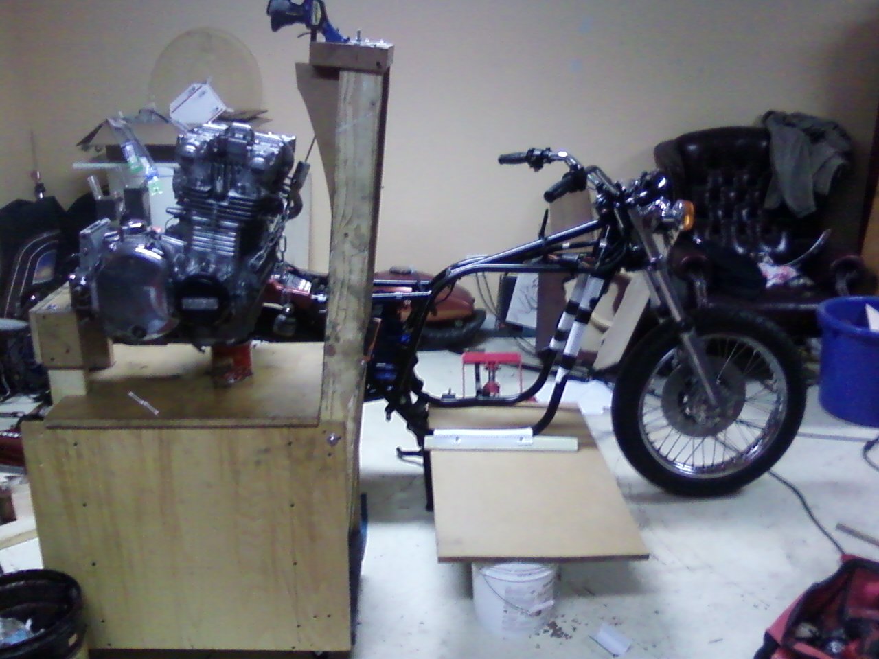

This is how I do it.
www.kzrider.com/forum/2-engine/489872-ho...ved-my-engine#489872
I have refined my method over the years by removing the oil plug and adding protection for the frame, but it works real good for doing it by your self.
