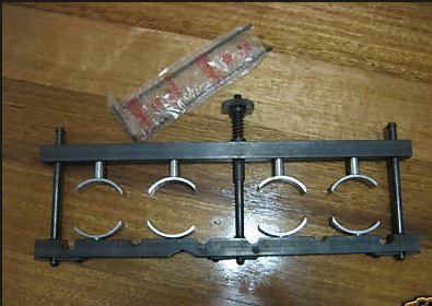

I have never seen one of these special ring compressor tools for the 900 or 1000 cc Kawasaki's. I assume the original "sandwiched" around all four pistons at once and was made of steel yes? If so, couldn't one of these tools be made of one piece of Delrin with the cylinder bores in the proper orientation and then split the Delrin into two pieces to clamp around the piston rings. I am just thinking outside the box here and may be someone has already tried this approach, but Delrin is pretty tough material and should last for quite a while. If anyone has one of these OEM tools and can post a couple of pictures of it I can pass it by a friend I have that's a machinist in a mold making facility. Delrin is really easy to fabricate things with.

19 May 2019 13:03Rick H. wrote: ................. If anyone has one of these OEM tools and can post a couple of pictures of it I can pass it by a friend I have that's a machinist in a mold making facility. ...........
Rick H.
Here's what it looks like..............
The following user(s) said Thank You: Rick H.
