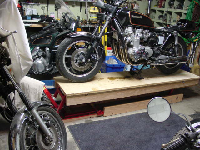

I made one following a design Breeze used.
Just put it together with wood I had in the garage.
Has been very useful:

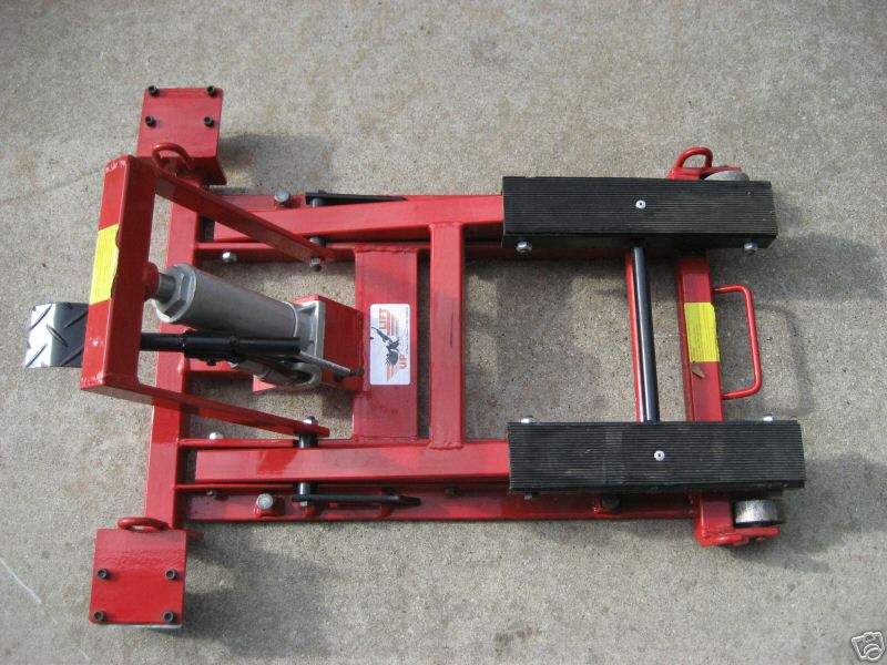

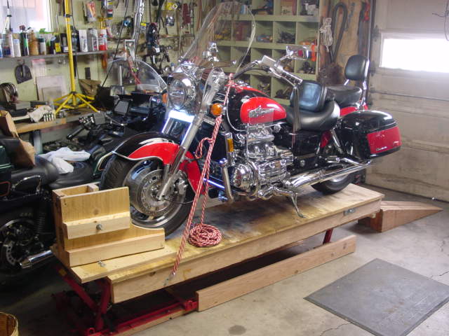

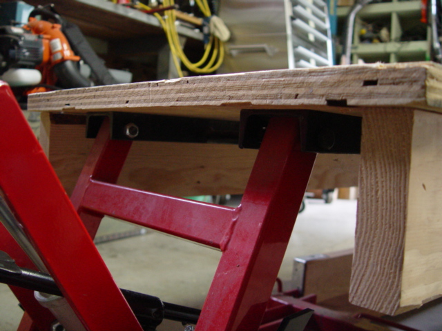

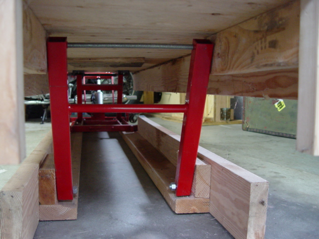

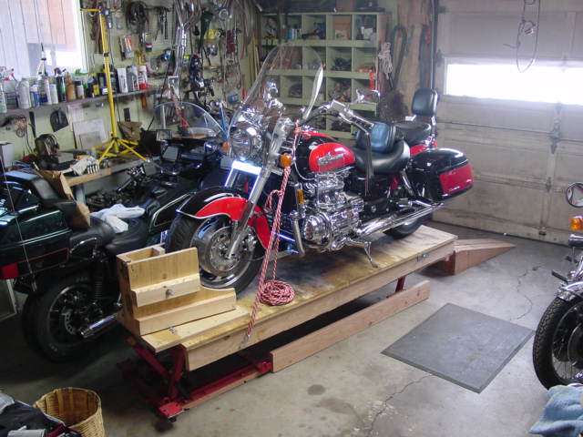

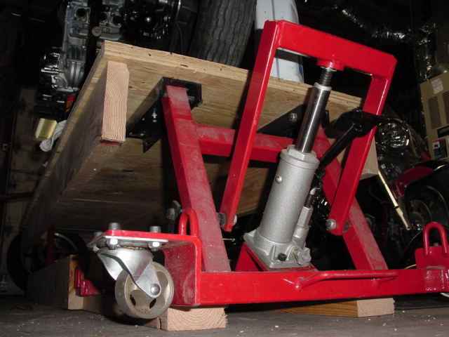

Wasn't able to find the last thread that I posted so here it is again. The idea's similar to Kawickrice's.
Started with this cheap/dangerous lift.
Even lifts the Valk.
No Plans, Just pics.
Bill
Attachment Stand02.JPG not found
Bill

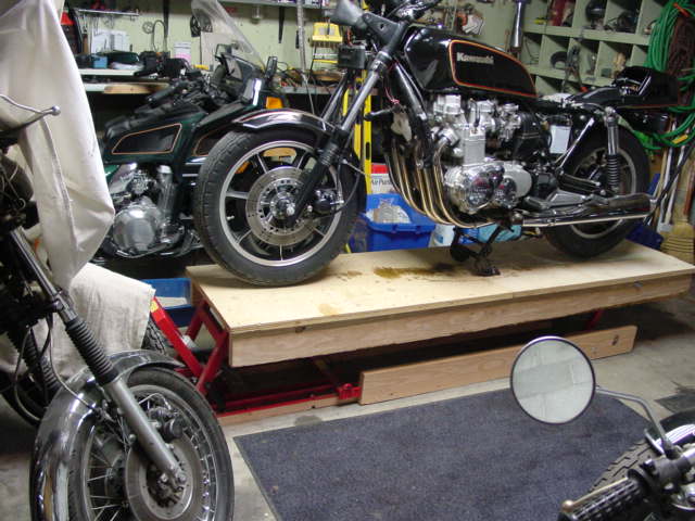

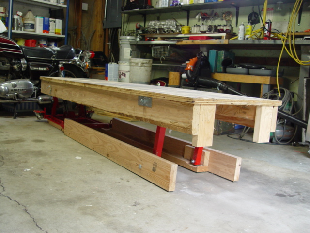

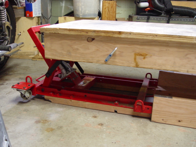

Made this with 2x4 and 3/4" plywood. Used scrap wood and may be 80-90 bucks in it for hinges, bolts, casters etc.Raise and lower it with old VW jack. Secure hinged legs with bolts when it is up. Move it around is easy with casters yet it is steady when casters are locked.

Made a hole thinking may need extra space under motor sometimes. Usually keep it closed.
Somethings can be done easier if it is high like yours, Tri. Me being small build, I just can't push it up that high:laugh: .
Hole closed,
very interesting...i like the hole in the bencha dn have considered one myself...loota things going on on that bench aye tybolt.....a thinking mans creation ,all of em really...bills and everyones show each persons experience with cycles and what they are thinking is gonna make the project "theirs"...take mine for example...with my ironworker background and being in the coutry...i ended up building a square looking overbuilt weather proof junker....
your guys benches are more precdise and beautiful compared...
but both are their creaters example of perfect benches...more pics from folks -please
Hole closed,
