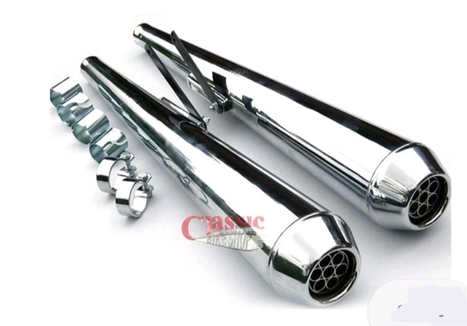

If your stock down pipes are still good and you want to stay with OEM look then the Dunstall style ones are very close to the originals.
ebay.io/m/qdz2Pf
ebay.io/m/qdz2Pf
Wow there's a blast from the past - Dunstall "power pipes"
