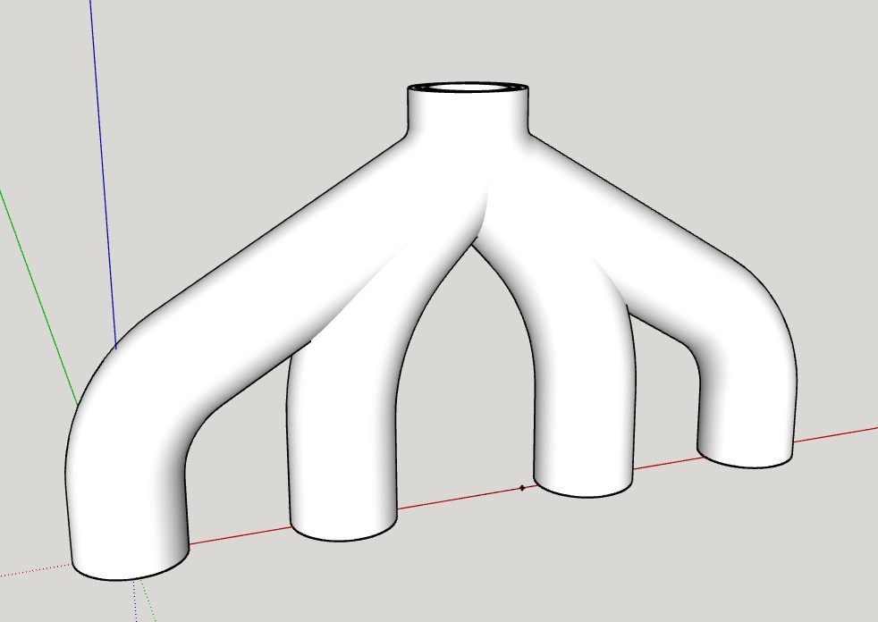

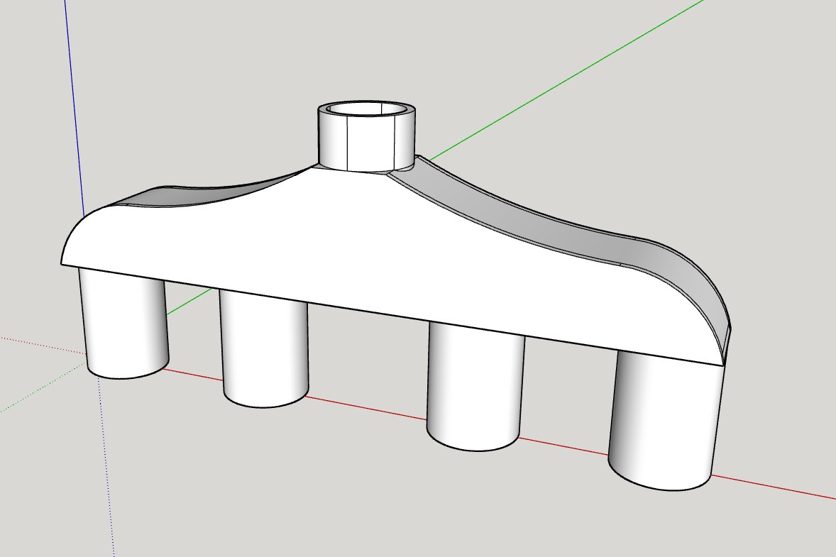

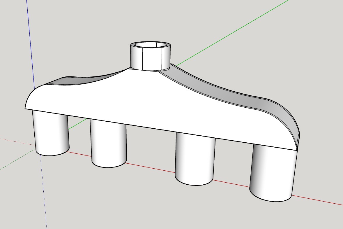

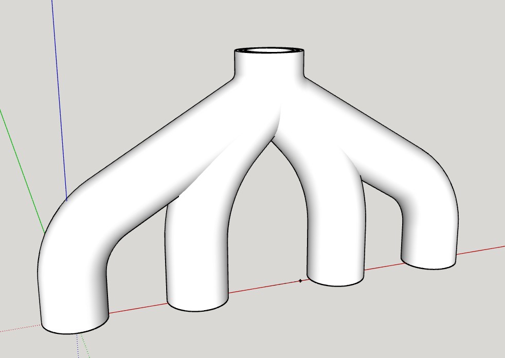

The main reasons for a single injector at the throttle body is the ability to use the stock ignition triggers and because the strokes are evenly distributed (180° apart), there will only ever be 1 cylinder on it's intake stroke are any one time, so fuel distribution shouldn't be an issue. The biggest challenge with a custom intake and limited space is keeping the runner length as close as possible, this is where the design of the plenum is important.
maybe sonthing simmilar to this, just remember this is a rough idea, spent 20 minutes on it.

How are you going to fabricate the manifold?
I designed a plenum for a roots supercharger I was going to use on a Z1 drag bike but I abandoned that project and sold everything. I figured out my engine needed to be 300cc larger to run that blower efficiently.
Any NA design on the intake side needs to be equal length and smooth transitions, much more so than forced induction. You still need to have clear separations at the one to four junction. The second picture is getting close but is only achievable as a welded tube structure.

05 May 2026 05:18I'll be 3D printing it in ASA or ABS to start and when I'm happy with it, I'll probably get it metal 3D printed.How are you going to fabricate the manifold?
I'm doing this for shits and giggles, not racing or anything like that, I just want to see if I can build a fully reversable working system, as easyily and cheaply as possible and one that will hold a decent tune.

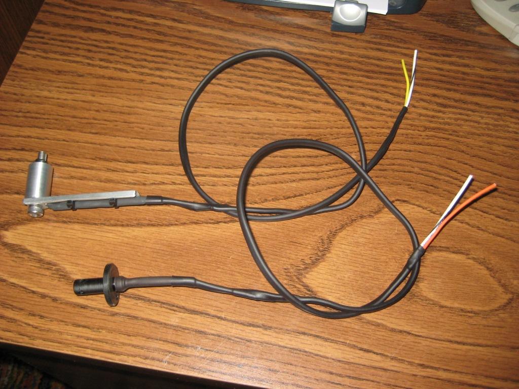

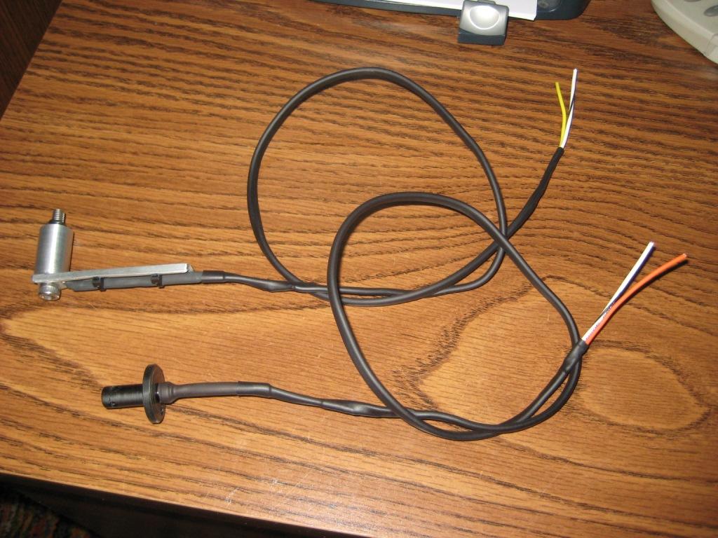

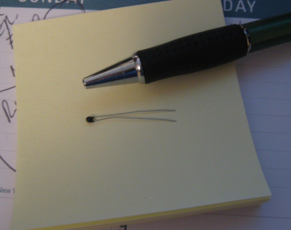

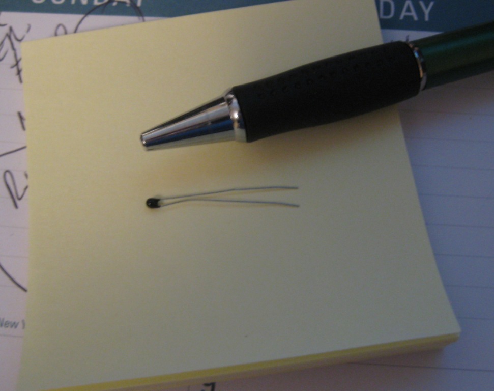

On one of my builds I am converting a KZ650 to run fuel injection using GPZ1100 throttle bodies. I am not using anything else from the GPZ1100 so I needed to come up with my own sensors.
I was able to use NTC Thermistors for both the intake air temperature and the cylinder head temperature sensors. Pretty easy to wire up and put in a self fabricated housing plus they cost next to nothing.

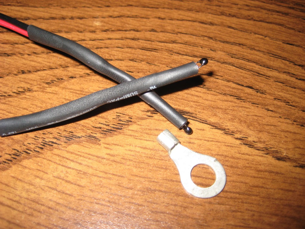

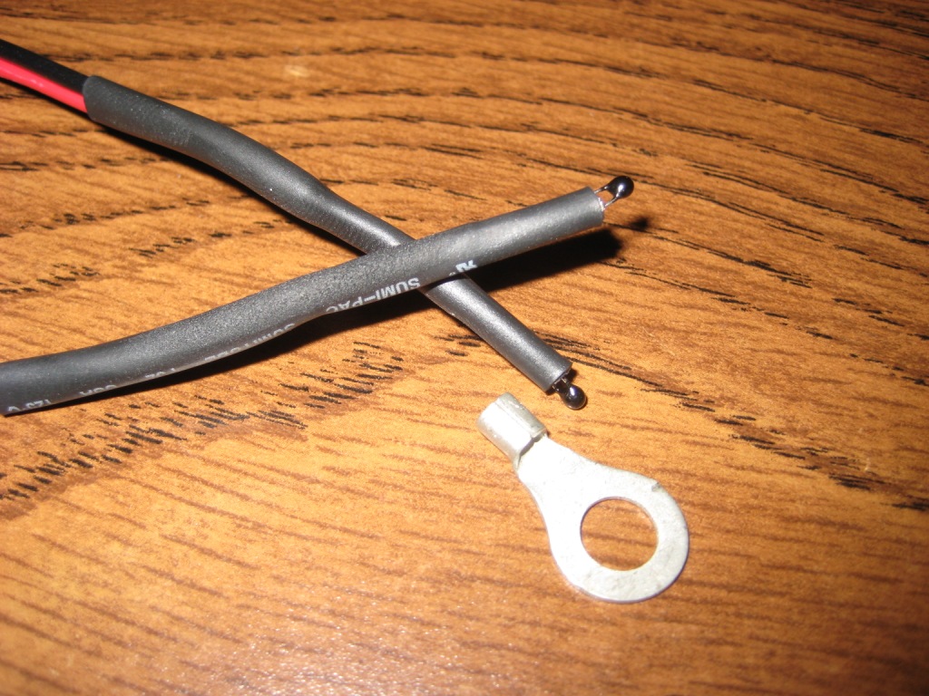

05 May 2026 11:07 - 05 May 2026 11:11On one of my builds I am converting a KZ650 to run fuel injection using GPZ1100 throttle bodies. I am not using anything else from the GPZ1100 so I needed to come up with my own sensors.
They look spot on.
Did you just crimp the terminal over it and bolt it down under a valve cover bolt?

05 May 2026 15:29Yes it was crimped but very lightly then secured further with heat shrink. I was afraid I would crush it so I measured it and ground a nail the same size to slip in the the end of the lug ID then crimped. The heat shrink sealed the end off, that is why I have it zip tied to that aluminum piece so it does not get yanked out. The round aluminum is a stand off for the sensor mount location on the head.On one of my builds I am converting a KZ650 to run fuel injection using GPZ1100 throttle bodies. I am not using anything else from the GPZ1100 so I needed to come up with my own sensors.
They look spot on.

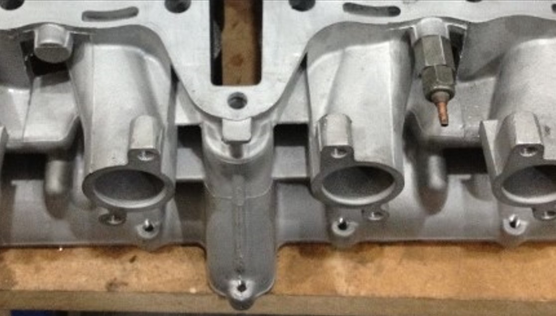

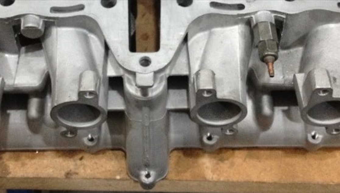

I am using a later 750 Spectre head that has the same cast lugs on it as the GPZ750 Turbo only its not drilled and tapped. Below is a pic of the temperature fitting on a turbo head.
