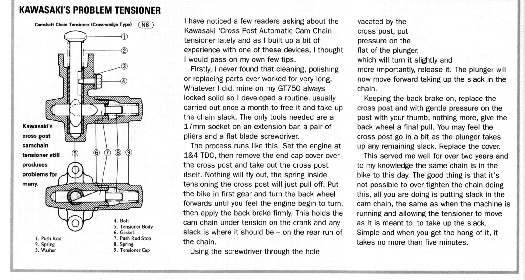

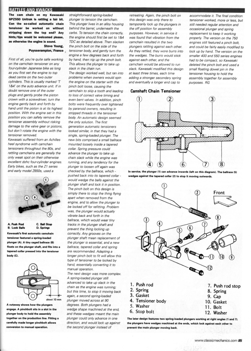

As others indicated the chain may be out of recommended life. Not sure that this will be of any help or not, but here are a couple of docs speaking about the stock adjusters for the 650s.

highly informative reply, thank you ! ....since my 650 engine is of the 1983 model year, and with Kawasaki revising the design at least 3 times for the auto tensioner, I'm not sure what plungers and, more importantly: springs PartZilla will be sending me but of course once the tensioner is of the engine & in pieces (but I did order what corresponded to my exact bike & motor: 1983 CSR 650 - H3, as far as there 2 plungers & 2 springs go), I'm assuming I'll know what's what comparing what got removed to what was sent to me as replacements ....I'm also assuming having to get the 1 & 4 to TDC is not required for my 1983 auto tensioner removal & rebuild, I can simply remove it and just make sure the engine internals do no advance nor move in any way .....correct ? ......looks like I'll have to get into my big book in the not too distant and see what is involved in replacing the cam chain, and of course I'm assuming the engine is off the bike and on my bench to do so .....correct ? thanks again !

I have found that the later model (82 and up) 650/750 OEM auto cam chain plunger parts can get wear grooves in the angled ends of the plungers. If the wear is significant it can cause the plungers to stick and not allow them to move forward automatically as intended.
When removing the cams for shim service this inability to adjust may cause the cam timing to alter which could cause valve train damage. If you have doubts about the tensioner check the cam timing by hand several times before starting the engine.
The earlier model 650 tensioners seem to be the best as they do not employ the angled ends or multiple plungers. Kawasaki seemed to "over engineer" this part.
I have a '82 750 engine in my 650 and I ended up modifying the tensioner to work as a manual type instead of replacing the parts. I eventually replaced the bulky modified tensioner with a much smaller manual tensioner mainly for float bowl removal.

tensioner. the fsm has removal/installation/service-limit info. plus a number of cautions. there is an 81 pdf. the later supplements don't have any tensioner info.
bolt. no adjustment. the side bolt prevents the pushrod from falling into the engine. also, when valve cover is removed and crankshaft is turned, the pushrod will move forward. so before re-installing the valve cover, remove the cross-wedge. then install the cover. then re-install the cross-wedge and spring; be sure to do the check noted in the manual to verify it isn't sticking out too far. alternatively, before removing the valve cover. a longer dog bolt could be installed in place of the -1155 bolt to lock the pushrod. but even doing that, I would still remove the cross-wedge to reset the tensioner.

On the liter bikes, the cap and cross wedge have to be removed for installation. That allows the main plunger to fully retract.
