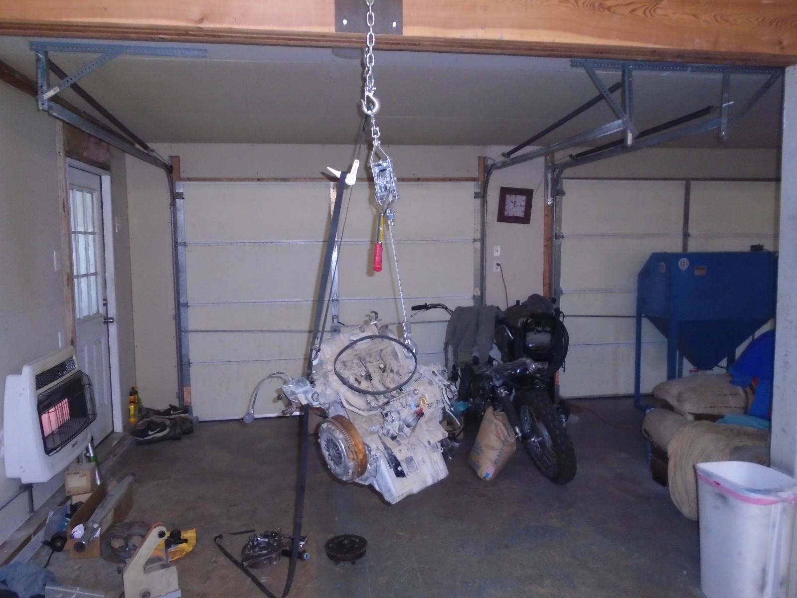

Yuppers, but double check the internal outside to outside dimensions of the rubbers in the filter compared to the one you'd pulled out. This is the problem with the assigned Fram part number for the Z1/KZ900/1000's I'd experienced in the past. You stand the risk of hyper-crushing the cover side spring. Also note make sure YOU still have the slim washer between mentioned spring to filter rubber gasket!! I only retain quantities because i moved from the city to a rural area, 30 mile roundtrip to get a pack of Wrigley's gum. I end up working on all my neighbors, fantastic by the way, stuff. The dangling Suzuki 3-cyl gas engine, hard to find in the wild but..
