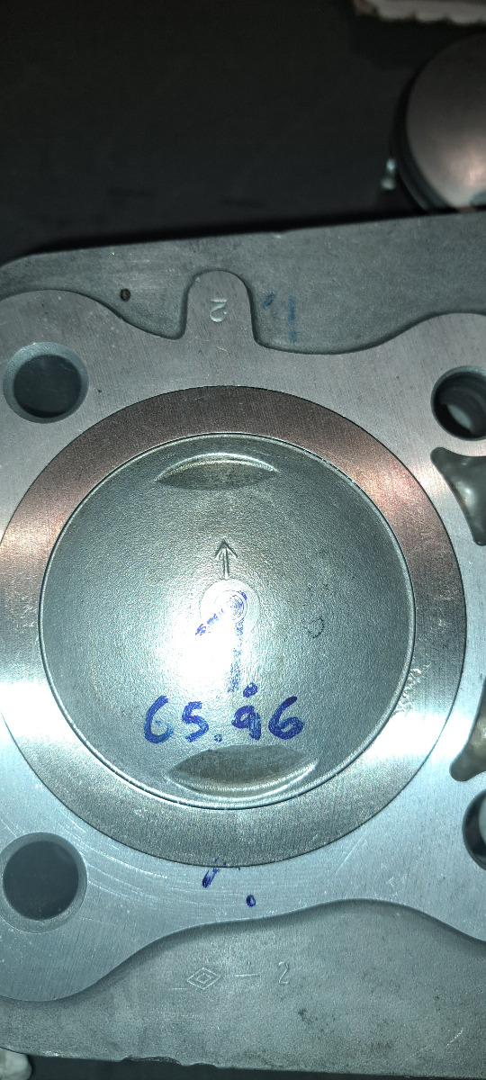

Do you know what piston to cylinder wall clearance was ?
I just put a piston from my kz900 build now into cylinder to compare i post a pick .It has almost no movement ,but it is not connected to the rod so difficult to compare.
I used assembly lube on the skirts last time .
It looks like maybe cylinders washed out running too rich or choke when started. was the rings and bores oiled ?

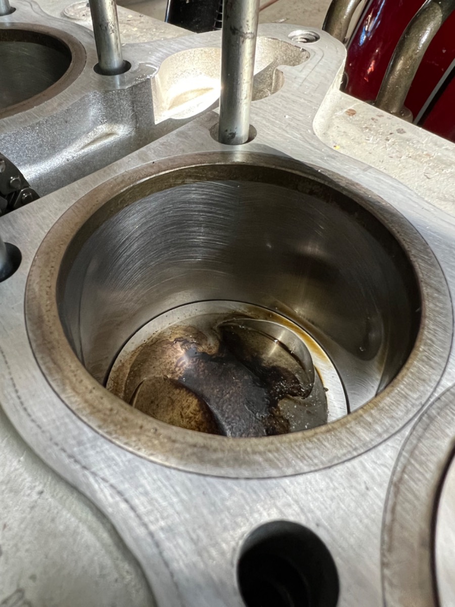

There is several causes. I have built race winning auto engines for many years. There is always some wear on the thrust side of cylinder walls that happens during break in. This can be made worse if not enough plateau on the honing or it just to rough. I can’t tell a lot from your pictures but looks like there is vertical line on both sides of the walls. The lines are below the top travel of the ring stack ending at about the piston belly. So not ring clearance. Looks pretty uniform, so not trash. So we are left with heat , pistons to wall clearance, or lubrication. Doesn’t look like heat, or at least not enough to cause molten metal transfer! Heat does close up wall clearance so that is one thing has to be considered with wall clearance. Piston to wall clearance can be tricky, different piston materials , manufacturing, engine type and use, may need there own clearance. Forged piston expand more with heat than a cast piston,, for example. Lubrication can be lack of or washed down . If you didn’t clean any of the pistons (in your pics)and looking at the walls above the ring pack area, doesn’t look like to much fuel except one cylinder has a little soot on on top of cylinder wall. I am not a kz expert we just played around a lot with them in our dealership and raced them mostly on the street. One thing I discovered on a kz was on a dry engine ,oil takes a long time to get from oil pan to pressure in oil galley(not just turn off light but 2-3lbs on a guage)on first start. So I ended up priming if a rebuild! I always used gm E.O.S on cam and engine bearings and tranny fluid on cylinders and pistons back then! So if oil problem ,,correct and run it! If clearance problem,, hone to correct tolerance and run it! You can lightly sand pistons belly and skirt with 600 wet dry sand paper to knock of any high spots from scuffing ,,if need be! Make sure you always have air moving over the motor when it’s running (fan or riding) specially before it has some miles on it! Guess what I am getting at is looking at your pics , the motor is not f-Ed. Just saw the movie , side clearance and piston rocking doesn’t mean anything. There is no skirt on the side of a piston and some skirt designs can rock more than others.The ring stack has a much smaller diameter than the actual piston size. The piston belly (fattest part of the piston 90 degrees from piston pin )is the critical place to measure for clearance. You can check clearance by sliding a piston (long) feeler gage between piston and wall at the front of motor. This isn’t the most accurate way to measure ,but it’s would be close enough for this application.

Bcot, thanks for the information… regarding your observation about fueling that does bring up a good point. The photos that I posted previously were taken after I had cleaned to take a closer look. There was actually what appeared to be gummed fuel on the pistons that I wiped off. I only took one photo of that, but all cylinders were in roughly the same condition.

Agree with bore brush and hot soapy water. Forget not everyone has a jet washer. Wiping with brake clean will get the big stuff, and to be honest the fine micro grit that gets trapped in the cross hatch is harder on the rings than the pistons.. looks like it was rich and could cause some washing down of the walls. I just wonder why it looks like it has the same marks on the thrust side as the non thrust side. It has a lot of carbon on the piston for that little of running and I can’t really see how bad the wear marks on the cylinders really are. Sometimes the camera makes them look worse than in person .If you can feel those lines I would check piston to wall clearance. Washed cylinders can show some wear on pistons and walls but again usually harder on rings and the cylinders .. Just doesn’t look worn at all above where the piston belly stops. If the lines are just marks (staining) and can’t be felt could just have been carbon falling off top of cylinder and piston and getting between the cylinders and piston creating the appearance of scoring. I have seen that. If it was mine I would pull the cylinders check piston clearance at top and bottom of cylinder(bore gauge feeler gauge doesn’t matter) check piston manufacturer spec, if there after market pistons, not Kawasaki specs. I like at least.002” for a cast piston more for forged. If ok ,,I would run a bead hone through it a couple of times, meaning up and down the cylinders 2 or 3 times, lightly 600 grit the piston skirts if they have any marks you can feel. clean every thing up in hot soapy water really well. Oil everything up with some 20w50 full synthetic just as assembly lube ‘not in the pan. Fix the rich fuel issue. Clean carbs, check floats float level needle and seat choke plunger seal (if this bike has that style of choke, not sure) put it together and run it. That’s all if you can feel the marks in the cylinders. If it’s just marks from carbon, run it. Ok now anti synthetic people! Agreed synthetic oil can hamper some rings from seating. But it resists getting washed of cylinders and the motor has already ran maybe in a harsh ring environment. I don’t use sticky thick assembly lube on cylinders or piston because it traps the metal particles from break in in the cross hatch of the cylinder walls and ring lands.That’s just what I would do. Like I said not a kz expert!!!
