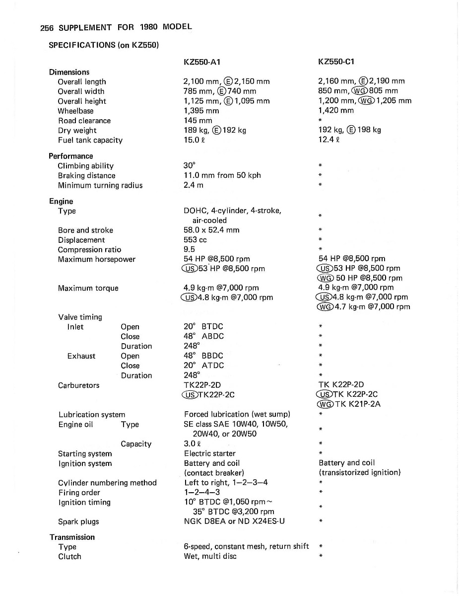

The 400 has 52mm bores and the 550 has 58mm bores - not sure if there would be enough meat in the top crankcase to bore it that far for the bigger liners (how wide is the bridge between cylinders currently ?)

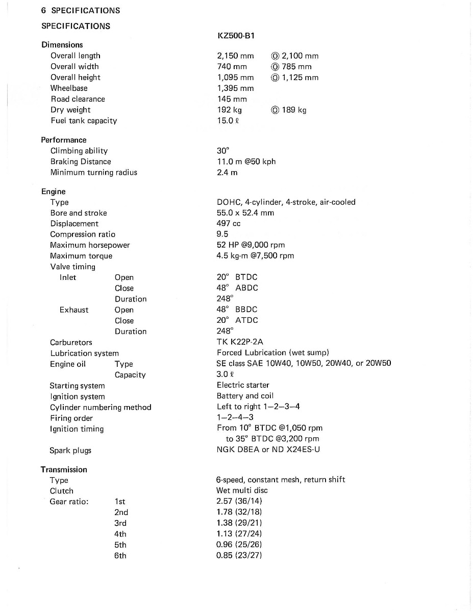

The 400/550 hybrid has been done before to produce a perky 500 motor.
There was a feature on it in either Performance bikes or Superbike mag in the late 80's early 90's and i had a 400J at the time which is why i remember .
I don't recall the finer details of which carbs and cams etc were used but the main mod was either milling the 550 block down to suit the 400's shorter stroke or boring the 400 block to take the 550 liners.
Essentially you get a big bore using factory parts, the 4cyl crank is self balancing so no issues there and the rest of the 400 motor is up to the job.
The 500/550's are just a bored and stroked 400 and the whole engines are physically a straight swap.
