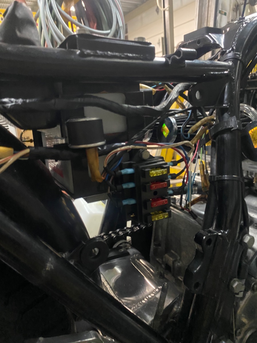

Found one of my problems was melted wiring in the fuse holder. Installed a new fuse holder to solve this. I am trying to find where my red wire from battery transitions to white and red to the fuse, as this is the only connection I cannot see and want to check. Is this buried in the harness?
