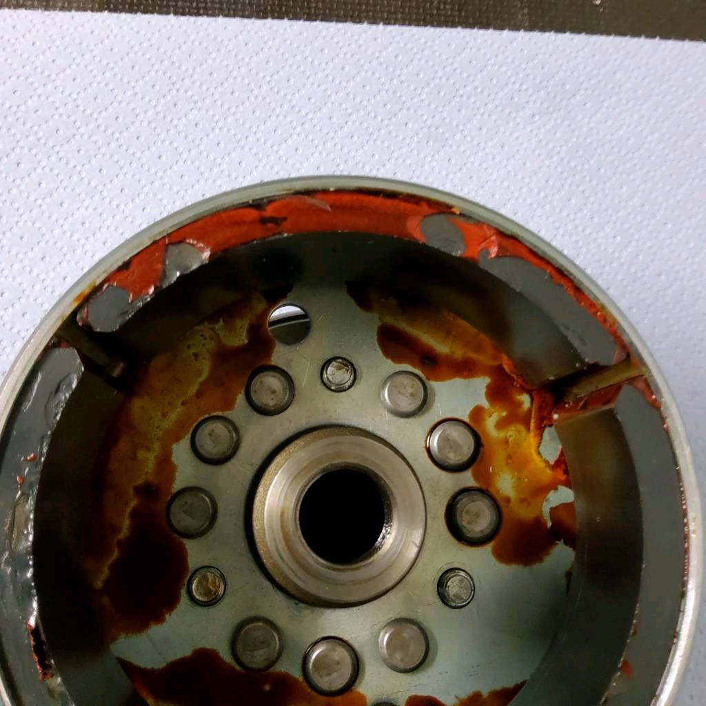

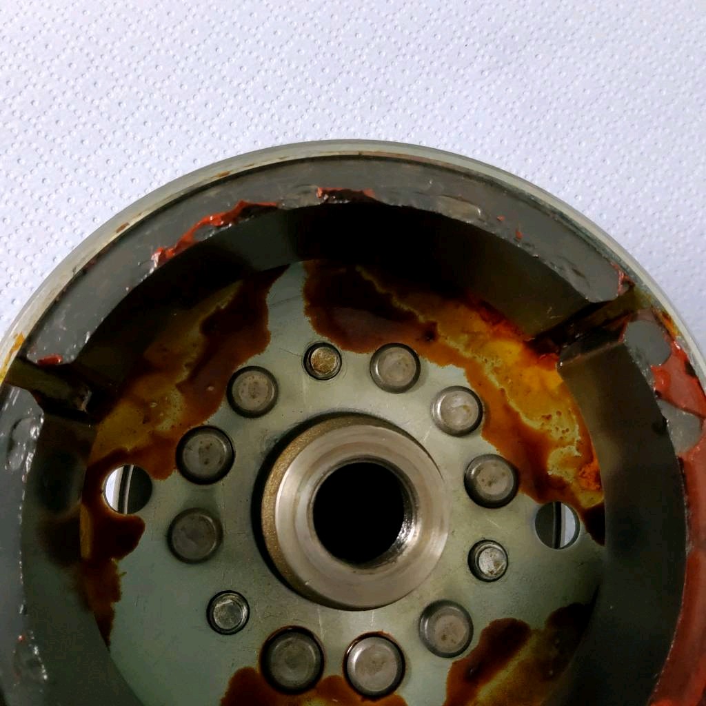

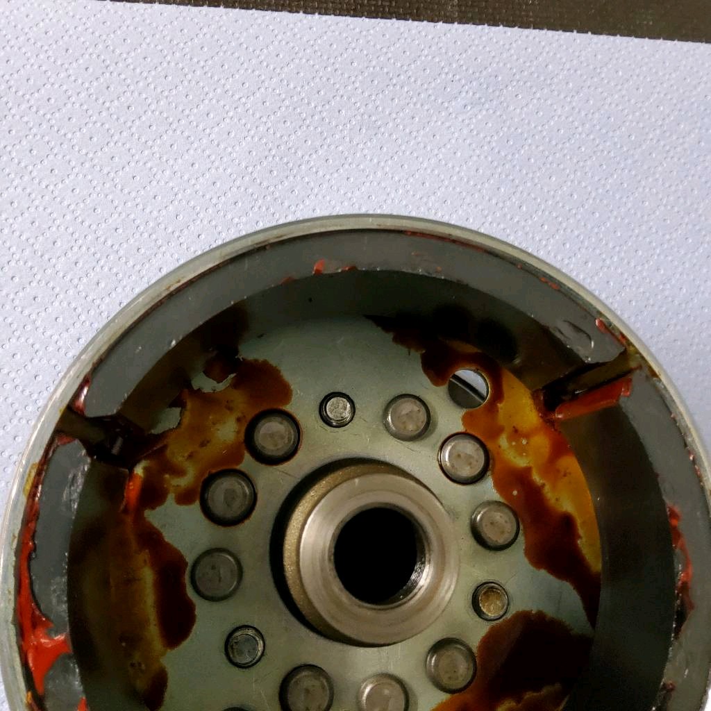

Hello! I have managed to source another rotor, in Germany. Magnets are intact, but there is a slight chipping in the edges.
Do you guys think this is acceptable?
Thank you!
Thank you!
- Posts: 6066
- Thanks: 3802
Re: Piston Hole Kz1000LTD 1982
12 Dec 2024 00:50
Looks like it may of got really hot at some point but (IMHO) as long as the magnets are secure and intact it should do what you need
The following user(s) said Thank You: cartal
