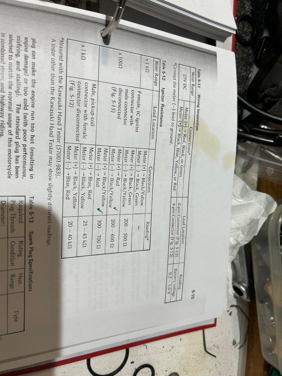

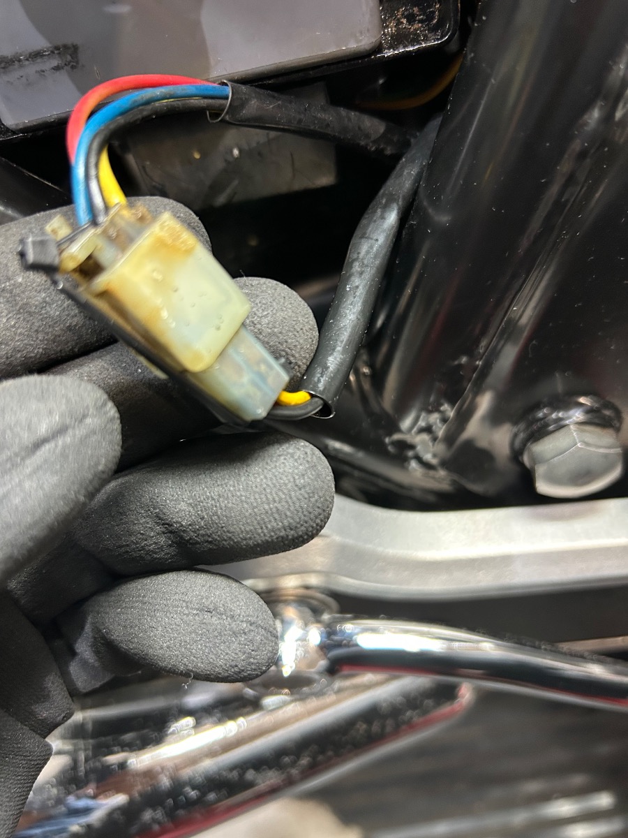

i went through the manual tests for the igniter 4 pin connector and could only reproduce some testing, marked with green checks in the picture. Could not get any results from the male connector, only the female. By the by, the connector is well fried… and happened in the past.

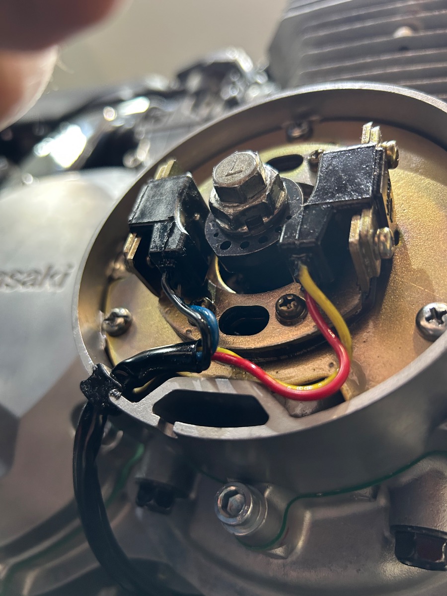

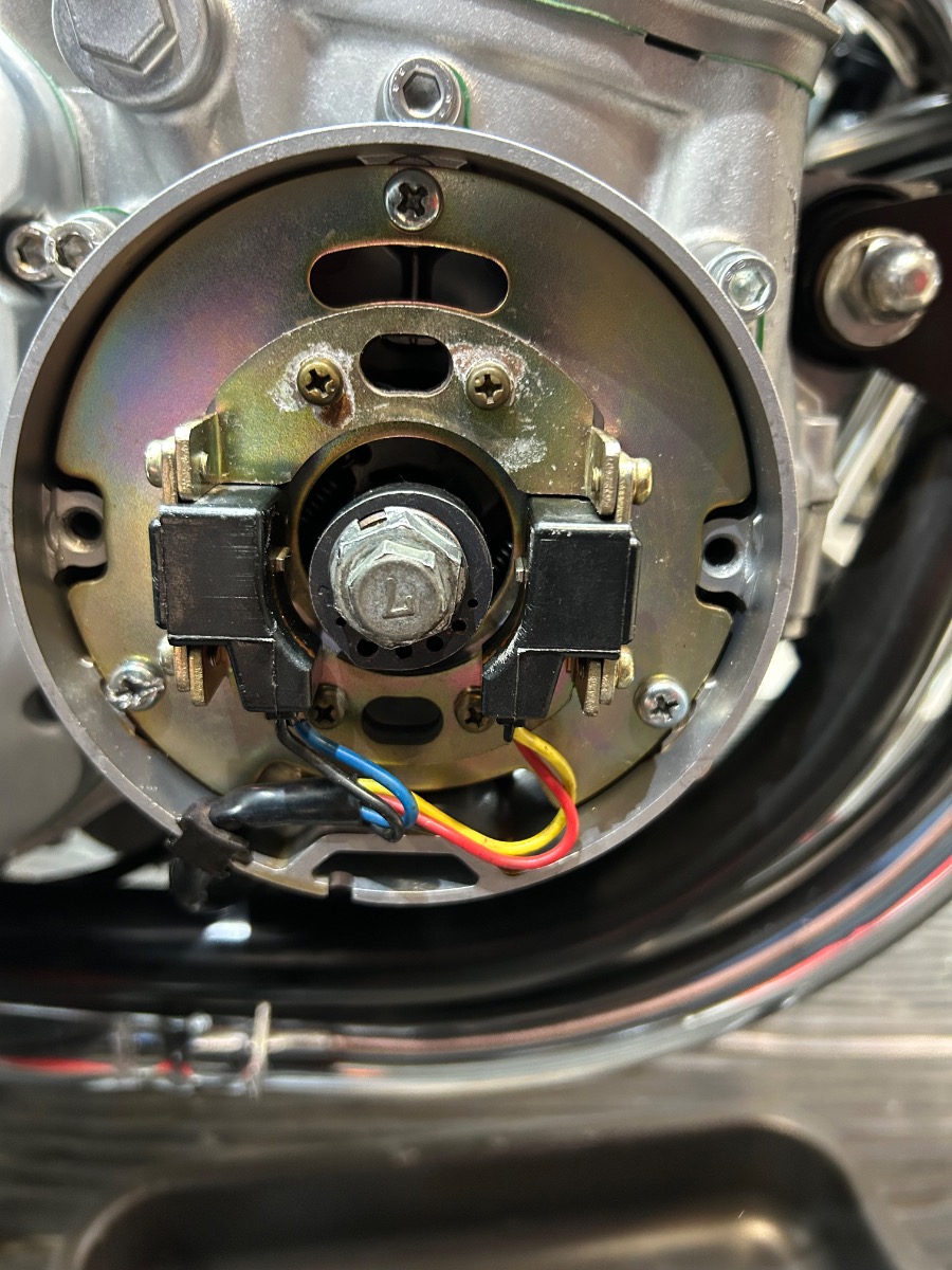

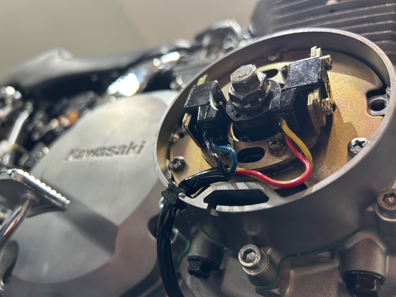

Moved On to the pulse generators, and found that one cable has a large section exposed. When checking this section with ground I don’t get and infinite value (assume 1), but rather 0,0001; which according to the manual is a short. I don’t think the blue cable should have exposed section; but don’t know if it will have any ill effects.
In the past I had a similar problem with some vf1000r pulse generators. Would be fine when testing but would short on a hot environment.
What do you guys think? How difficult are the pulse generators to get?

Looks like a lucky guess on my part
- to be honest the pick-ups will be expensive if available and 40 years old if "used" (my igniter and pick-ups aren't in great condition) my intention was to fit one of the "Chinese" Dyna-S copys for £50 on Ebay which replaces the pick-ups and the igniter (I have now sourced all the parts to convert to GPZ1100 ignition with electronic advance so am going that way)
