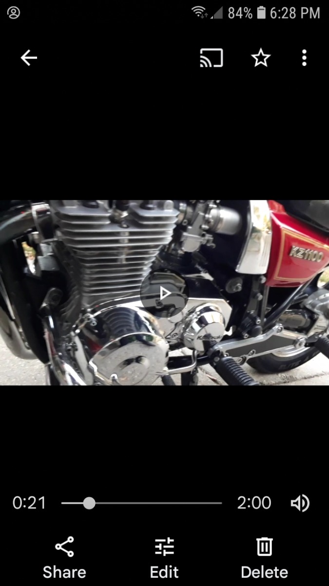

This is a video from last night. Nothing changes, but just added the shiny bits.
Bike started great, no smoke on exhausts, no hanging high rpm. Actually everything looks good.
maybe I’m going paranoid, but when I move to the alternator side of the bike, I seem to hear some kind of rumbling noise. Can you hear it? If so, what could that be?

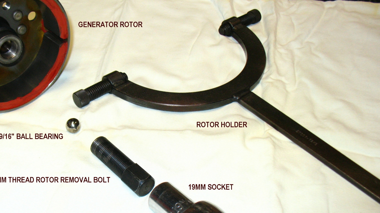

04 Nov 2024 15:25 - 04 Nov 2024 20:44Had a beautiful, brand new rotor spin loose one day after I installed it.
That was one of those days.
Spec is 94 ft-lbs
www.kzrider.com/forum/2-engine/540846-oh-brother#540846

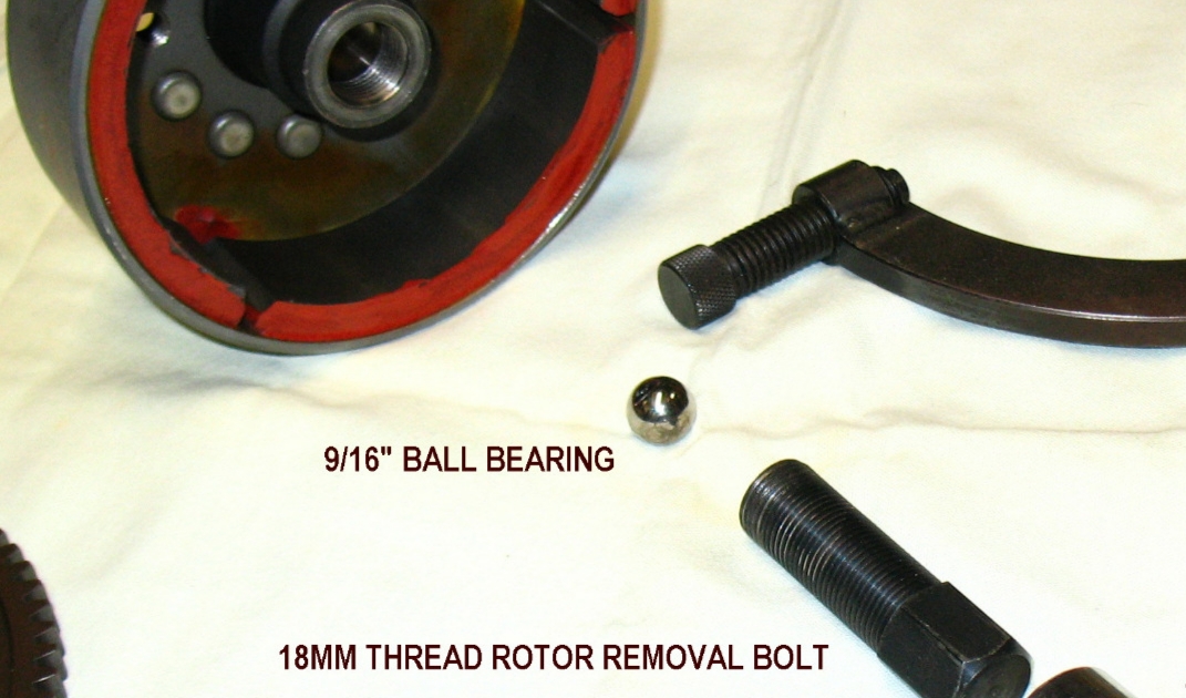

Thank you Daveo. I built a holder tool and have the bolt.
What is the ball bearing used for?

05 Nov 2024 06:39 - 05 Nov 2024 06:42I use a ball bearing to center the tightening pressure of the bolt against the crank hole perimeter vs. the tip.
The ball also engages a recess at the bolt-end, simply made with a center-punch and drill bit at the center.

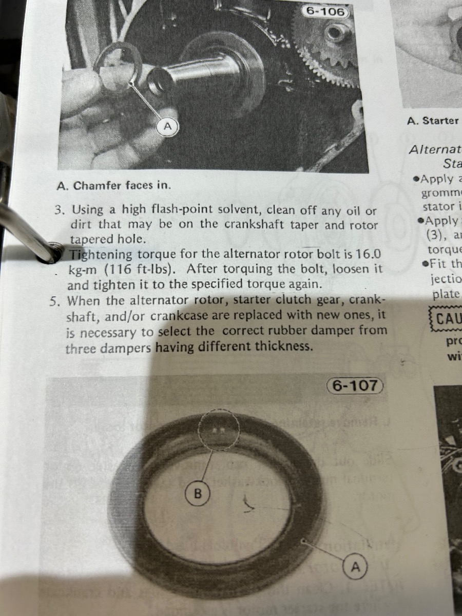

Daveo, I took my alternator cover off and fortunately everything is still intact. I did go up to 94 ft-lb (actually as much as my dinamometric tool will go). Bolt didn’t move, so I guess I did torque it before.
however, looking into the manual, torque value is even higher and the process to follow is torque, remove and torque again.

08 Nov 2024 13:10116 ft lbs is the correct torque for the rotor bolt according to my 81-84 KZ1100 factory service manual.
For some reason the original edition 81-82 KZ1100 factory service manual shows 94 ft lbs...posted earlier. Huh. 🧐

Bike ran like a champ for 10 minutes, and suddenly started missing, like going on two cylinders and also the rev counter was dead. When two cylinders were out, there was the knocking noise again. I think there is an electrical problem here.
I have also lost the horn in the process; so I believe it has something to do with the left handlebar switch.
Also, coils look original, although cables are
new. I may try new coils as well.
Please take a look at the video. This is taken after it had died on me suddenly, and restarted just on two.

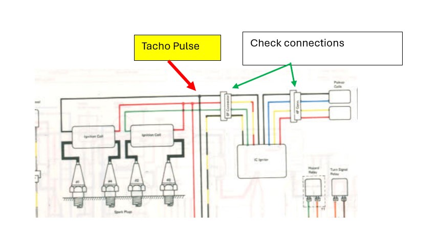

10 Nov 2024 10:39Hi Carlos, the tacho gets it's pulse from one of the coil trigger wires (black) I would start by checking the connectors on the two plugs for the "igniter". the pulse is taken between the igniter and the coil so I would only expect a coil to knock out the tacho if it is going to ground when hot (you could swop the coils over and try it again as if it's the coil it won't knock out the tacho when swopped and triggered by the green wire)Bike ran like a champ for 10 minutes, and suddenly started missing, like going on two cylinders and also the rev counter was dead. When two cylinders were out, there was the knocking noise again. I think there is an electrical problem here.
The horn is a separate issue as there is no link to the tacho circuit
