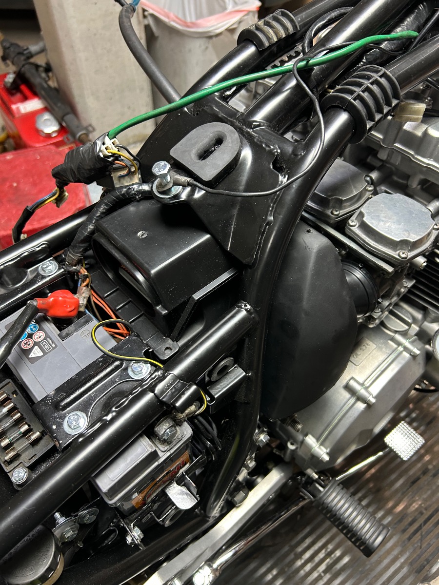

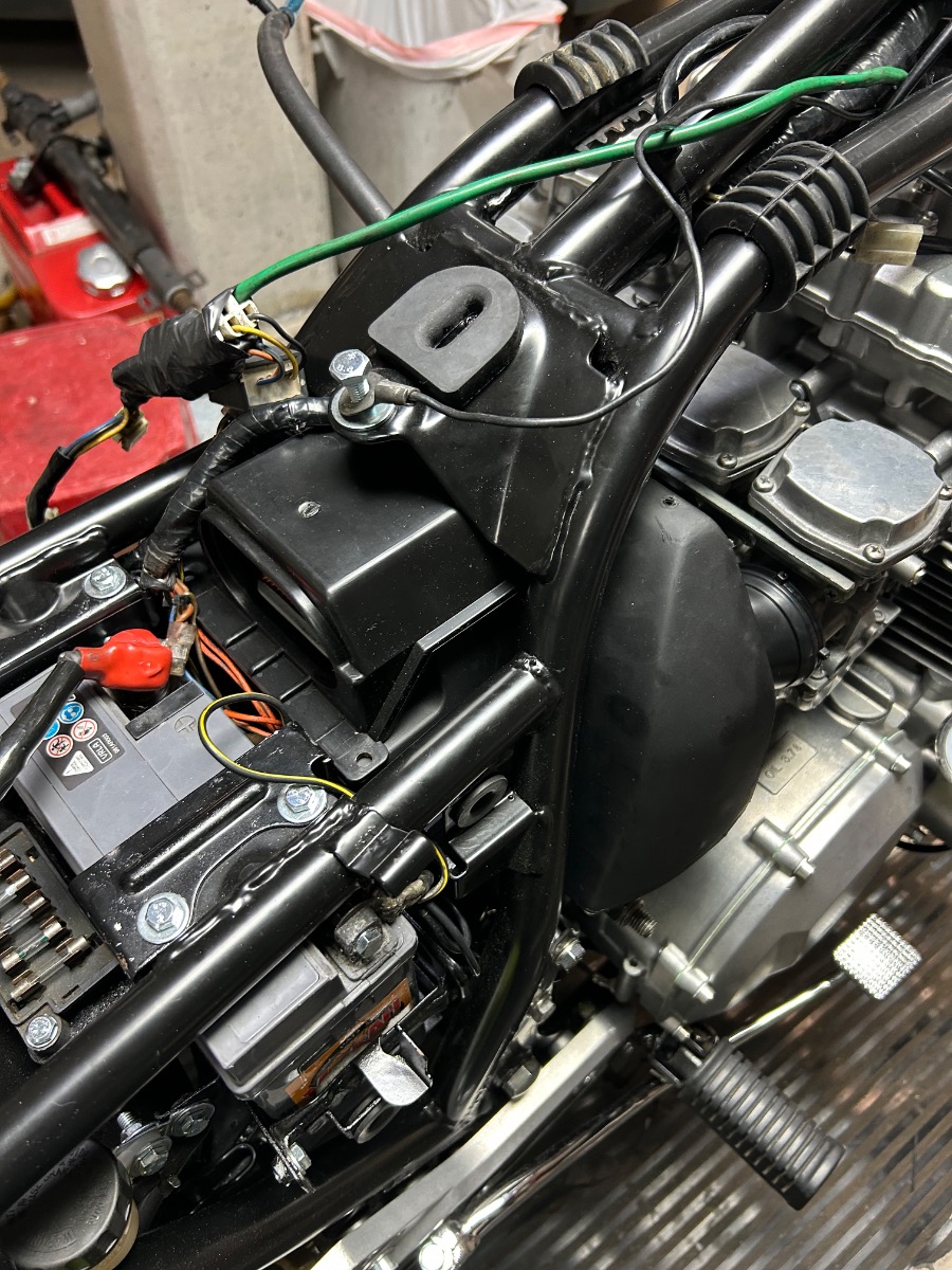

On a final note... I am having a difficult time getting the airbox in, as the electric cables are on the way. The main loom cables coming from the front are thick...
Will keep juggling them until everything fits.

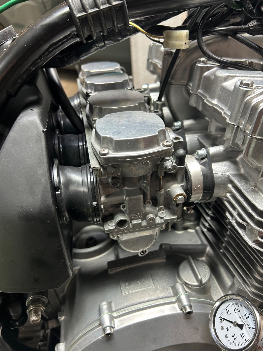

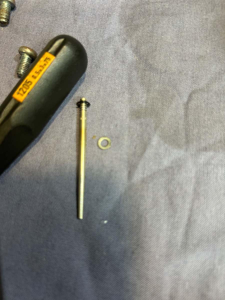

Ok. Jim’s carbs finally arrived! It’s taken a while but well worth the wait.
I have disassembled them to clean them with ultrasound and everything in spotless now.

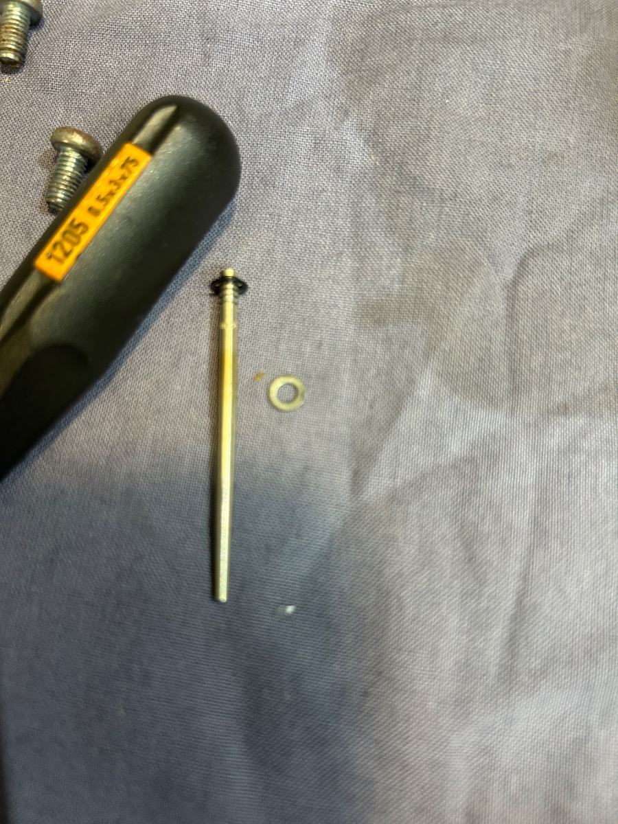

However, I’m a bit puzzled, as for each of the carbs I have a really tiny and thin washer that cannot find where it came out. Actually, I don’t remember getting it off anywhere, but it got loose with the cleaning. It’s really small, and cannot see it in the manual either. Here’s a couple of pics for reference. I’m adding an ebay kit pic, as I can’t get a really good pic.
Any ideas where this may go?

The needle in the pic is just for a size reference

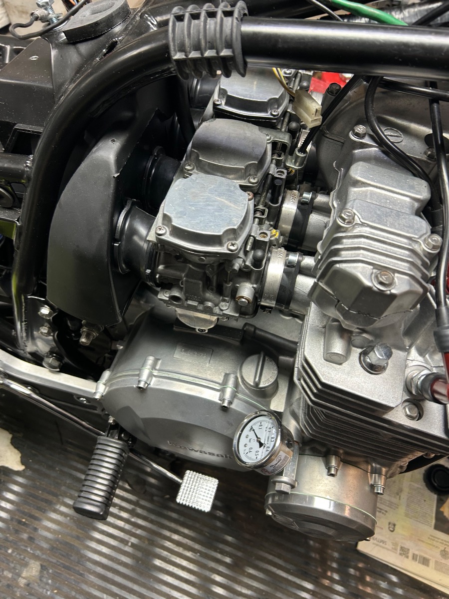

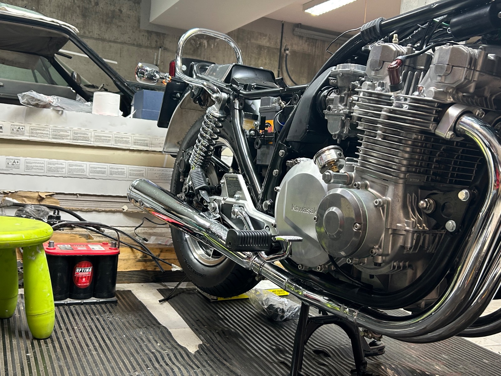

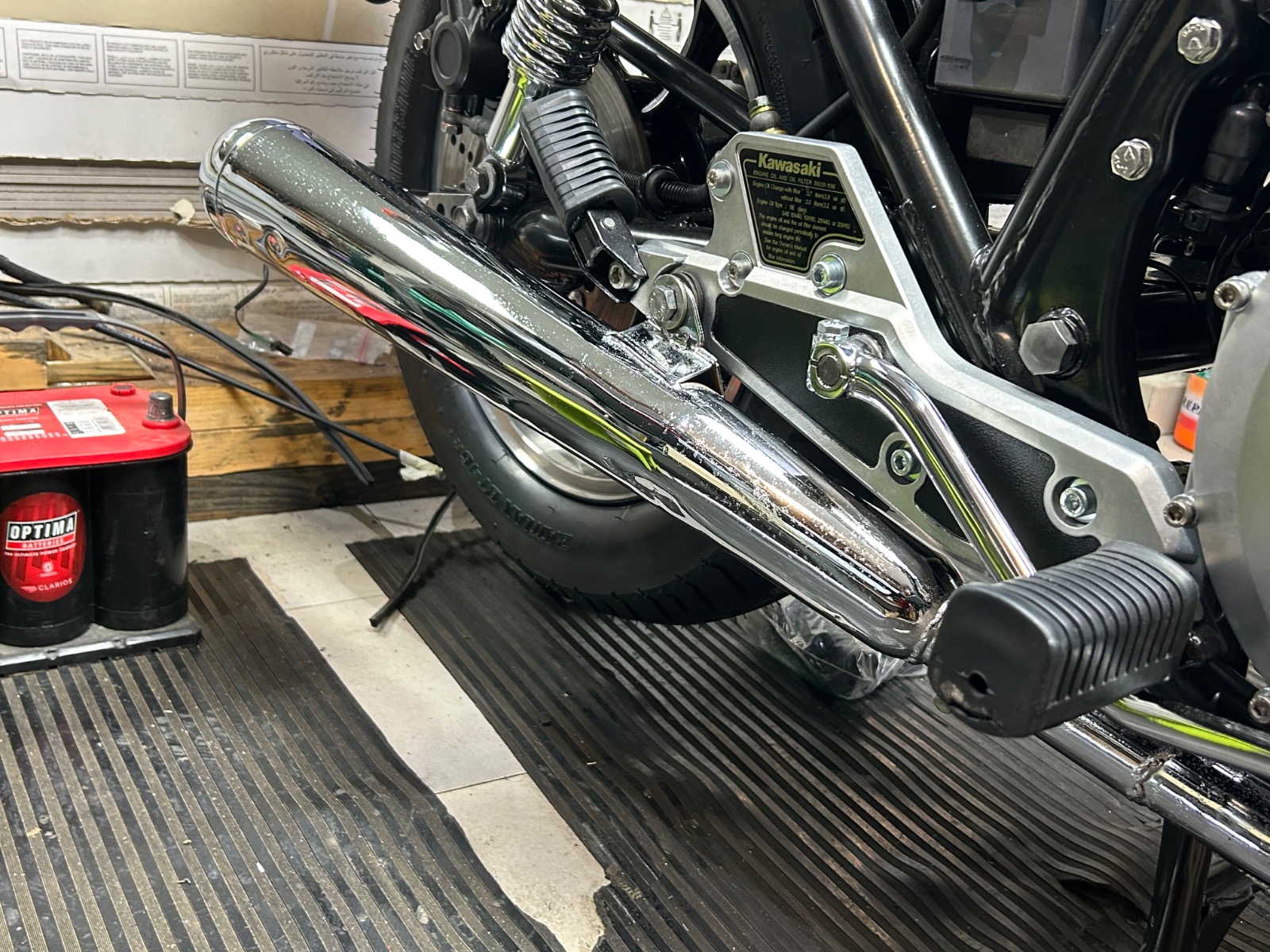

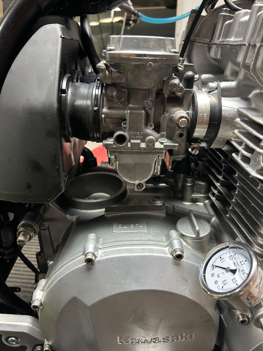

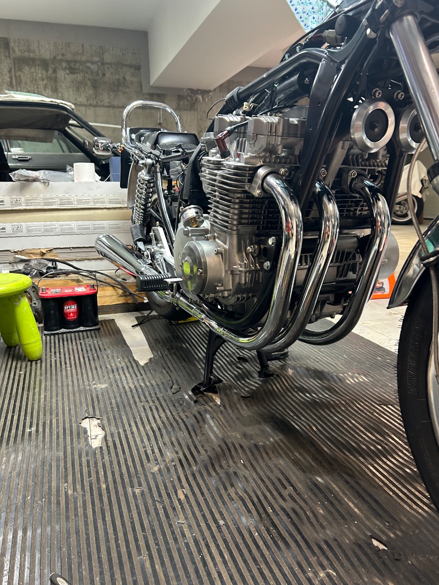

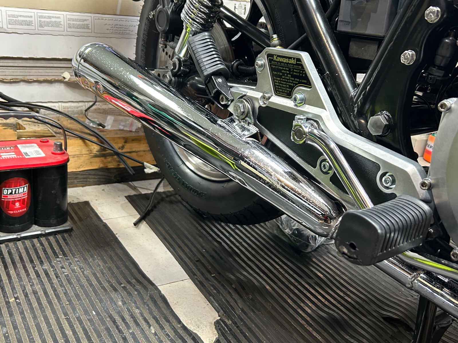

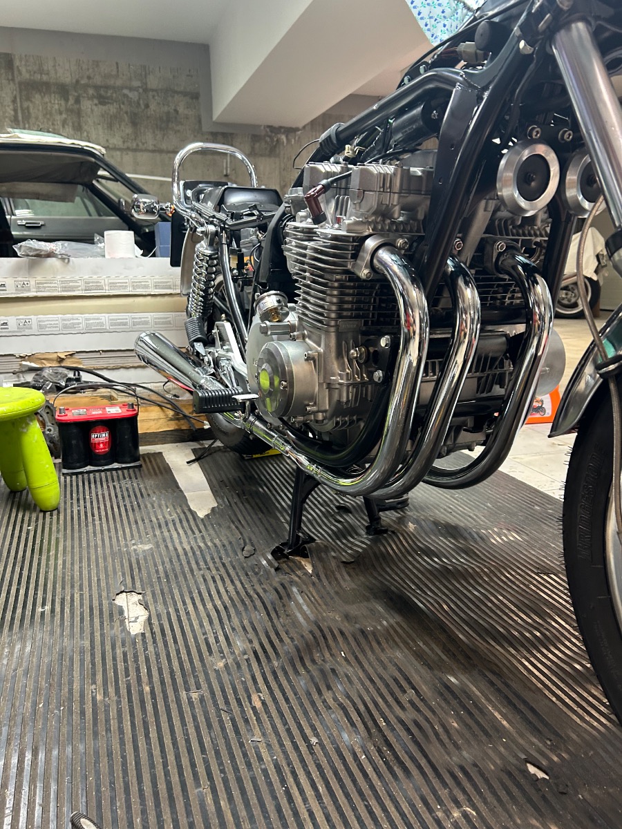

Well… this is pretty big news for me. Today, after 20 years and 2 into the rebuild, the kz has started!
I feel thrilled and enthusiastic about it. I know there’s a lot of work to be done, but it’s a big step for me.
Here’s a video of the moment, and some pictures of how it’s going.
thank you all. This would have not happened without your help, and Jim’s carbs!

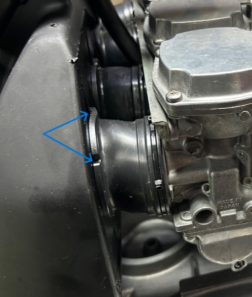

Great to see you at this stage Carlos, one thing I would point out is that your airbox rubbers need to rotate slightly. The "cut out" should engage with the raised part on the airbox and this ensures the flat part between 1 & 2 and 3 & 4 are aligned and that the rubber engages with the carb correctly
The following user(s) said Thank You: cartal

Thank you wookie! I am totally over the top. Having a working engine, with good oil pressure on the first try is a very satisfactory situation.
I am installing the exhausts now, which will allow me to test the engine without waking up next door neighbors, two streets away.
Yes. I understood the little "dimple" in the intakes was to be aligned with the line in the air box, but my airbox is a bit skewed to the side, and I had to turn a couple of them a bit, so the funnels would fit right.
Overall was not too bad to get the carbs in; but it all boils down to having new intake rubbers, which are exptremely pliable. Had it not been the case, it would have been a nightmare.
Despite what I just said, I´ll try to turn them and see if I can get them straight.
Cheers!

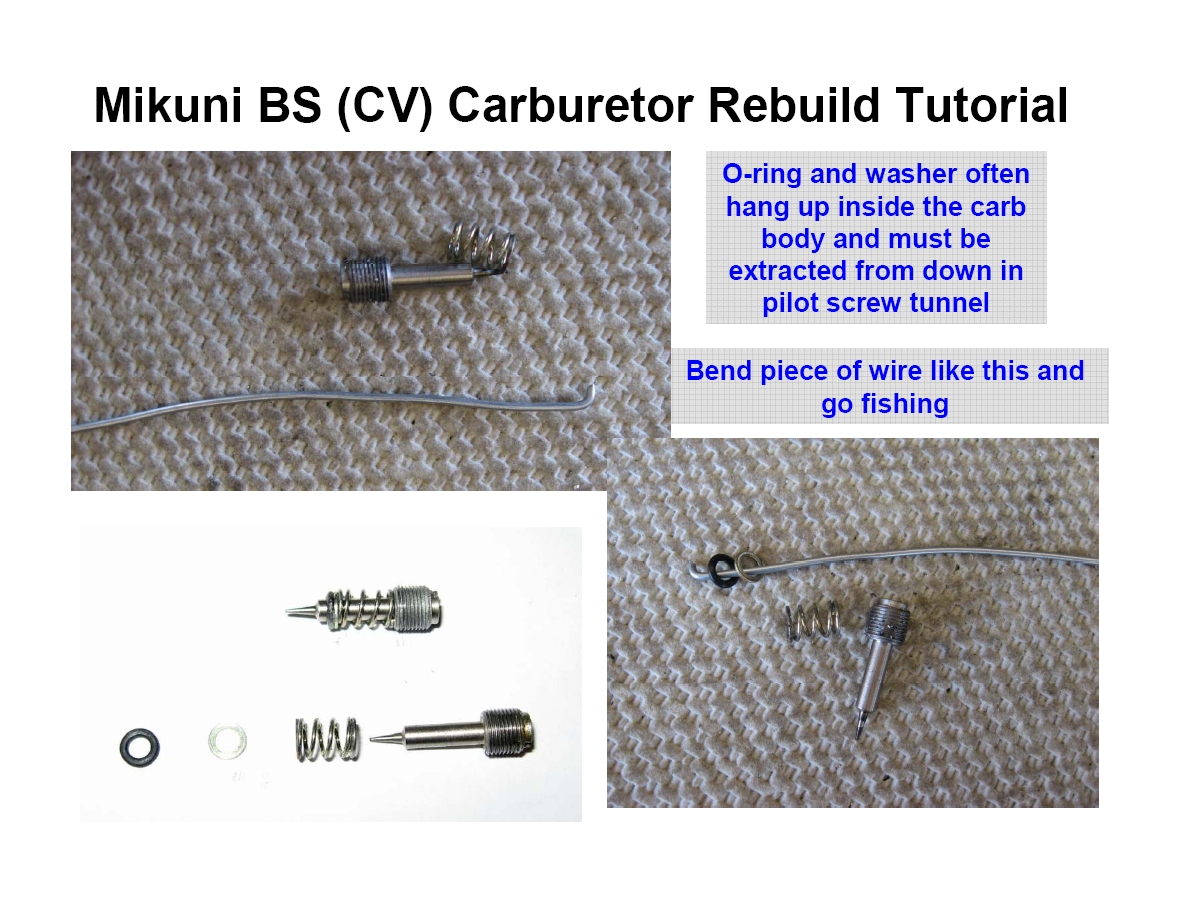

The tiny washer belongs to the adjustable pilot air screw!
pilot air screw----> spring --> washer --> o-ring, put it on exactly in this order.....

I did try that, as I remembered from my kz carbs, but the washer did not fit in there and the needle is totally different.
